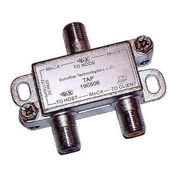

you could get a couple taps and configure those coming of the host ports off the node, then you could add joeys to the client ports
dont know if it would work or not with a duo node.
I run taps off the solo nodes for single hopper setups all the time if a customer has just one line going into the home and have all the cable runs ran to a splitter in an attic or crawl space or something.
