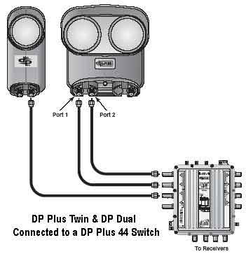

You probably don't have a switch, the DPP Twin lnb has a built-in switch.Take a look at the diagram below:
Great, that is perfect thanks! Much clearer now.

yep, because of the 61.5 dish, you will need to install the switch at the dish, or since you have to run a third wire anyway, you could run a third wire from the dishes down to the basement, put in switch, then go off to the rooms.
