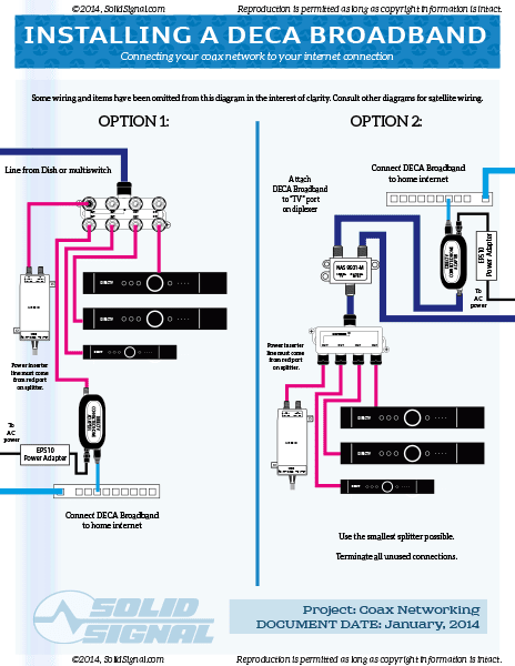

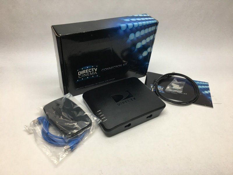

She gets it and when she gets to the lake next, they hook it up ... she sends me pictures and says, Not working ... What I see is that small football type set up with the green sticker (think its a sticker) anyway, I believe its a Deca device (I generally don't deal with this side of the game other than the wireless with the Genies) ...
this device basically goes before the recvr in and out and back into the recvr, with an ethernet connection on it as well ... I'm presuming that connection is to go to the router ... which we can't get to because its in the other room ... so .... from what I can tell, they sent her the Non Wireless version ... is that correct ?
Do I have her call D* again and try to get the WIRELESS version or are there other options ?
Sounds like they sent a wired deca which is built in to the hr24 and not the wireless, they need a wireless for that to work unless there is a cable tied to the system by the router and that would be where what they sent would go.

s-l1600.jpg 71k0LRF-I5L._AC_UL160_SR160,160_.jpg they would need pic1 and not pic 2
