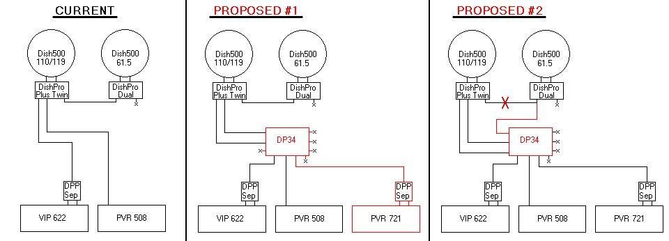

OK, for some extra background, seemy old thread here.
I've got a 622/508 hooked up to the 500 dish w/ DPP Twin (110/119) being fed by a 500 dish w/ DP Dual (61.5) and want to add our old 721 back in.
See the attached JPG for my current set up, and two proposed (if they're correct), or suggest otherwise....

Proposal #1 won't work at all. When you add an external switch, the DPP Twin's LNB input must be bypassed with the 61.5 LNB feeding input 3 on the switch.
That problem is fixed in Proposal #2, but both have another fatal problem. Connecting dual-tuner receivers with just one input line requires 3 DishPro Plus elements: the dual-tuner receiver, the DPP Separator, and a DPP switch. The DP34 (note the one "P") is regular DishPro. So...
Proposal #3: add a DPP44 switch in place of the DP34 shown in #2.
Proposal #4: replace the 110/119 Dish 500 with a Dish 1000.2 (I've read posts saying it's cheaper than a DPP44). No external switch needed, sort of a 3-LNB version of the DPP Twin.
Proposal #5: Put up a separate Dish 500 (any LNB config) for the 508, connect the 721 to the DPP Twin.
Excellent info, BobaBird! Thank you very much!
Looks like #3 is the only option for me.
#4 - My Philly locals come off 61.5 bird as I understand, and the wife probably won't like the larger dish up there.
#5 - With the 110/119 dish, and the 61.5 wing, the wife REALLY won't like a third dish! :)
Maybe option #6??
Put two DP34's in and pull two drops to the 622/721 and one drop to the 508?

DPP44 switch is the best way to go.
Here is another proposal, a 1000.2 dish. You can feed 3 receivers (dual tuners) with a single cable run with the 1000.2. You feed the 1000.2 with a cable run from 61.5 and cover the eye for 129 with aluminun foil. Run check switch and you'll have the 3 satellites you currently have and feed the 3 receivers with single cable runs.

Thanks Randall. Hmmm... #4 needs more thought. (Didn't know I could feed the 61.5 into it.)
If I left off the foil, would I "see" all four birds? (61.5/110/119/129) Is there any programming on 129 that I'm not already getting on the other three?
You can leave off the foil and will see the 4 birds but the HD programming on 129 is the same as 61.5 except for some HD locals. I don't think you'll see 129 in Philadelphia though, I'm looking at the footprint and looks like Philly is not covered.
Option #6 is also worth considering. Conflicting literature from Dish says the DP34 either can or can't be used with the DPP Twin, so you might also need to get a regular DP Twin.
