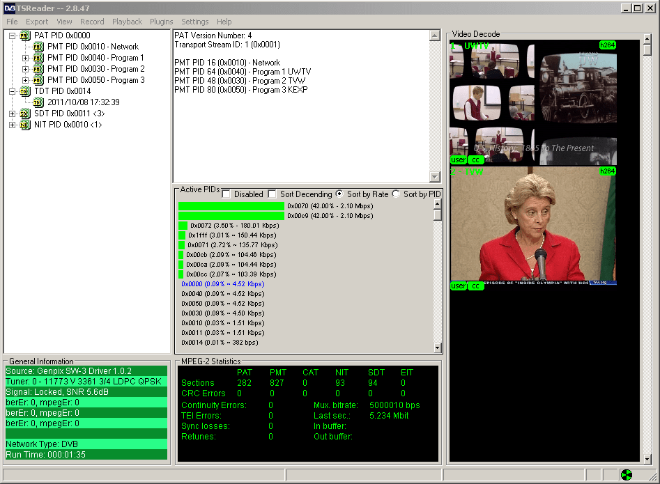

I have very weak signal from 123 sat on my 36" disn.
For instance, I get only 5.7dB (SNR) from 11773 V 3361 (DVB-S2 QPSK 3/4)
I can not lock 11840 V 1784.
I don't know the reason, but it could be just because it's too weak.
and yes, it's slow locking (on slow SR).

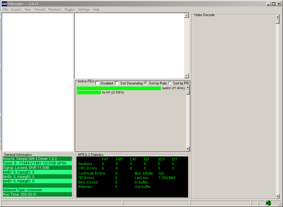

It takes about 6 seconds (from hitting "Tune" button) until TSreader finally locks the signal on 11944 V 1481 (DVB-s QPSK)
And it does not matter whether I select FEC = "Auto" or "1/2" (the same 6 seconds).
