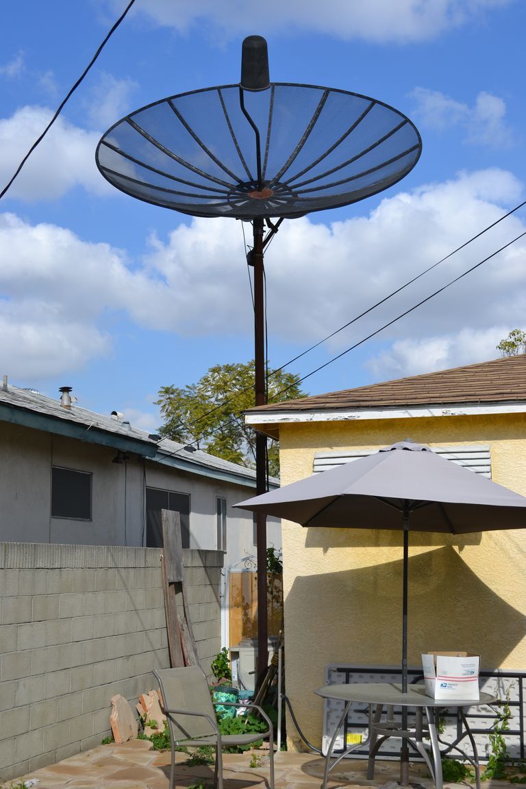

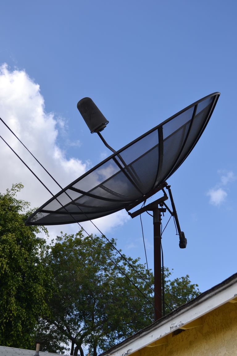

I was considering buying this bud for $60. The owner says it's 10ft but I can't really tell. I was looking for a 6ft because I thought it would be easier to manage and I wanted to mount it on top of my flat patio roof. This one would have to be mounted at my place just like it is in the picture. Can anyone give me advice on how to take this one down? Do you think I could partially sawzall the mast at ground level then bend it down using a rope? I can't see how I would be able to get to it safely standing on the roof. How much do you think it weighs? Looks like it can be moved with a motor but I'm not sure. Is it worth taking? I am new to FTA and wanted to check out C-band. This is my first post here. Any advice would be appreciated.

You won't regret having a 10' dish. As for this one, I wouldn't be eager to pay anything for it, and frankly would look for something more down to earth and not a button hook. But if it's your only option...
That looks to be a handful to take down. Would appear that the only way to get that down is a man-lift. And that requires room to maneuver it beside the base. Of which, it looks like little is available. And a couple of strong people to man handle it off the pole. I ditto toucan-man's assessment.
Very true...you can only drop it ONCE..
Yeah, they are right. I once took an 8-footer down, but its distance to the roof was much closer, so I was able to take it off the mast just from standing on the roof. Then I sawed the mast off.
You can rent a crane by the hr and probably spend $125 on that to lift it off the mast and directly into whatever your going to use to get it home. Tell the seller you will have to pay more than the $60 just to get it down, but then he knows that.... and w/o access to the bolts at the back of the dish from the roof, you still have to have a mechanical man lift...
I'd tell the guy I'd give him $160, when he places it on my truck!
Pole included, cut off at ground level.
Nice dish, but the buildings and power lines seem way too close, from your pictures.
Frankly, I wouldn't touch it if he paid me $160 ! - :cool:
i would take a buddy and some tools and unasseble it ...take your time and number the parts ...and make a few hours of it...cause you want to take care of it and be safe
Thanks for all the responses. Sounds like I should skip this one and keep looking. I had no idea the button hook design was less desirable. Ironically I just contacted another guy on craigslist who has a 10' mesh dish and his is also on a 20ft mast. Haven't got a picture yet.

two, maybe three guys with ropes can get that down, asssuming the owner wants to get rid of the pole too. Those rooves are close and are low pitched. one guy on each with a lengths of rope tied just below the dish. A guy at the bottom with a circular saw with a metal cutting blade in it.
The guys up top lift as the guy cuts the pole near the ground. When it comes free, the guy who had the saw directs the bottom end and the two guys on the rooves slowly lower the whole thing down.
