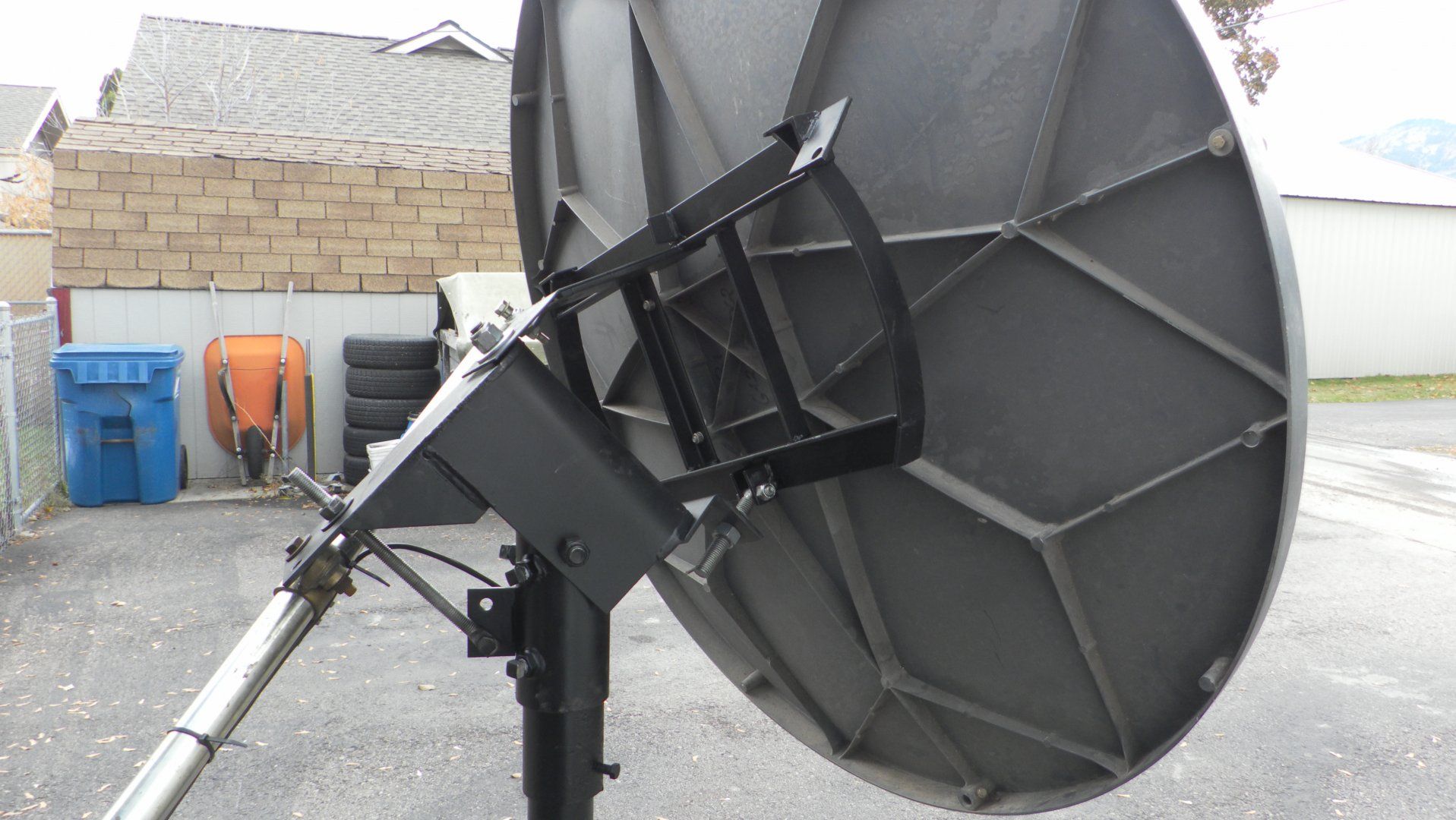

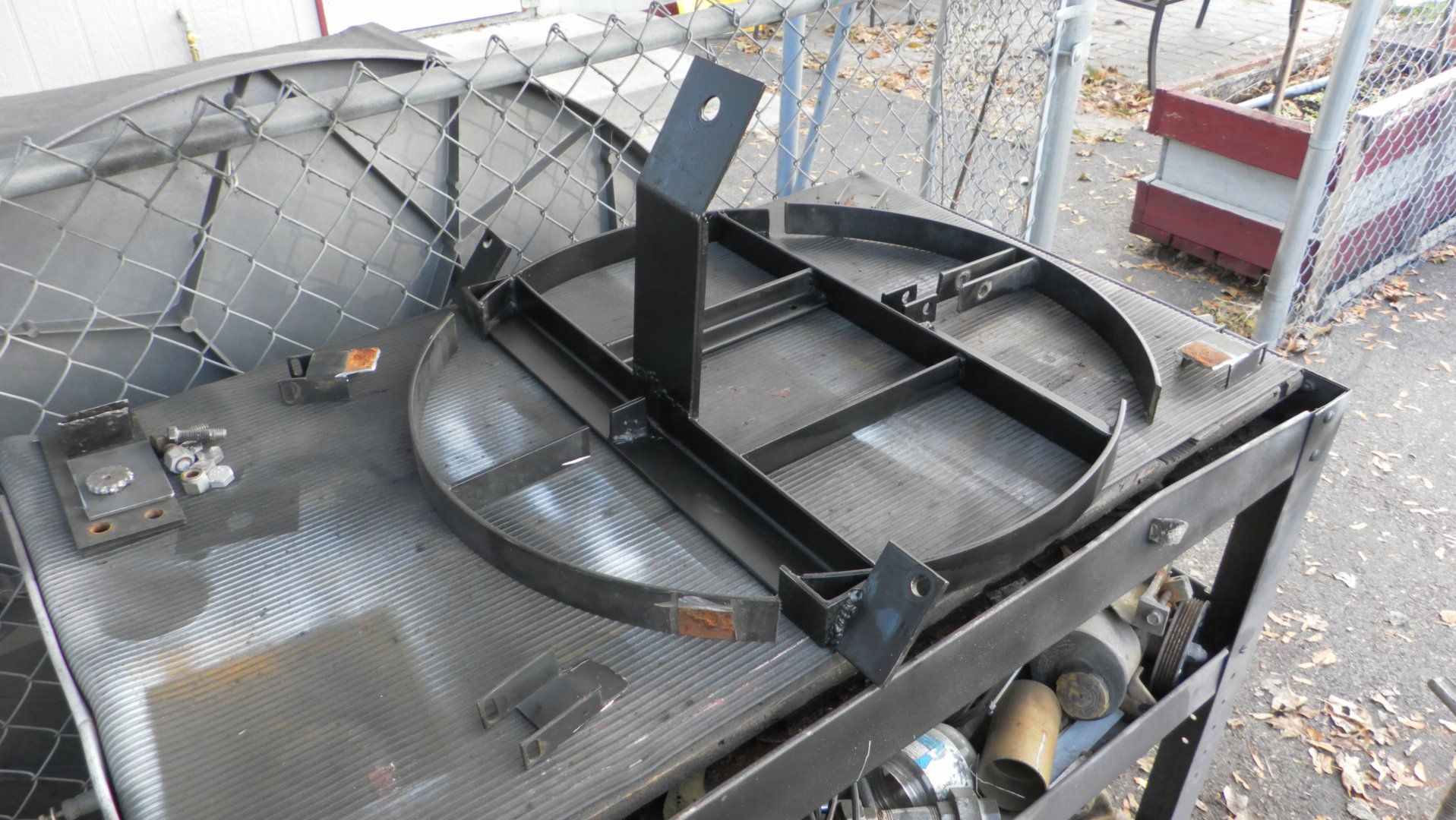

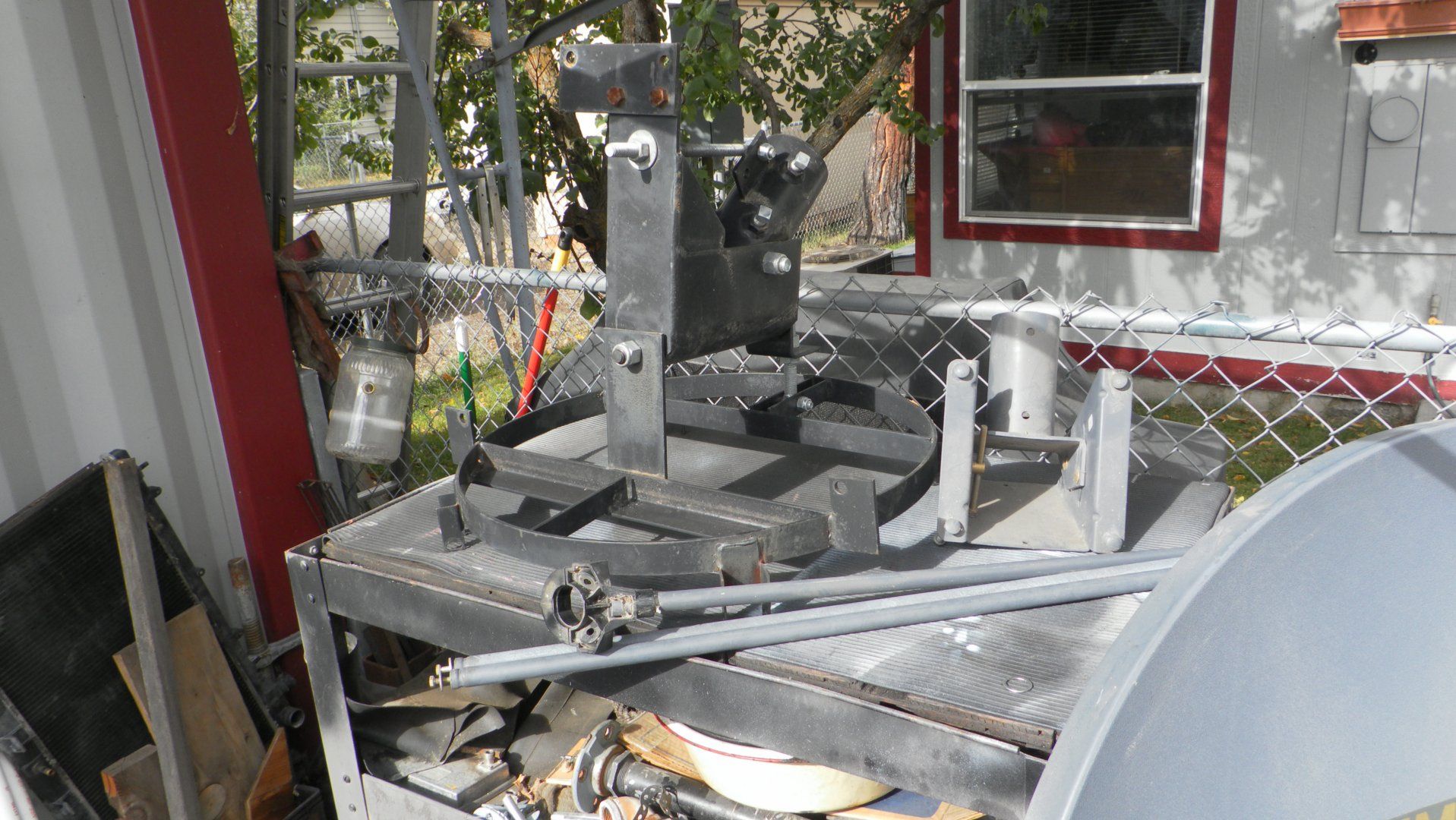

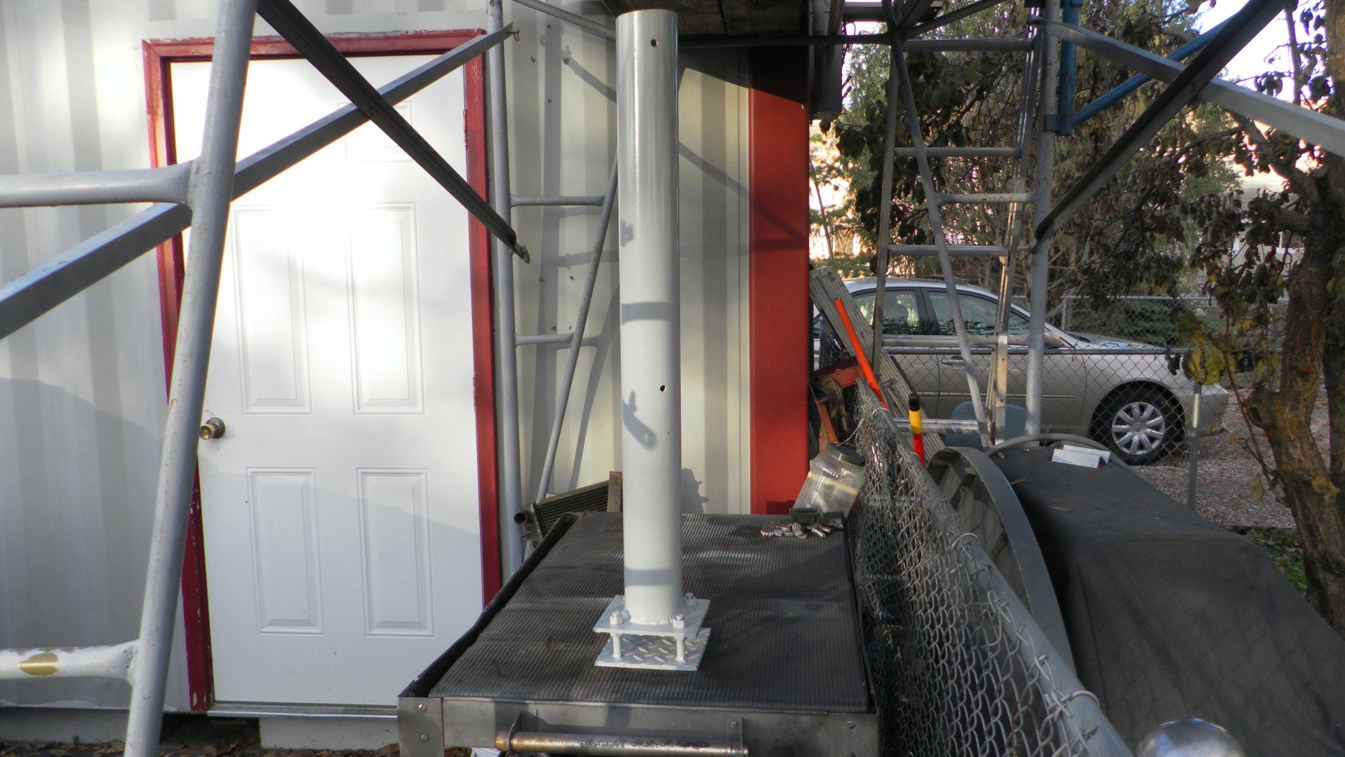

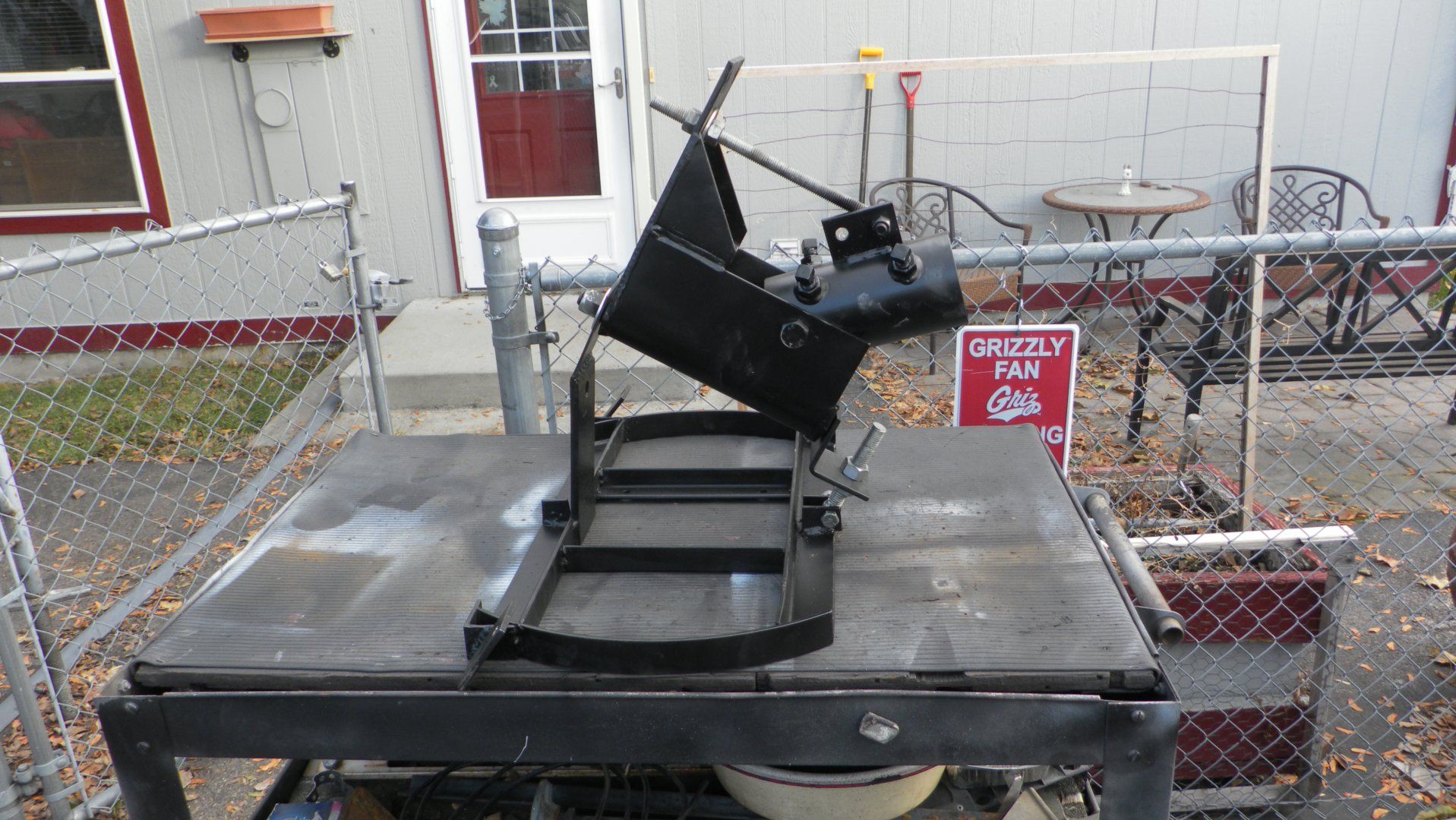

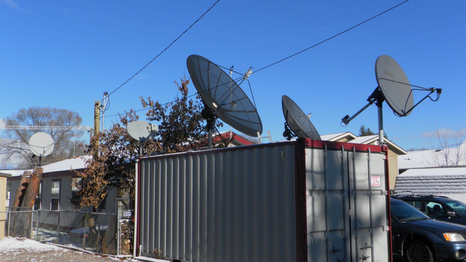

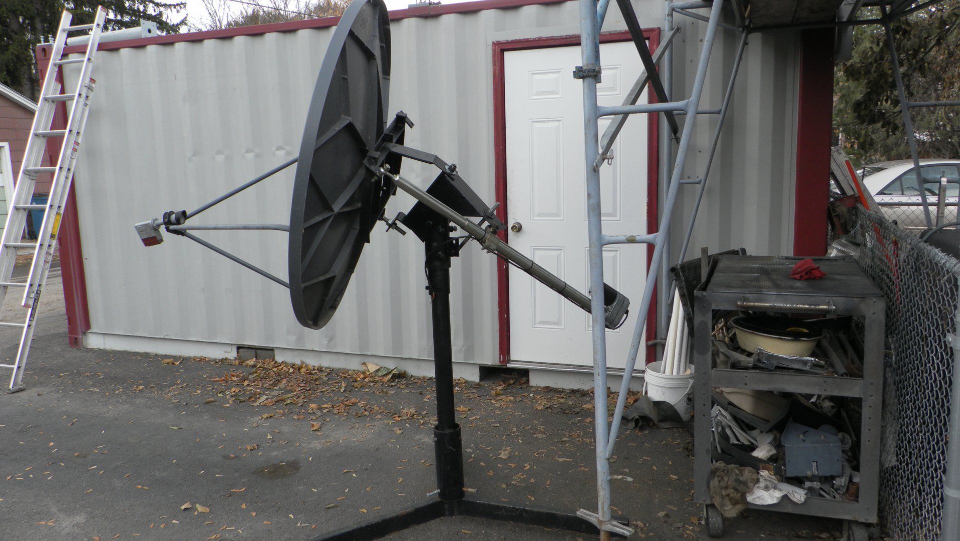

Like a 10' C-Band dish is recommended, a 1.2m (4') Ku dish is recommended. The best dish is the homemade kind. ;)
I built one with an old Primestar 1.2m and a modified C-Band dish mount a few years ago and another one two weeks ago.
The dish farm grows another one ;)
Very nice pics!
Thing is I am only wanting to use one cable to run and tie into the cable box outside of the home, I cant use an actuator since it would be another set of wires.
I had a similar issue. I did not want to run a motor control cable that far so the VBox is inside the shed under the dish with a short cable.
