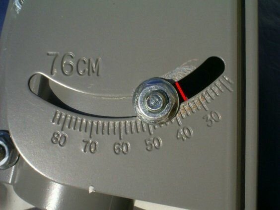

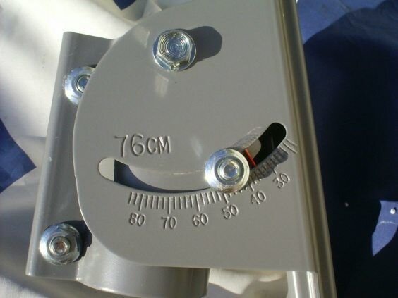

Make SURE you use the RED mark on the Winegard dish to set the elevation!
Very interesting.. I don't think I noticed the red mark on my dish, and the 1 page of documentation it came with I don't think mentioned it. I was trying to center the reading on the bolt instead. The gauge in that pic looks to be stamped in the same position as mine also, so it probably isn't off as I thought, which is good news.
I think I'll still have some trouble though, since I overtightened the motor bolts and bent the pole 1/4" out of shape!! Gahh.. So I will try and rotate the motor 90 degrees and tighten till the pole is back in shape, but after painstakingly making sure the pole was plumb it it is kind of annoying to have to deal with it being bent out of shape. I also bent the pole with the motor at the wrong position, because forgot to take into account magnetic deviation when pointing south, so it is bent at an awkward spot. Ahh well, live and learn. I just hope it won't throw off my tracking too much. Thanks for the help, I'll post an update later.
