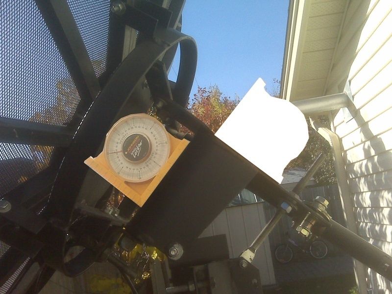

Here is the dish, the spot I have the inclinometer at is where I'm setting the 48 latitude. You can see the declination adjustment at the bottom. Where do I apply this 7 degrees declination?
Declination is the difference between your mount and the actual dish. Elevation is where you have the angle gauge now. to set declination you put the angle gauge on the back plate of the dish. The difference of the two is your declination. So your dish should be 7 degrees lower than where your elevation is.
What I do is measure the angle where your gauge is in the pic. Write that down. Then put the gauge on the back plate of the dish. Write that down. Subtract the two, thats your declination. Adjust it until its 7 degrees lower than your elevation.

I have the same problem setting the Declination, no good place to measure, so I don't.
From your Pic, I looks like you have Way too Much Declination, but that could be the Pic.
Set your Main Axis Elevation just like your Photo, using the adjustment closest to your Angle Finder. Then set the Declination to Peak Signal, that the Adjustment tucked underneath. Your Declination Adjustment looks to be maxed out, so I would start by getting that in the middle. As a guide, stick your Angle Finder to the back of the Dish, on the Center Plate.

Lak7, I took that pic before I set the declination, so yes it would have been excessive.
When my main elev is set properly, I do find signal after adjusting the declination bolt, but where I do find it, equates to 13 declination when it should be 7. Leaving it like this gets me great signal at my true south 89 and up to 99 but then nothing further west at all, so I make the assumption this is wrong.

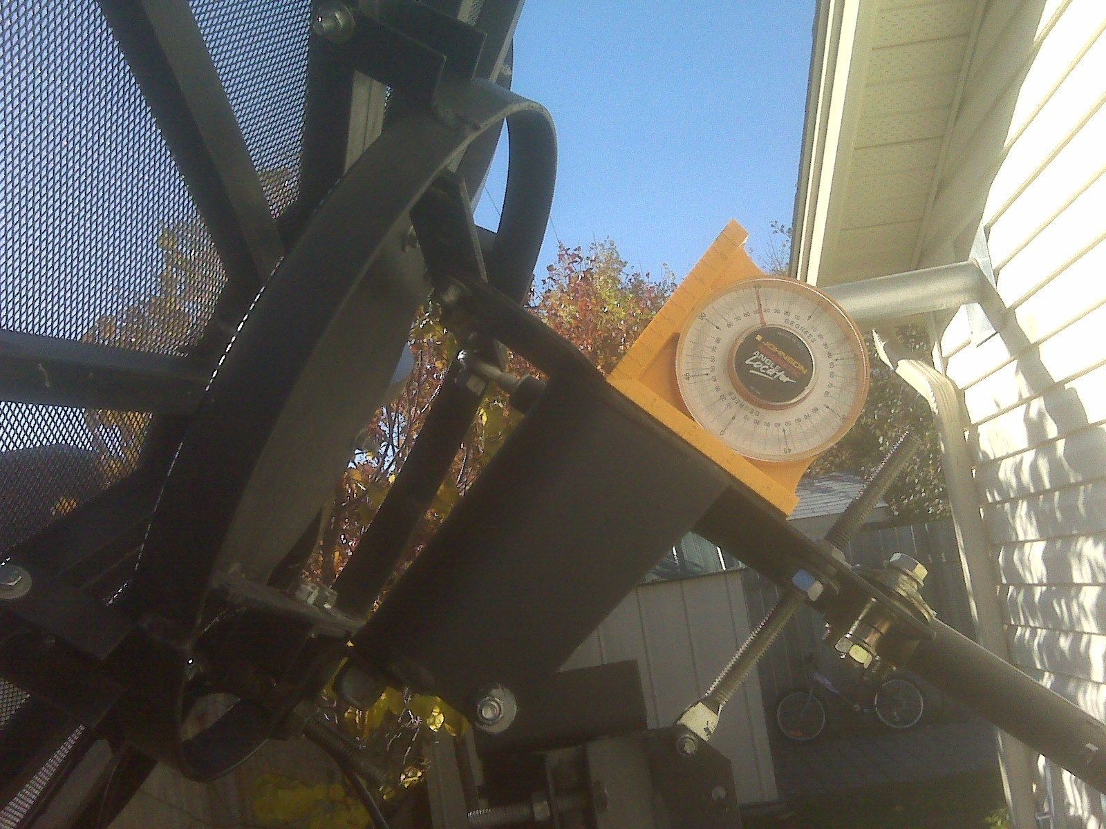

Will the Angle finder fit like this, see pic?
Is that part Square to the Main Axis pivot point?
I think then you would not have to subtract from 90

Good call...it doesn't fit perfectly but I used a 2x6 to extend it and measured the same 48 there as I did on the top, so I'm continuing to use the top. For all I know I'm using the inclinometer the wrong way! But I doubt it, as I always keep the magnetic side against the surface being measured.
