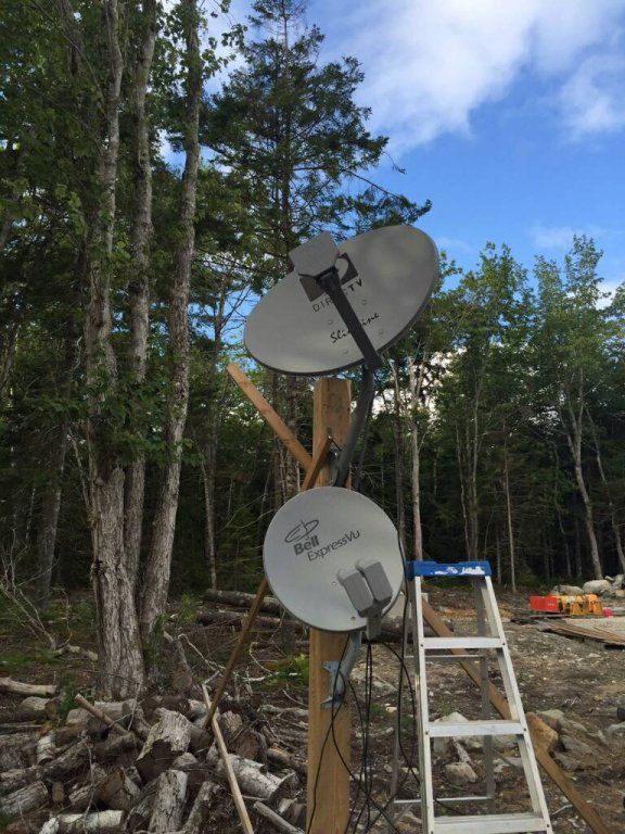

Posting for a friend.. prior to moving to a new home his signal levels on 101 103 99 were mid 90s. Moves to new house and can't get more than 60 on 101 and 0 on the others... He has a clear line of sight over a lake and mast is plumb.. he's swapped lnb with his dads lnb which is confirmed working has tried his dad's receiver and his dad's power supply.. this is a swm 3 setup.. we are both baffled.. I thought maybe it's warped during the move but nothing visible ... dish was pre set with dishpointer for our location.
I should add he tried for hours moving the dish in various directions using fine tune it drops below 60 but never above

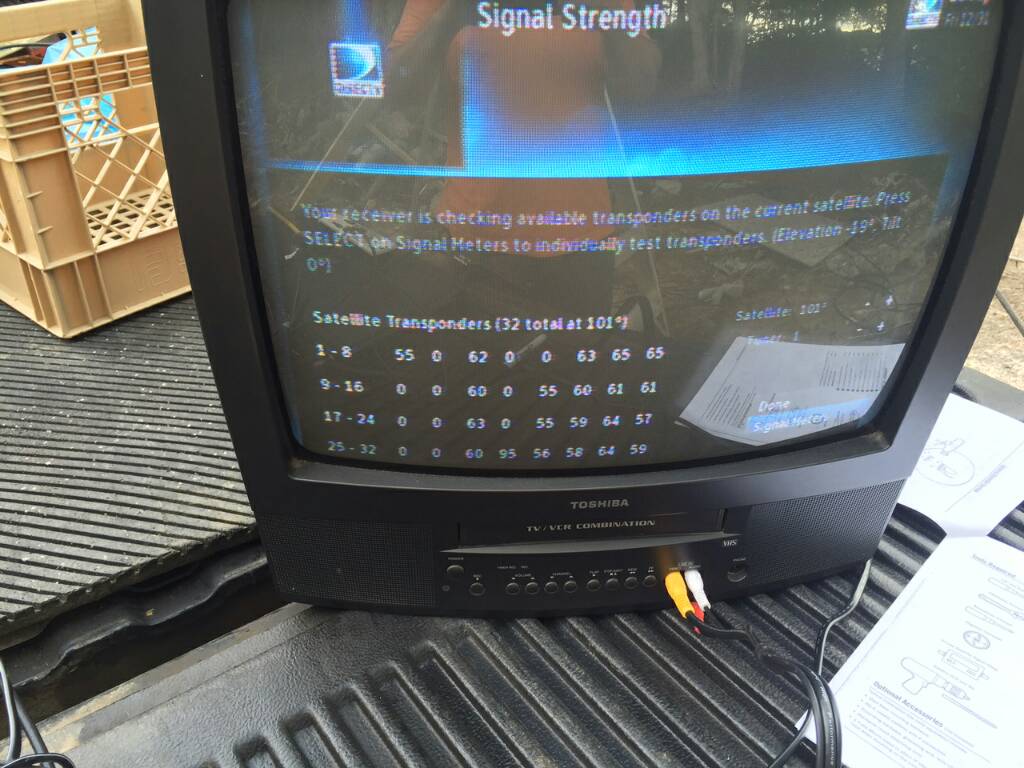

I just noticed peds had posted what I think is a relevant question. I suspect you are pointed at the wrong satellite...
He was using transponder 3.. I suggested checking transponder 1 and it was lower signal than trano ponder 3
Checking one transponder does not help, as peds says we need to see all the 101 transponders....
ok I'll get him to send a screen shot of the 101 transponder chart
a photo of the setup and a photo of 101 transponders
Looks to me like a simple misalignment issue, unless there is a problem with trees in the line of sight.
Are you sure you are setting the elevation correctly, using the painted edge?
And what's the zip code of the location?
No trees.. it's pointing right over a lake.. yup verified he is using the painted edge and the pointer for the skew for his settings.. he's in Yarmouth Nova Scotia
. his dad is 2km up the road with perfect signal.. he's borrowing a buddy's dish to try some more trouble shooting
