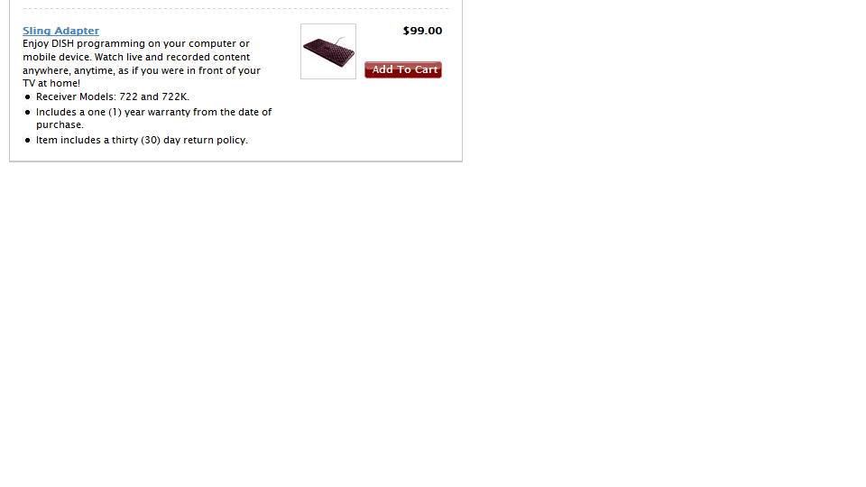

I pointed that out last week to the CSR and she said they don't offer that on the SA, only exchange. Plus you will be billed all the shipping charges for two round trips. The way I saw it, same old sh*t, CSR's refusing to do their job of CUSTOMER SERVICE. Instead it is a Customer INSA ( TOO FUCING BAD ). I think I would need to contact the CEO complaint address to get a RMA for refund.
Well, I would point out the refund reference right on their order page:
Not necessary to show me that page, Cosmo. I did point that out to them and I told you what they said. They refused to give me an RMA and without that you'll just be spending money with UPS as their receiving dept will refuse and return to sender. I only got an RMA after they sent me a replacement. So, I still have one but for me, I have figured out how to make use of it.
