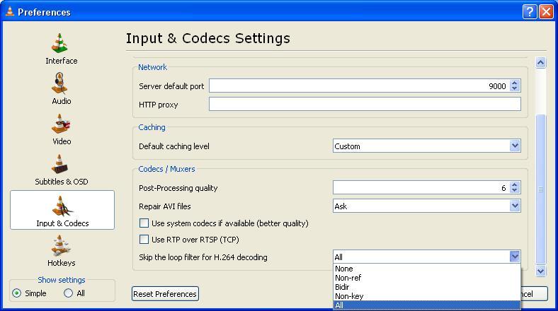

Thanks. Interesting. The FFmpeg menu looks different in the PC version of VLC, and doesn't have the options mentioned, but I see several other potential settings there that I haven't messed with. Thanks.
Yep, its there. Go to Tools > Preferences > Input Codecs & Settings and scroll down. See screen print.

OK. I have about 5 different versions of VLC on my computer, and I accidently pulled up an older version. When I pulled up the more recent version, now I see it. I eventually found the skip check box even in that older version, but it was in a different section only found when you checked ALL instead of simple, and it didn't have the options, just the check box. Now, I'm not sure which version of VLC I've even been using recently, since it's generally pulled up automatically by TSREADER. I'll have to check to see which version it's using. I see that that skip feature says that it reduces quality, so I think I'll wait until the next time MPEG4 gives me issues then try that to see if it helps. THanks.
