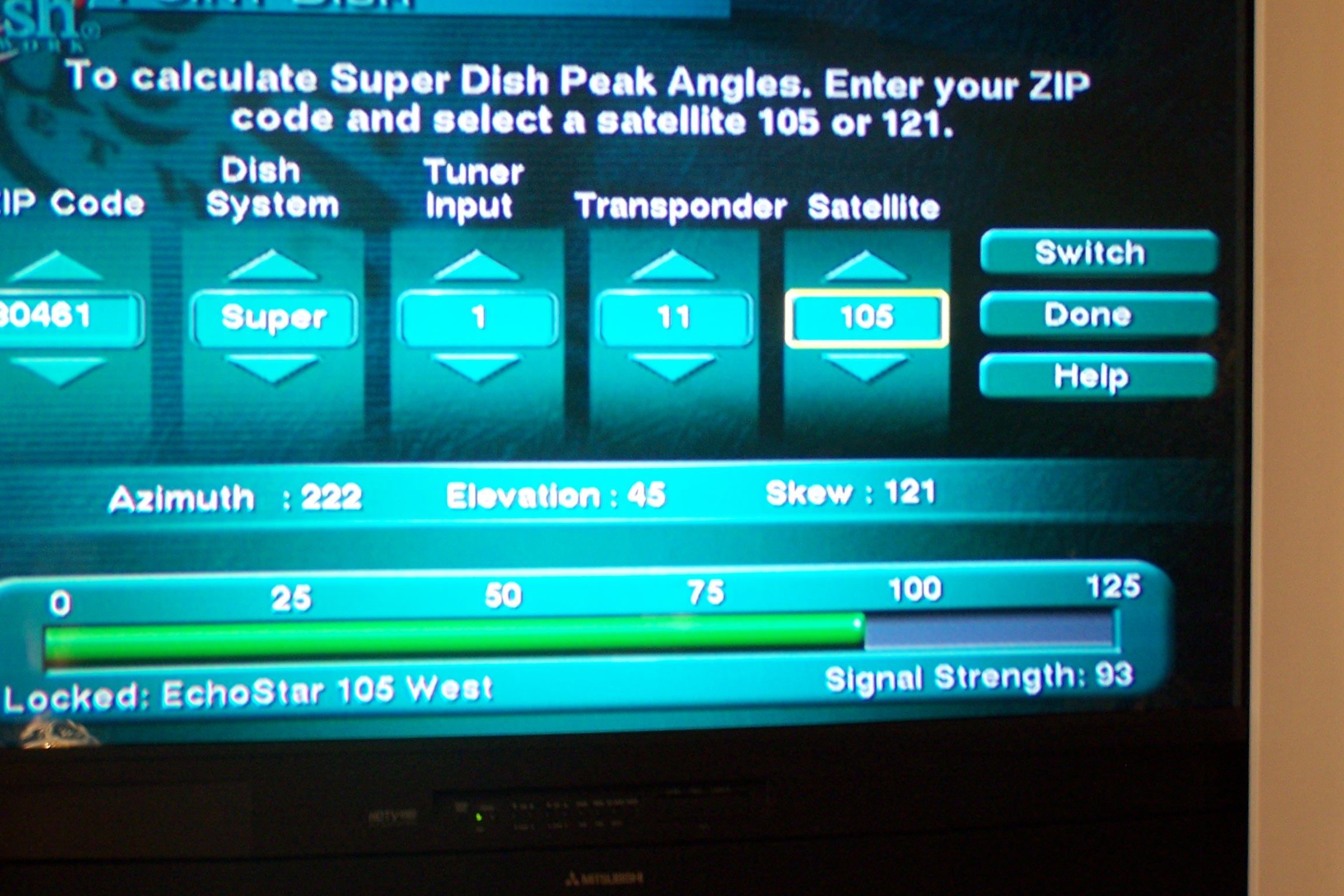

trido
I finally go around to taking a picture. I checked each transponder and got anywhere from 90 to 101%.
Yea, thanks, I just got my citation in the mail from the Dishnetwork signal strength police. I paid the fine and as part of my community service I was told to never put a percent sign behind one of their signal strengths again. :D
I too was wondering why I kept seeing the 90% or 101% being written. Its not precent. I guess when folks see a range which goes from 0 - 100 (even though its 125 in this case) they think percentage.
