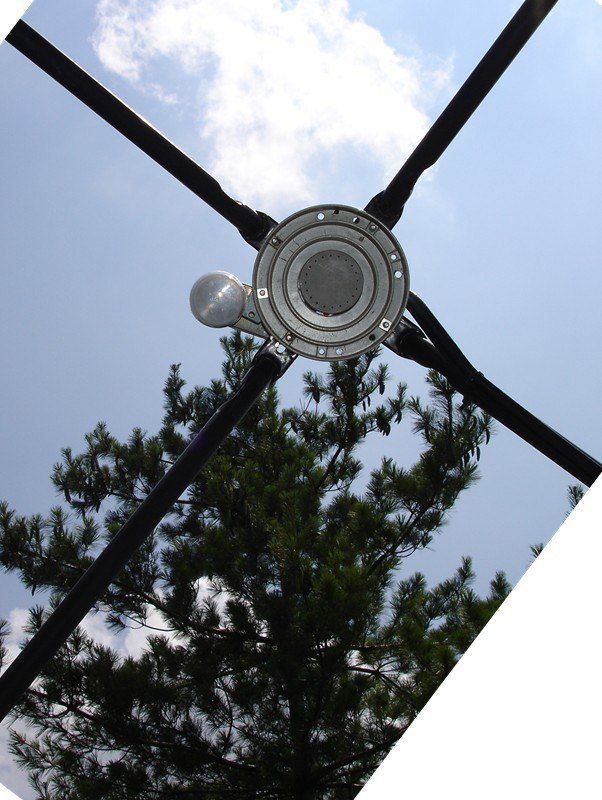

Please List your LNBF and dish. Maybe Lak7 can help you fine tune these channels, it's a wee tricky.
Sats on either side are good?
Mine's a wee tricky for sure.......
