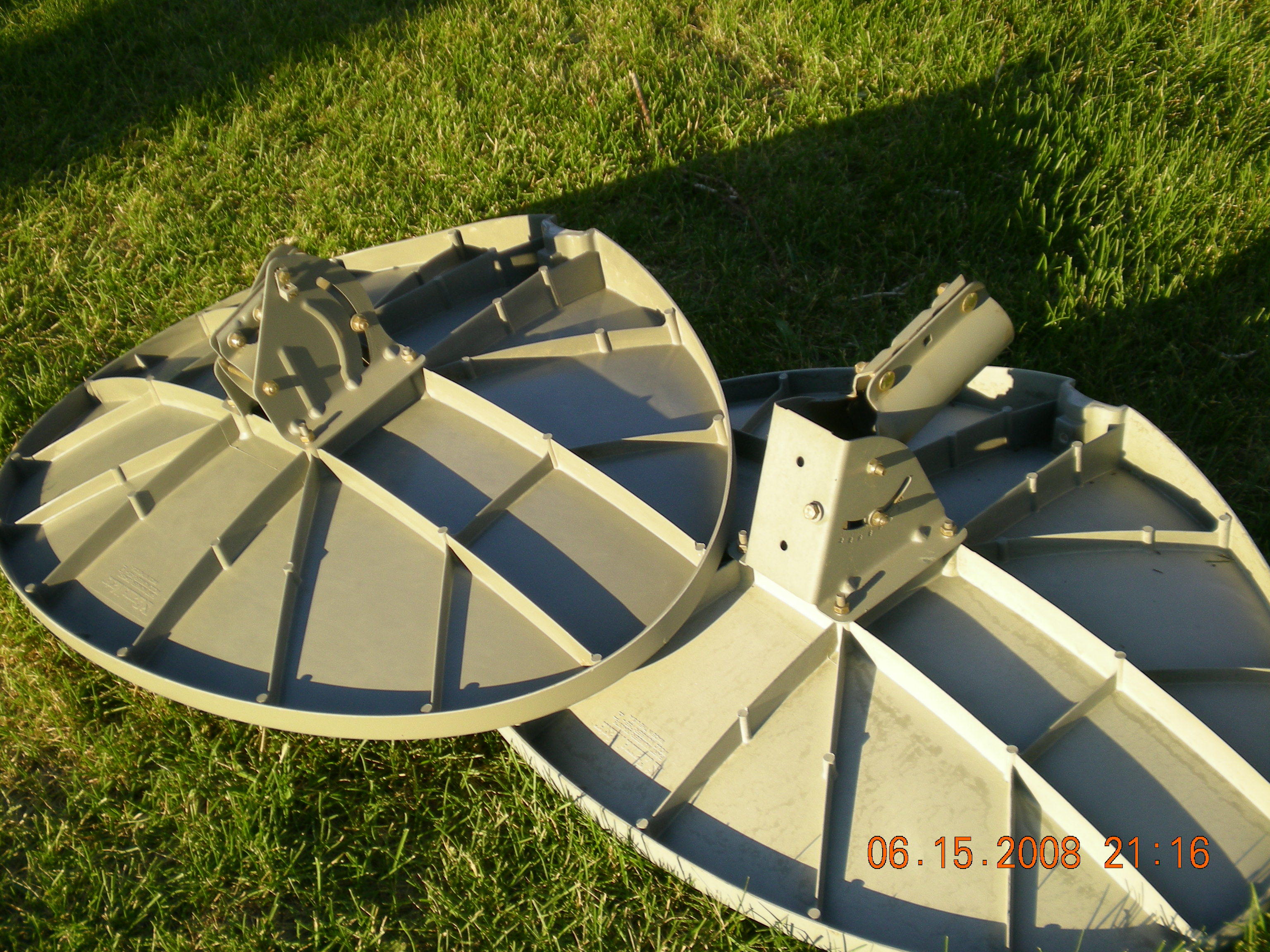

Well I have aquired a Primestar 84E. Its 40" by 30". I got it in pieces and am missing the elevation "pivot" and the elevation pointer. The long bolt that comes
down from the top is there but nothing else. Anyone ever ran across some hardware that you can make one out of? Anyone got one out there they dont
need?

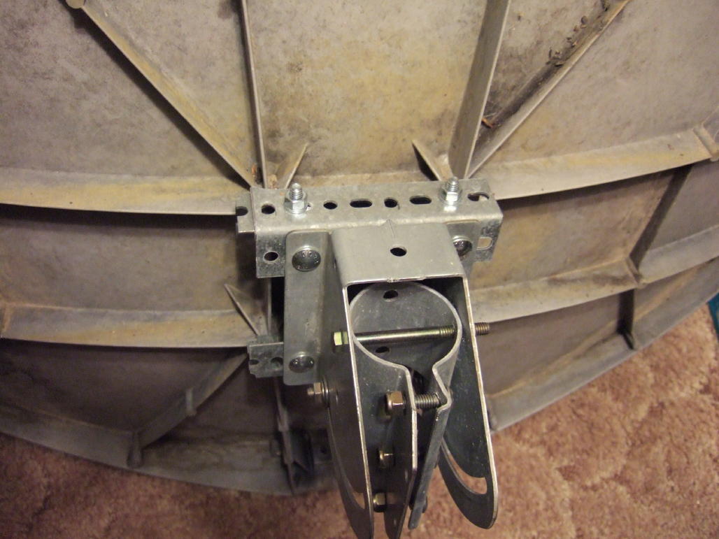

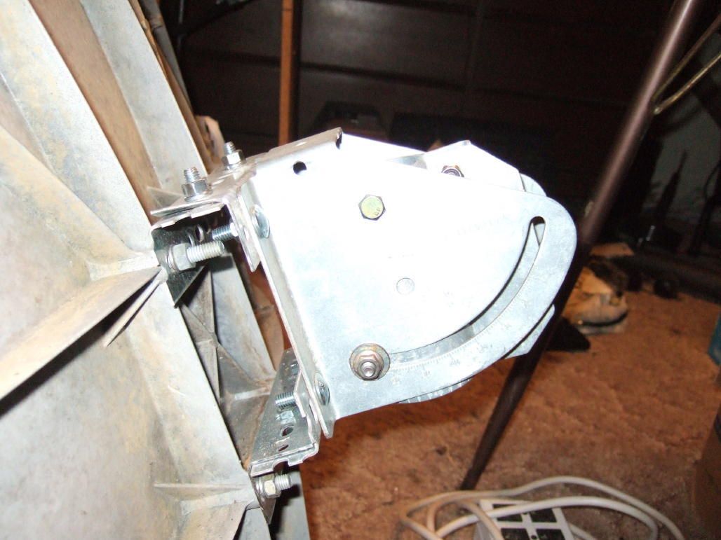

It probably is possible to make one... I am not near any right now (wish I had brought one with me) I posted some pictures a while back of the dishes. I will try to find the pics and see what it takes. You do not absolutely need the adjustment but it sure comes in handy. You can use a bolt and nut to hold it in place.

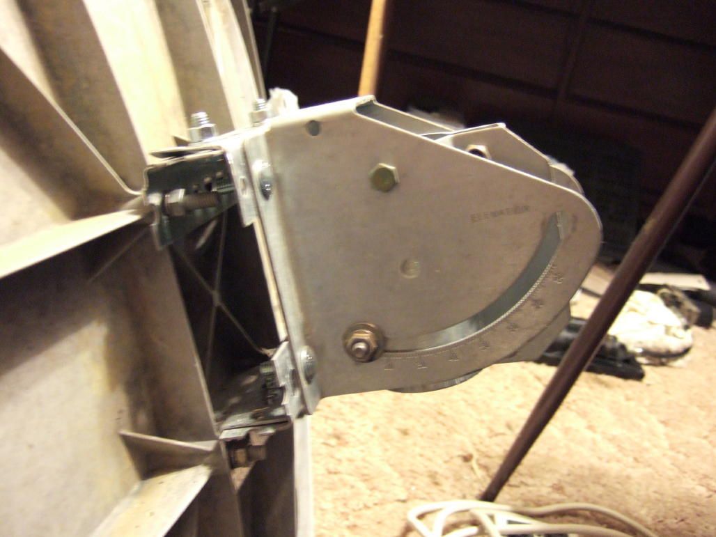

That one does have the adjustment screw. The other one does not, but it is lighter so it might work better with a motor. That also is an 85E the other is on a 75E. I did not realize it when I took the picture. I think I see what Gary needs. I can not remember what is behind the bracket, but will see when I get back to the property.

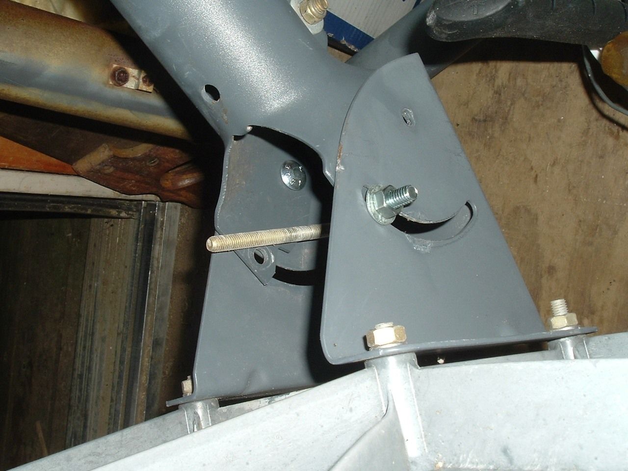

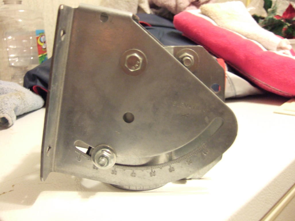

i do have a extra heavy mount.... i adapted one just like it up to a primestar 84e but its heavy and would probably only make a good stationary mount.... probably to heavy for a motor. it looks like stainless :) pictured below

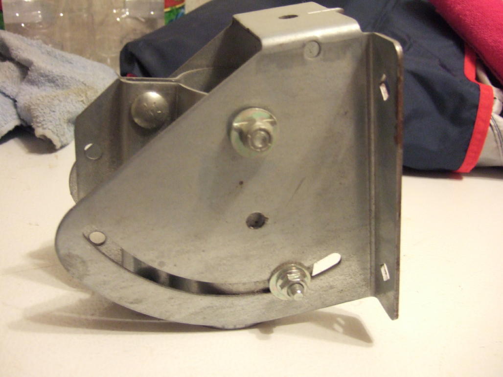

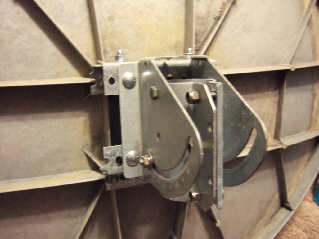

Sorry, I should have posted a picture. rv1pop is right it is not essential. But it would be nice to have. Im not sure exactly what it looks like since its missing. The long elevation bolt comes down from the top throught the adjustment "part". Im not sure how the pointer goes on since its missing too. If anybody has a good picture of it assembled it would be helpful.

oh the adjustment bolt thingy (elevation "pivot") .... i do have one of those somewhere
the bolt was brok off and still inside i just adjust the dish manually
if you need it let me know , you would have to remove the broken bolt
let me look at it and see how hard it would be to remove :)

The idea of an elevation adjustment bolt seems fine, but from my experiance with my StarChoice 75e, there is just too much play. (at least with that dish)
STAR CHOICE 75-E ANTENNA ASSEMBLY
The pivot point of the dish on the clamp bracket needs to have a tight fitting bolt, and the elevation adjustment bolt neet to have very little play for when adjusting the elevation, the dish does not move without turning the bolt.
