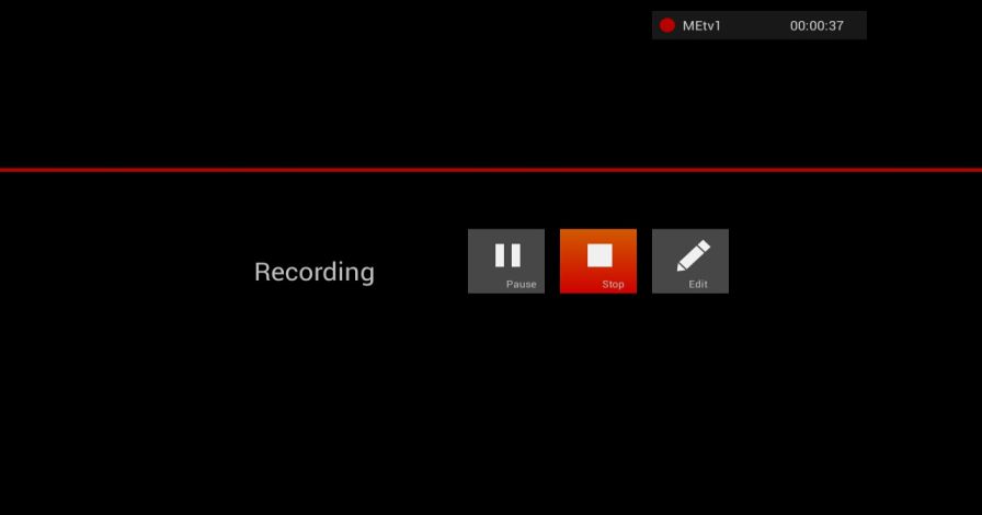

As far as PVR keys on the remote, when the Record button (bottom left on the remote) is pressed the recording starts. Pressing the button again brings up the screen below and you can choose whatever you want to do.

One thing that frustrated me was how to stop a recording. I hit the record button on the remote and then looked for the stop button, but it wasn't there. I searched all the Amiko Americas sheets without finding an answer, then found the European manual which provided the answer - so obvious in retrospect - hit the record button a second time.

Thanks, that answers my question about why it doesn't have the classic PVR buttons on the remote. I use those buttons so much that it wouldn't work for me to have to bring up the controls on the screen and then point to the one I want. Seems like too much work for functions I use all the time.
