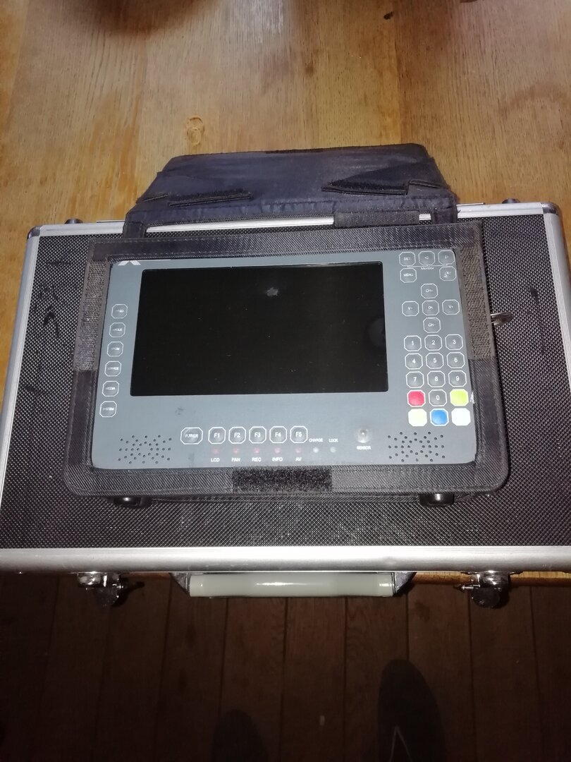

have a problem with an Amiko XFinder. as soon as or when I start it up I get to see the text: no signal and nothing else happens. it doesn't start up normally, and can't go into the menu or whatever, who knows what to do?!?

how can i post a picture at this post.
Mvg
this one
I addressed this in PM. Never had one of those. He also failed to mention on the forum here that is was already sent to Amiko and he got it returned saying cannot be repaired.

If Amiko can't repair it, it's likely no good and you might as well toss it. Here's the manual for it. If following whatever the manual tells you doesn't work, then I'd say it's time to buy another Xfinder, or a different one completely. https://www.hb9afo.ch/articles/x-finder/usermanual_Amiko_X-Finder_EN_v130516_web.pdf

Without Amiko's help you are on your own. At over 200 Euros for a replacement, it is not cheap.
If it was mine, I would take it out of the case and look inside to try to spot any obvious problems on the circuit board.
Or it could be that one of the keypad buttons are stuck. Also check the power supply with a multimeter to make sure the battery is getting charged.
If you are not comfortable doing that, the next best thing would be to sell it on eBay (or similar auction site in Europe) "For Parts or not working" and maybe recover some of your money on it, which you could use to buy another one or equivalent.
I have already taken it out of the housing, and everything seems normal to me. It starts up normally, but gets stuck at a certain point and does not want to continue to the next program and see (AV1?!blink for a while.) and then disappear again
Some more ideas:
1) Does it have a coin size 3V battery that you can replace? It might help.
2) Can you flash it with the latest firmware? I am guessing probably not since you can't get to the menus.
3) Use a multimeter to check for voltage coming out of the RF Input. (Without power an LNBF would not give you any signal). If there is no power then I would recommend an LNBF with 2 outputs. Connect one output to a known good receiver (which will power the LNBF) and the other to your XFinder. Then your receiver will provide the power that is absent from your XFinder.
4) Take high resolution photos of the circuit board (both sides) and post them here. Maybe someone here will be able to spot a problem?
