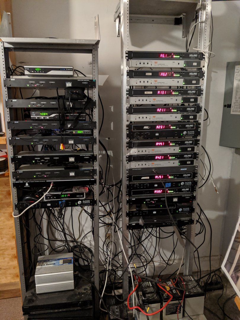

Hi folks,
I recall when I got "that" cable bill that made me go insane and start the journey towards cord-cutting. But I have a tougher time figuring out when I went a little over the top. It might have been when my wife said; " Now thats just over the top." Anyway, it has to lead to adding internet stations to the existing mix of local content players, FTA, and OTA channels in our house. But worst of all I realize in my madness also lead to creating the ugliest headend in the world. So I thought I would share...
headend-jpg.141357
I think I have a good shot at taking first place.

You run your own cable company?!
The money he spent on all those components, racks, UPS systems, and cabling cost more than what he was paying before he "cut the cord." How many years of cable bills would it take to equal the investment in all that hardware? :facepalm
I'm still trying to figure out what most of that stuff is!?! There's overkill and then then there's that!
To me, the components look like tuners and modulators that take channels from various sources and pack them into some kind of cable-TV-like arrangement. He's basically created a cable lineup just for his home.

I guess you could say that ...I ran across a small cable company that upgraded and was trashing the modulators. They gave them to me for free, but I see these on eBay for as low as twenty bucks. For me cord-cutting is easy, but my wife only wanted to click the remote (on any TV) to watch. You definitely don't need all of this stuff, but I took on the complexity to make it easy for everyone else in the house.

It would be interesting to hear the breakdown on what sources/signals are being modulated there for sure.
Hi,
Basically there are two devices for each channel. The upper device is the source; the lower is the channel modulator. The rack on the left mostly has FTA satellite receivers as the source; they are connected to two dishes. There is one modulator connected to an outdoor camera that lets me see and hear the occasional wildlife in the wooded area behind the house. There is also a Roku for internet sources; and streaming. I use Titan TV to make a custom line up of OTA channels; that source is a Raspberry Pi that refreshes every minute. The rack on the right is mostly OTA sources, 10 local channels; one is just weather (Alabama can have strong storms from time to time). The lowest source device on that rack is a DVD player; I usually loop something just to avoid having an empty channel. There is another small rack (not shown) that has two other Raspberry Pis; those have digitized content - mostly movies and music 6 TB of videos/concerts. That rack also has a Chrome cast for any streaming content that anyone wants to cast on a TV instead of a phone/computer/ iPad.

I have to wonder how much all that equipment is running a month in electricity. With all the receiver and modulators, I wonder if the energy would get you close to a youtubeTV or a basic cable subscription. Cool way to put the old equipment to use though. Are your modulators ATSC or is it the older SD channel type.

I was initially concerned about the energy cost, but I only a small amount increase vs. $140 cable tv package. I have a Kill-a-watt meter, so I plan to measure the true power consumption. I did setup solar panels and a small grid tie inverter to reduce any extra expense, but I haven't done the math to see were we stand. One thing I also did was to connect batteries to a 3000 watt standard inverter, then check to see if it would run everything (in case of a power outage). I was pleased to see that the output meter didn't even move with all headend equipment powered on. In fact the meter didn't move until I turned on the tv (and older 42' Visio flat screen).
These are older modulators; the specs are here:
https://www.multicominc.com/wp-content/uploads/drake_vm1550_specs.pdf
Looks like they only consume 10 watts each.
