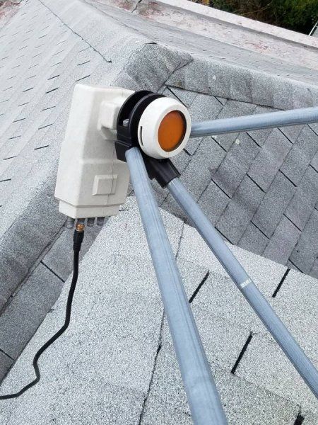

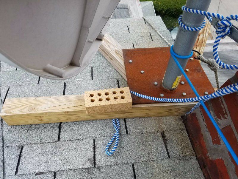

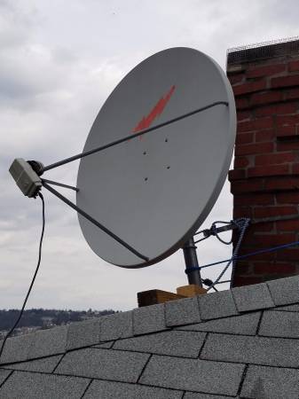

Andrew Channel Master 4ft/1.2m Satellite Dish (Ku band / C band) - $85
Used for legal FTA satellite TV reception.
Includes choice of LNB: Invacom QPH-031 or Avenger PLL322S-2.
Also includes mount, stand, and base as pictured.
Other accessories are available.
Total of 5 pictures on site.
https://morgantown.craigslist.org/ele/d/andrew-channel-master-4ft-12m/6424323865.html
Is this worth the aggravation?
A. Problems:
a) It is probably to high,some of the old houses in that area are tall,and being on a roof. I would not take it down.
b) Other sources show it having 3"pipe for mounting.
c) Raven, next owner of production; sat search store in EU shows shows using a 18"super jack for motor. Wow that thing must be heavy?
d) At 4 ft. I doubt it would fit in a car?
e) Is it something I want?
f) while I have KU set up for several years, I am not deeply familiar with it.

If you have google earth it's easy to find.It's way up there on a steep roof,wouldn't touch it without a manlift/bucket truck.

Tell they owner to take it down for you and you'll buy it. Nice dish. they weigh 22 lbs. (fiberglass part) The dish is a fixed mount. It would not fit on the HH90. I think you can put it on a STAB HH120 with an adapter pipe. I brought mine home in the back of my Subaru wagon. It just fit through the tailgate. I use a microHD also.

I be leave I found it, but sheesh. It's not only on a high 2 story house, with exposed basement up from the street on a bank. It's on top of a dormer that is smaller and higher than a regular dormer that's on the front. The size appears to be a large house, with 2 chimneys that I can see, and the chimney it is fastened to goes down through the house, so it is inset quite a bit from the edge of the roof.

That's a good price, and cheaper than even just the shipping on a metal 4ft dish!
I second you buying it if they bring it down to the ground themselves.

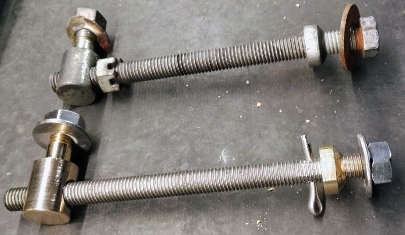

Another picture, just to touch all bases, and in case of problems that I am not aware of.
I take it is still a good idea to get a receipt showing I bought it free and clear, in case it wasn't theirs to sell?
All suggestions, reviews & opinions are greatly appreciated.
Yes, that is the fixed mount that was used on these dishes. There used to be a polar mount available but no longer made. There is a UK version of a polar mount available in Europe. You saw that on their web site. If you are good with your hands, have tools and mechanical skills there are other possibilities :)
Use PB Blaster or some sort of penetrating oil on the bolts. I broke the fine tune bolt when I had that dish. I could still aim the dish, just not as easily.

On the ad "Includes choice of LNB: Invacom QPH-031 or Avenger PLL322S-2."
PLL322S-2 seems to be a universal KU LNB, two leads. Any value?
Invacom QPH-031, KU LNB 2 Linear& Polar Outputs , with a lot of information that I do not understand?
On these LNB's, am I better off to let them go, and maybe buy a Maverick LNB, or use GEOSATpro I got with my 36" dish.
