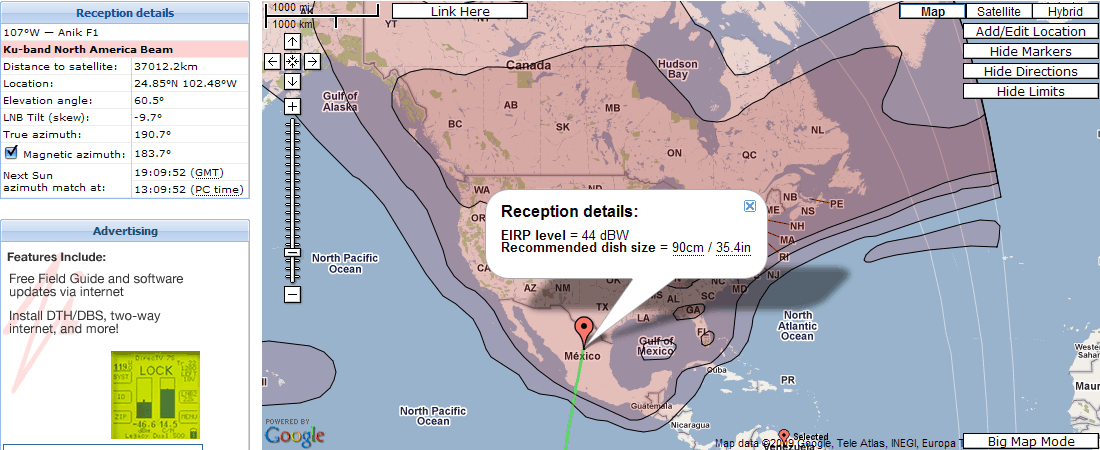

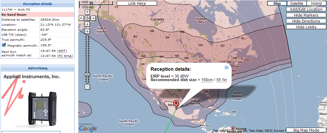

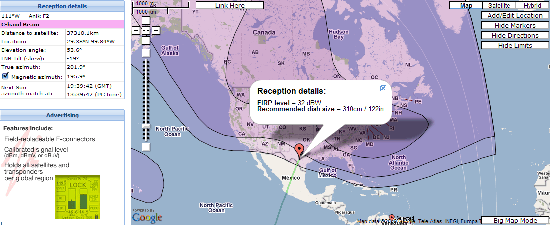

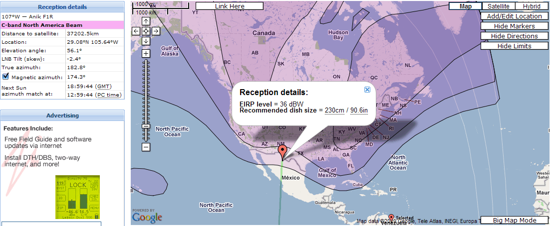

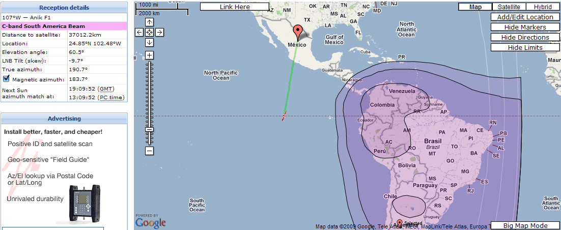

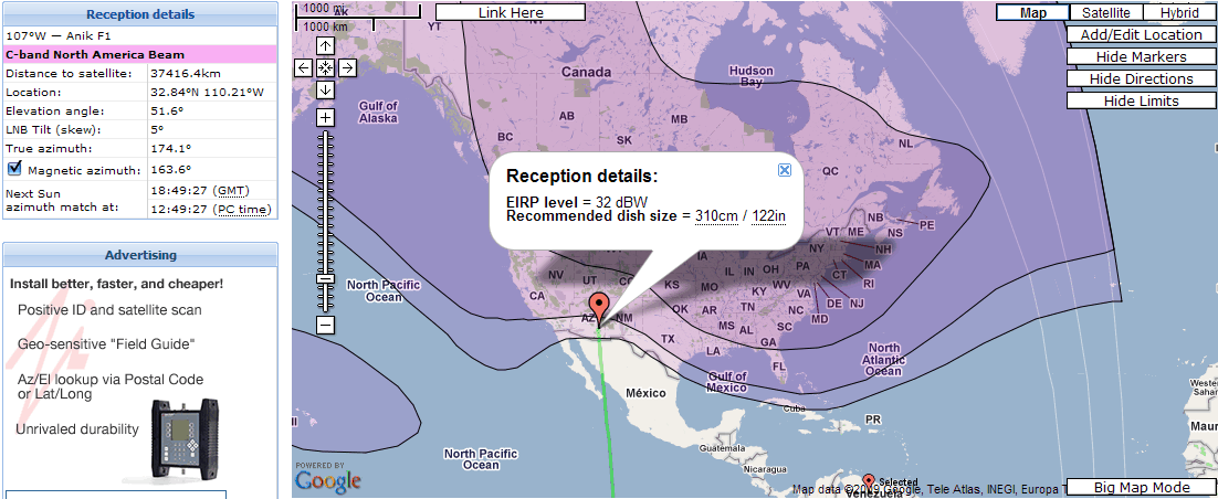

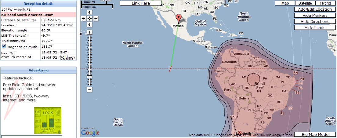

Here are some footprint maps to help you with these specific satellites.
This series is for Anik F1 and F1R @ 107.0 W

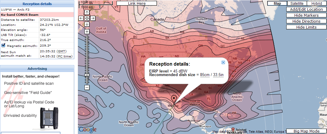

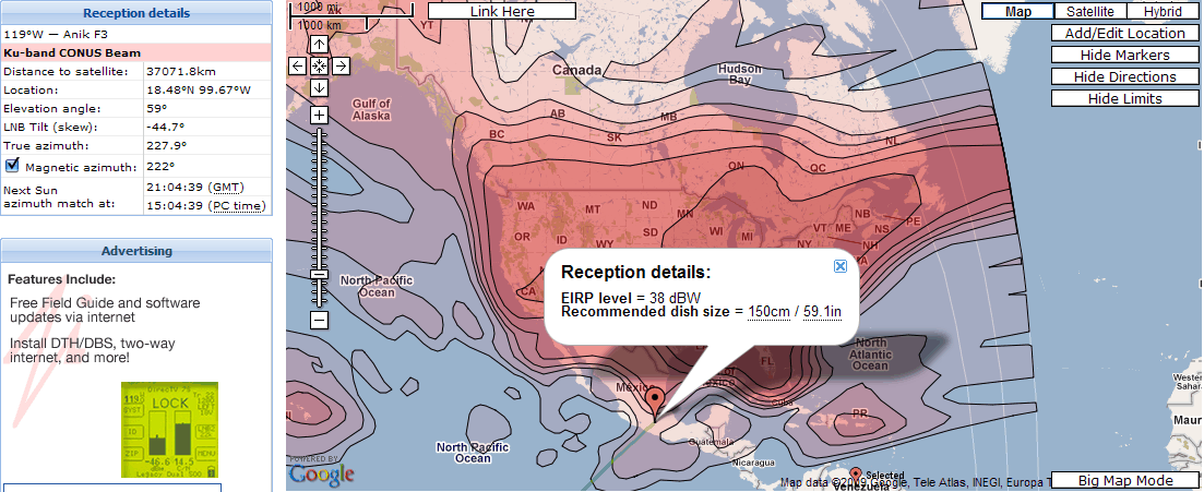

These last few are for the C and Ku band from Anik F3 @ 118.8 W.
The Ku band here would be the best receivable signal in your area, but I don't think that any signal here is FTA. This would all be DN and encrypted. These signals also require a different LNBF variety. The frequency is similar to FSS band, but it is a circular polarized signal.
These footprint maps are from Satbeams.com. I thought you would find them interesting and informative. It appears that central Mexico is not served very well by the Anik satellites.

Thanks Radar, hopefully someone with a C band hook up can answer as well
UPDATE: wasnt able to get any C Band FTA feeds from the Satellites I mentioned, Im thinking the signal is not strong enough for Central Mexico. Which reminds me that I was never able to get the Aniks even in the good ole days of analog C Band
A friend who lives in Puebla can get the Univisión channels @ 118ºW so he doesn't has to pay to watch the soccer games. He is using an 8ft prime focus dish with a digital BCS-421 LNBF.
Also from other people living in Querétaro and Jalisco, it seems the footprint acts a little bit weird in some places since the can only get a sniff of the signal, being able to watch the channels only using 4 and 5 meter dishes.
Still... those people who told me are relatively new to FTA since they only used to steal Dish channels and have acquired prime focus dishes to fulfill their needs (altough i suspect that once they can steal the signal again, they'll do it), and judging by their past, i am fairly sure they don't know how to properly install a prime focus antenna and might be getting less than what they can.
In the northern border and part of the NorthEast coast it's viewable even with a 6ft-8ft dish.
If you need to watch univisión try to get the channels at either 91ºW or 95ºW and Telefutura at 135ºW. Telemundo, the other channel a lot of people use to watch the sport i despise the most because of the sissiness of their players always crying non-existing fouls: soccer, can be received with a 90cm offset dish for Ku band (a Sky antenna is of that size).
