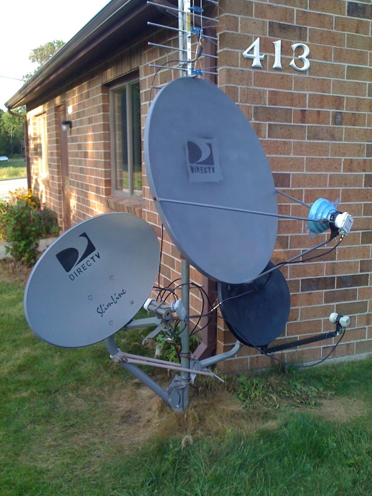

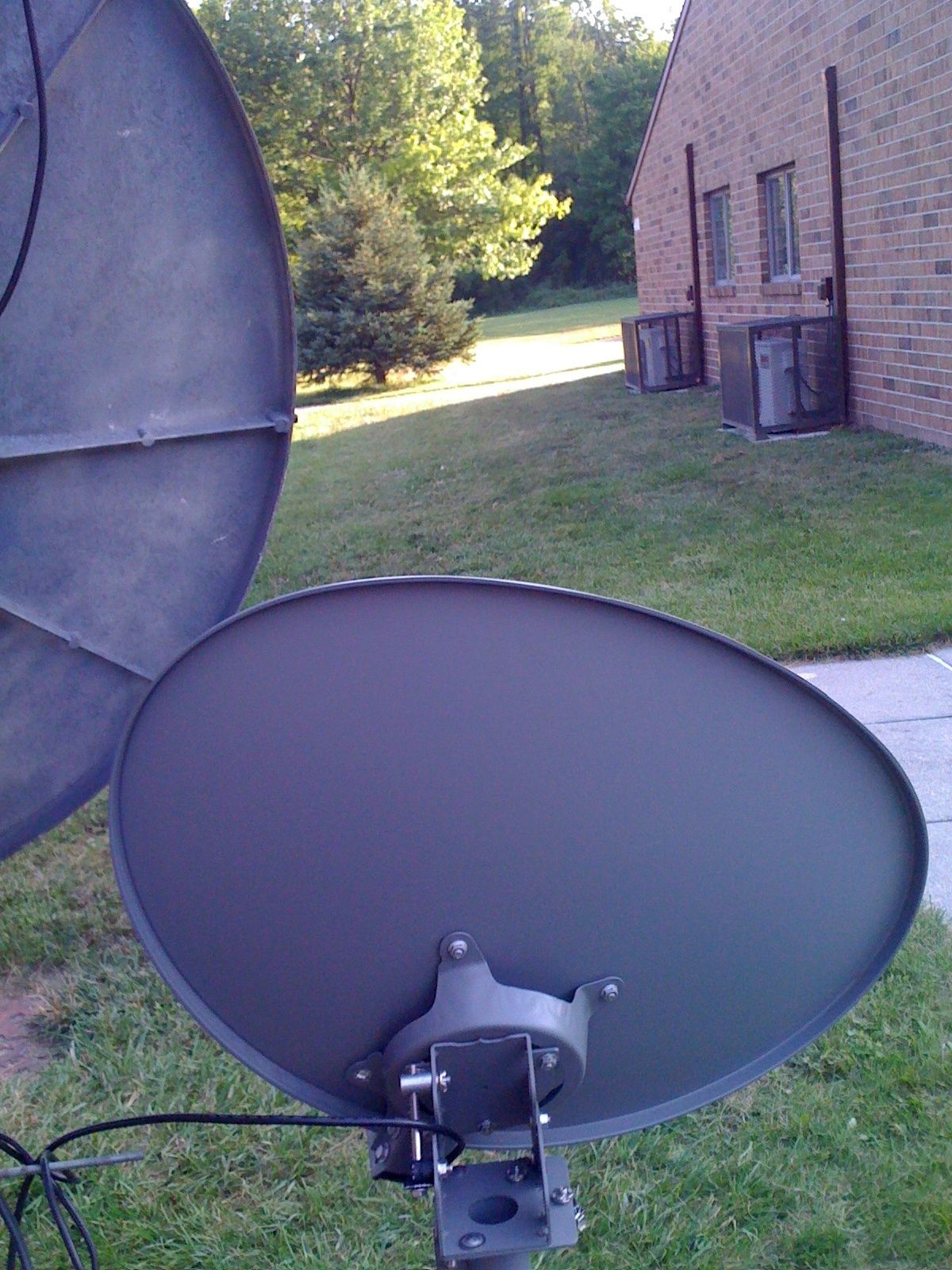

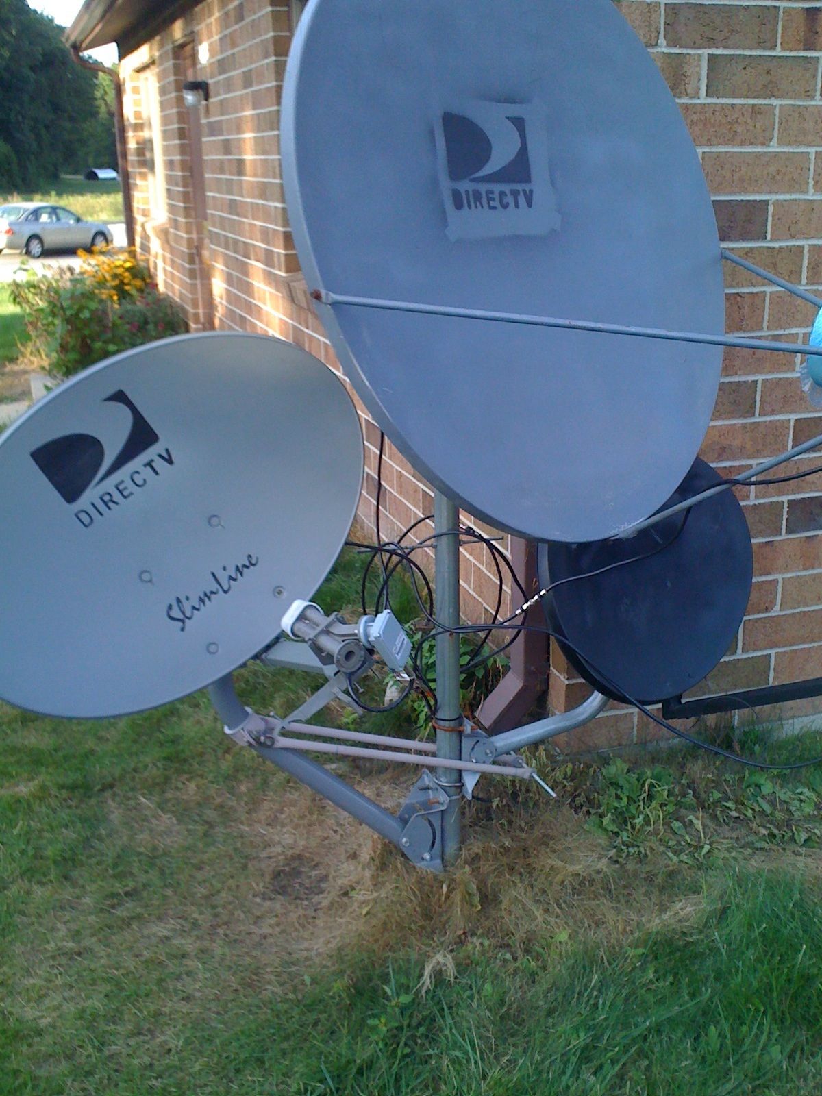

What do you guys think more pics I added another dish to the pole now it has 3 dishes on it.

121w to 125 west. My apartment manager said no more dishes in the ground didn't say i couldn't add on to the pole that i already have. My neighbor said he really don't care as long you don't make a lot of noise, drug deal or have he cops called on you.

We already had a discussion about OTARD some time back, and you said you couldn't afford to fight an eviction with the idiots there.
Now you are adding more dishes out front, and inviting trouble.
?Would hate to see you get screwed, but it's coming.
Your right anole I should kind of scale it back a bit I was just seeing if I could get that stuff in. I wasn't going to add any more that was it for dishes. Just trying to have some fun.

I am not a fan of motors cause of so many people that don't like them plus if something fails i don't want to be stuck in one spot. So thats why I several dishes.

You do know it's possible to put multiple lnb's on ONE dish, correct? If the sats are no more than say 6 degrees or so apart, you can center the dish on the middle sat, and get that, plus the sats on either side of center. For a total of 3 sats on a 1 meter dish...
Of course you need to aim very good, and have some luck besides.
What I wanted was 99w c band, 97 ku band, either 87w or 125w for pbs for mom. I am not much into sports just like watching good tv shows.

I could do that on a Primestar elliptical dish... 99, 97 and 87 at least, and all the KU sats in-between. Still, if you never watch more than a single sat at a time, a DisEqc motor would be your next best solution.
That or slipping your landlord a case of whiskey now and again, lol.
I might take that dish down the slimline and put a smaller dish in its place like the black dish. the slimline sticks out like sore thumb. I thought about motor but decided against it.
