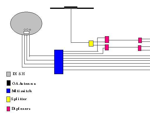

It sounds like the installer put a diplexer on the end near the dish & OA antenna, that's why the system didn't work correctly with all four lines going into the multiswitch. What you need to do is run a 5th line from the OA antenna to the location of the multiswitch. Then reconnect the line from the dish to the multiswitch and pur the dilpexer inline on the other (downward) side of the multiswitch. To add a second HD receiver and set it up for OA reception as well you will need to split the OA line and add another diplexer. I have drawn a diagram of how the system should be set up. If the diagram doesn't come through let me know, I can email it to you direct or send it through a private messege.

I think you're right, uboatcmdr, about the diplexer on the roof.
If I replace the 4x8 multiswitch with a 5x8, would that take the place of the splitter and the first 2 diplexers? And then just add a diplexer at each HD receiver?
Also, is the splitter you mentioned just a diplexer turned the other way?

Thanks for the quick reply, Mike.
I'll run another cable from the OA antenna to the switch area, and go the way uboatcmdr laid out in his excellent diagram. Thanks for the heads up about the signal loss.

The splitter is just a standard 1-2 cable splitter that you can get at any RadioShack, Wal-mart, Lowe's or Home Depot. I'd stick with the 4x8 and just use the splitter & the extra two diplexers. The diplexers are less than $10 each whereas a 5x8 is close to $100 (diplexers are much cheaper and you really don't need to send the OA signal to all your receivers anyway).
