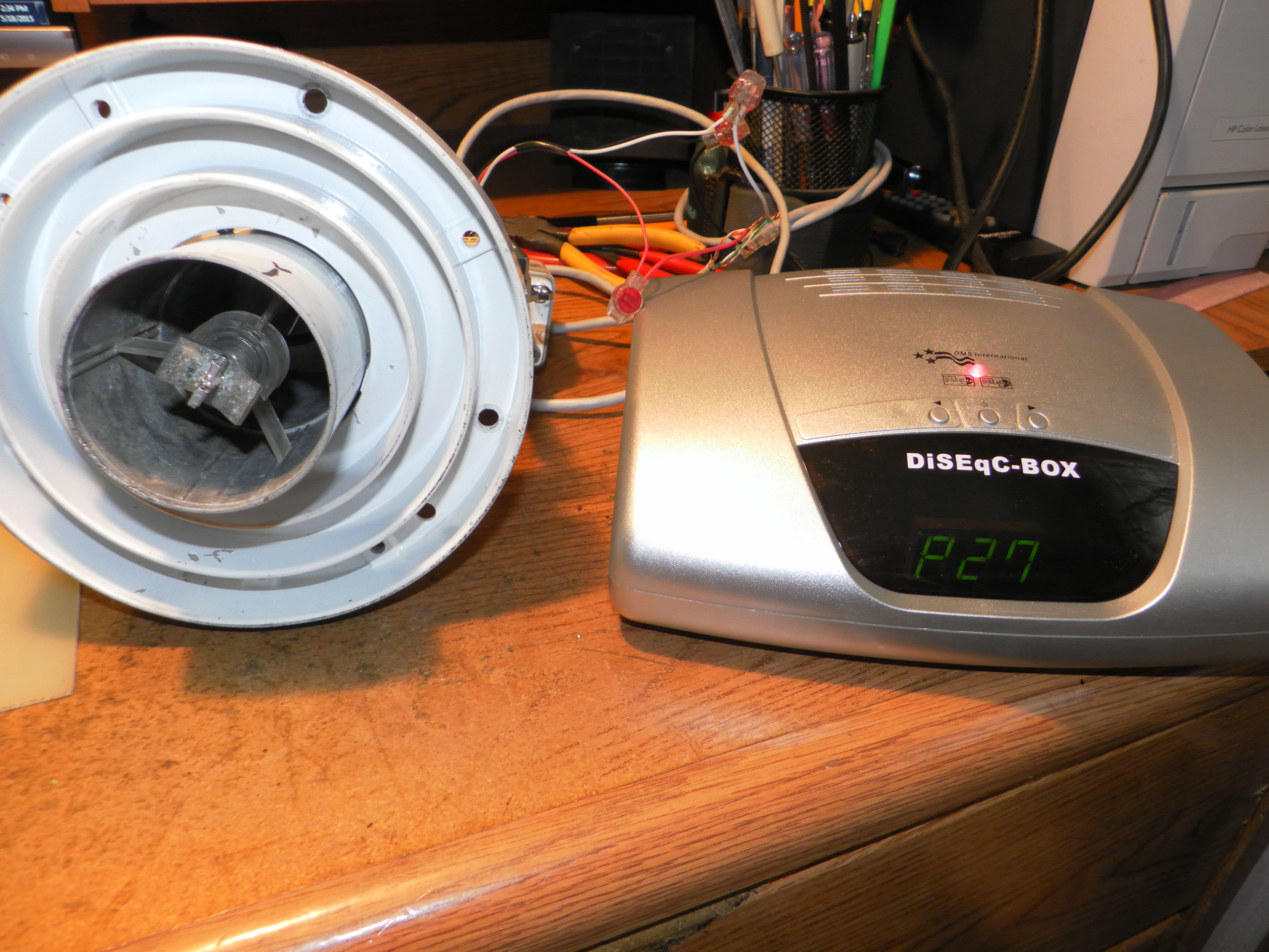

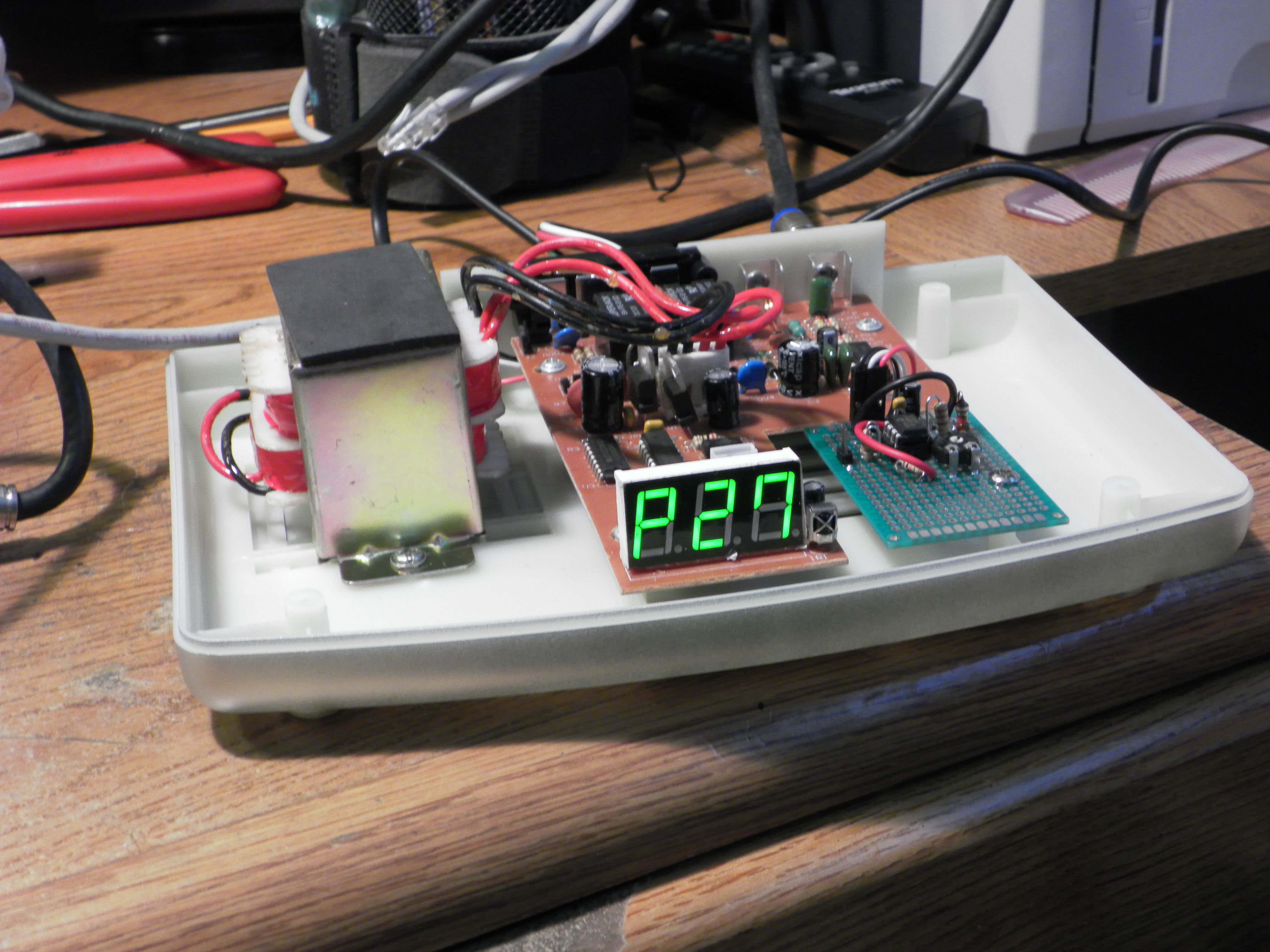

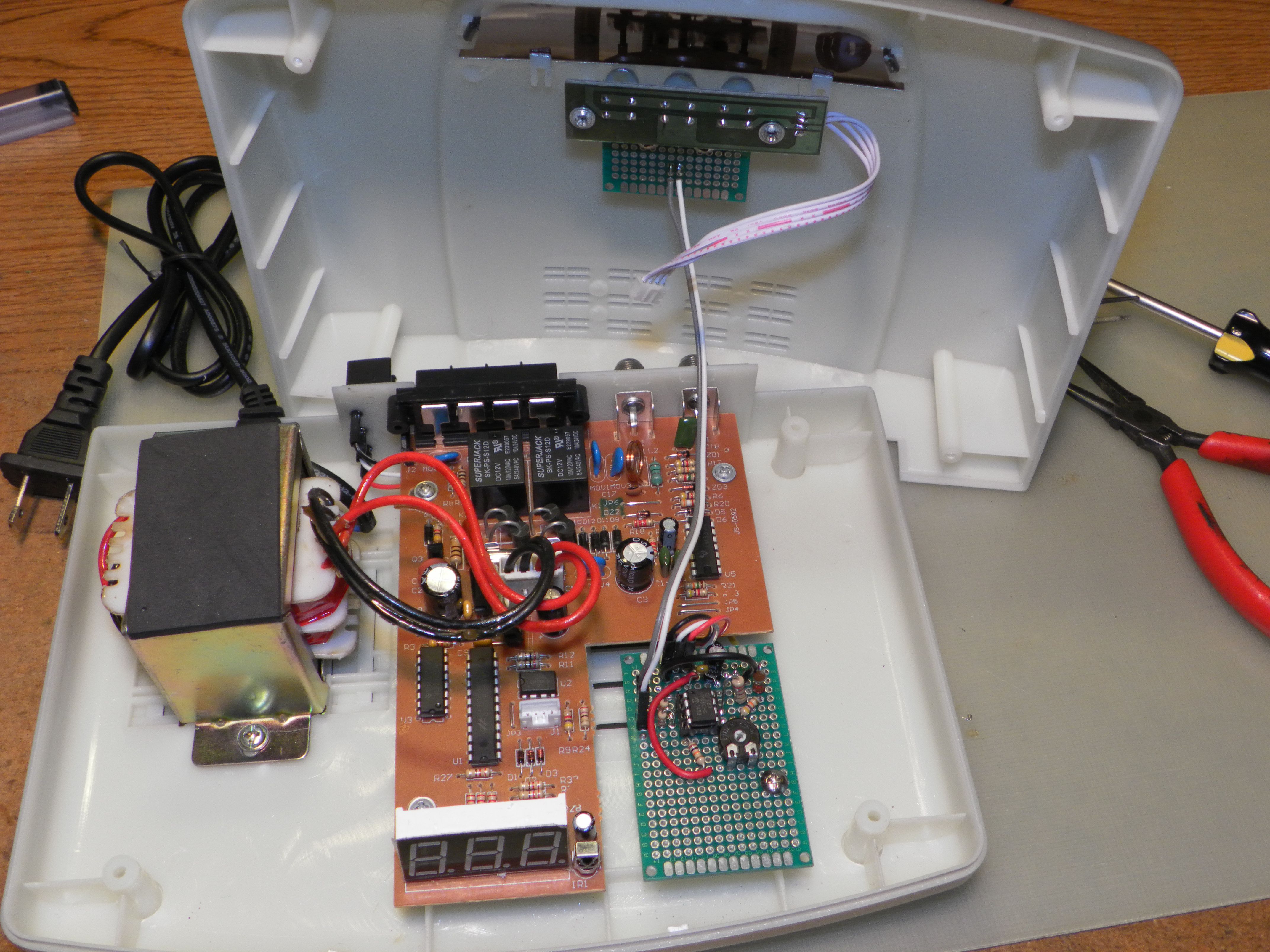

I have been salvaging some circuit boards lately and have acquired a pile of components. I decided I wanted to make something. I had a lot of fun with the Deluxe Polarity Control circuit. N0QBH also has a basic control circuit :) So I decided to stick one of those in a new V-Box 7. NOTE: VBox controllers are no longer being imported to the states. They have been cheapened too much. :eek The failure rate is too high.

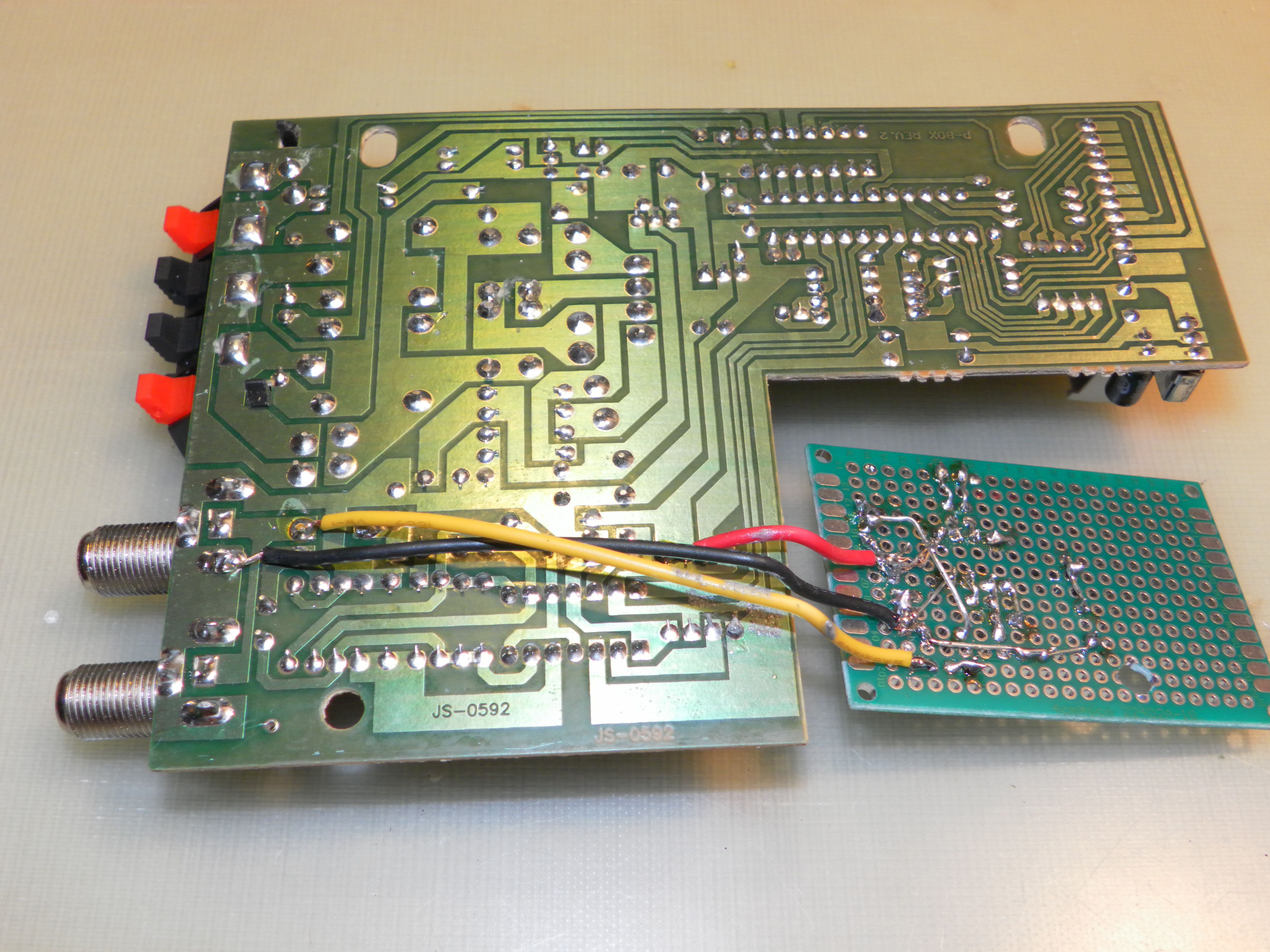

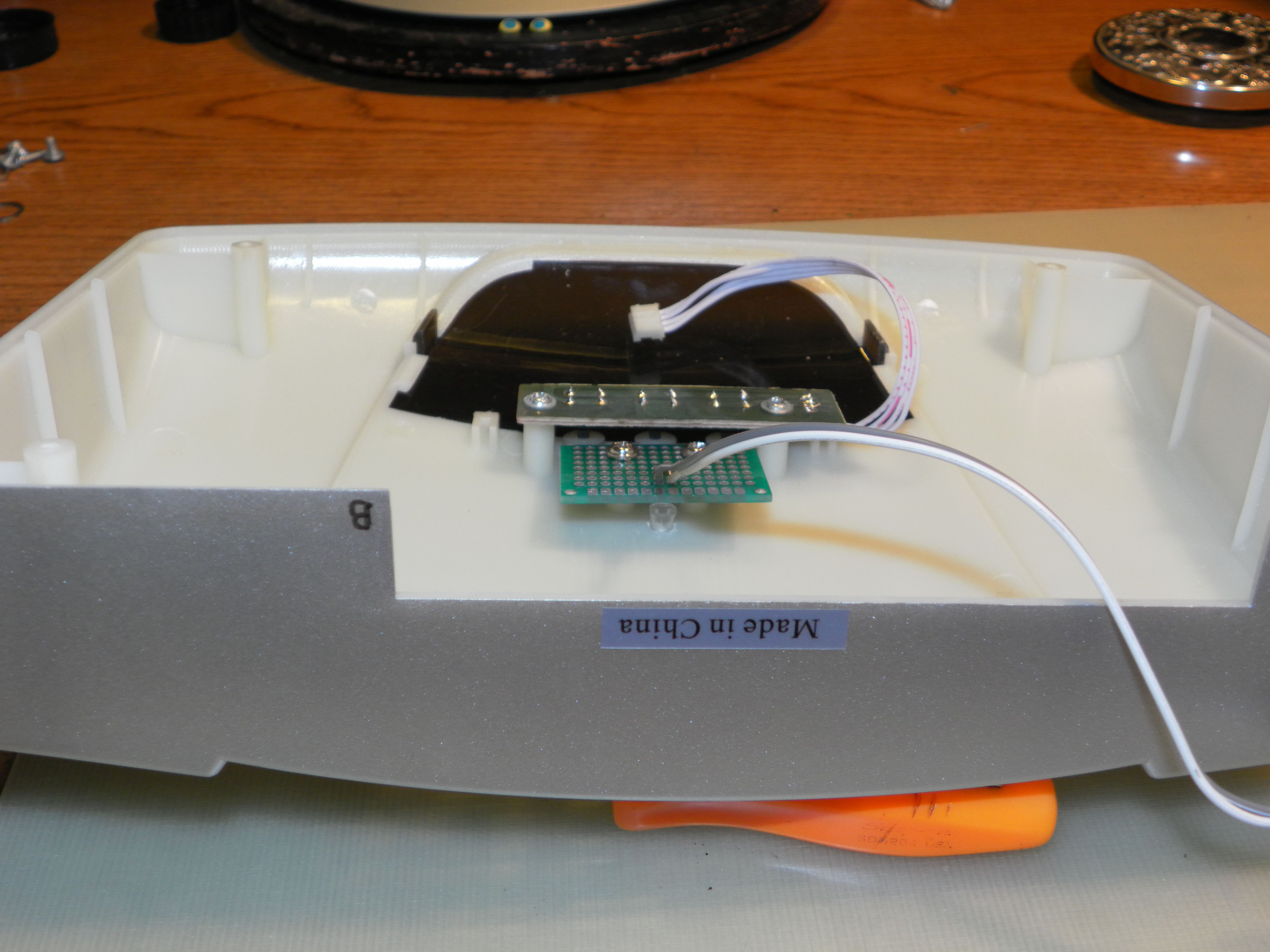

Well I managed to find some at LeoMall. Cheap :) So now with soldering iron in hand I'm starting the new project. Instead of a display there will only be a bi-color LED indicating V or H polarity. There is no skew adjust control. It basically operates like a voltage switch LNBF, simple. But since there are discrepancies between individual polarity servo motors, there is a calibration adjustment in the circuit (10K pot)
http://www.ringolake.com/pic_proj/satellite/sat_projects.html
Pictures to follow :)
Well the camera is working. Unfortunately the polarity control is not. I had a devil of a time getting the chip to flash and I think therein lies the problem. I checked powers and grounds and checked continuity with no issues observed. I'll work on the chip and see what I find. :)
VBoxMod 004.JPG VBoxMod 010.JPG VBoxMod 016.JPG VBoxMod 025.JPG VBoxMod 026.JPG
Reactions: riz-la

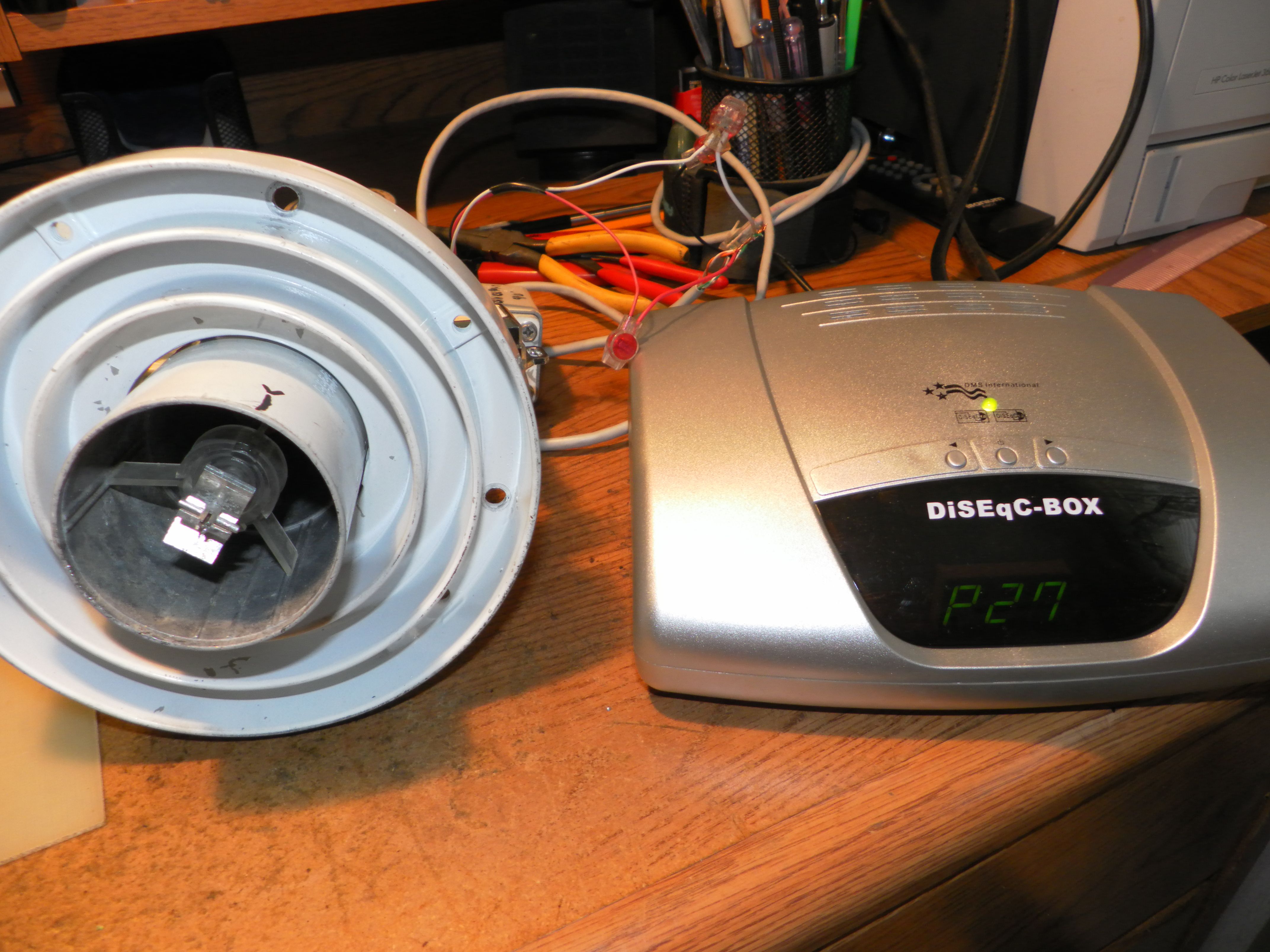

:happydance As I suspected. Reflashed the chip correctly this time. It helps to know how to use your programmer ;) This thing works pretty good. Calibrated easily. Very good stuff N0QBH, I like it!!!

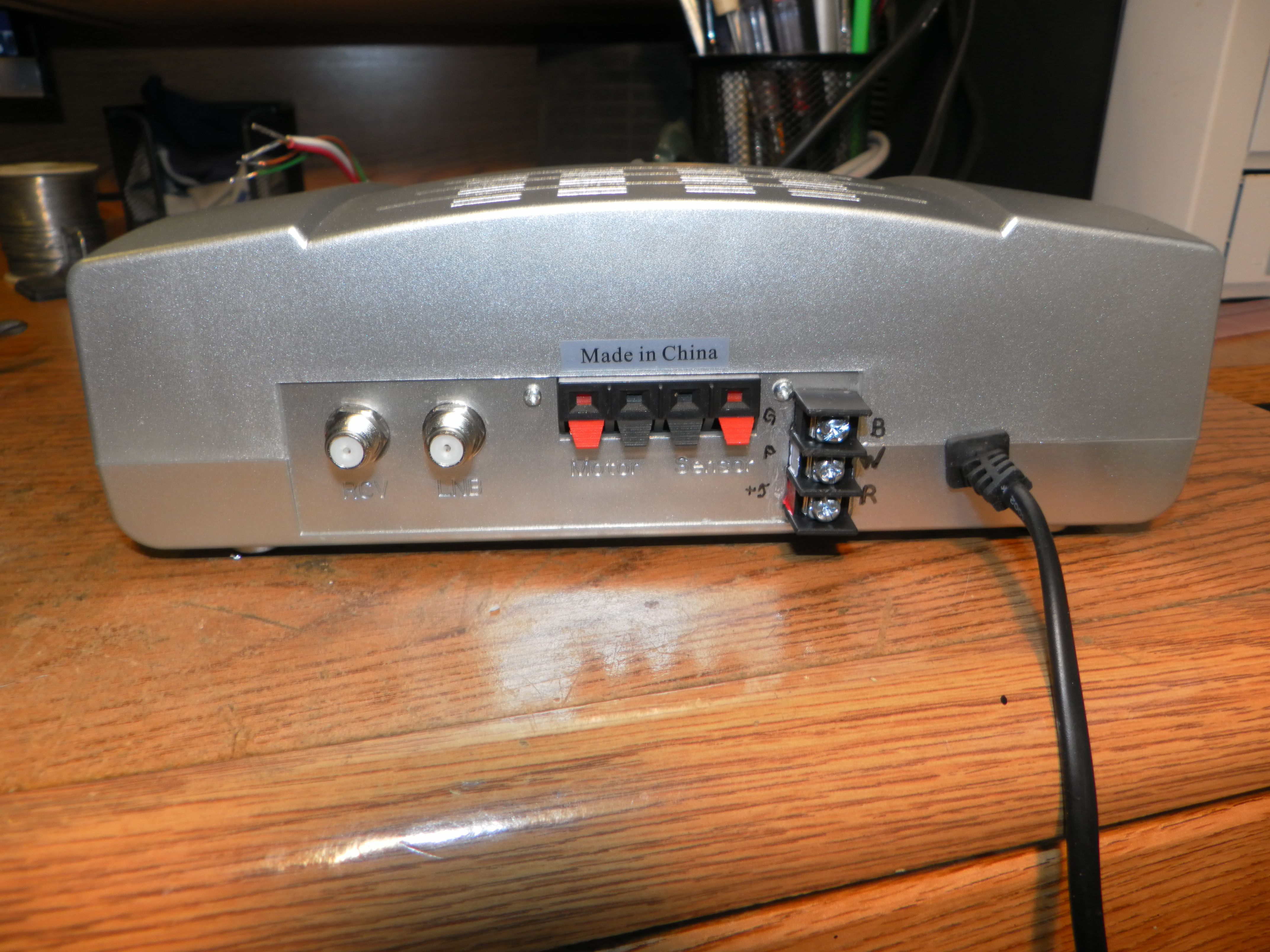

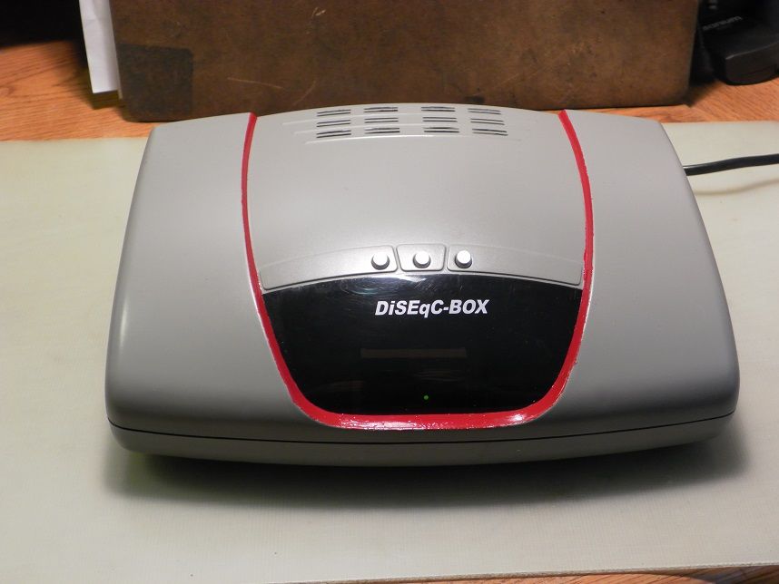

I'm using a 5V source from the VBox so the polarity control is always active when the VBox is plugged in. Red LED on V mode.

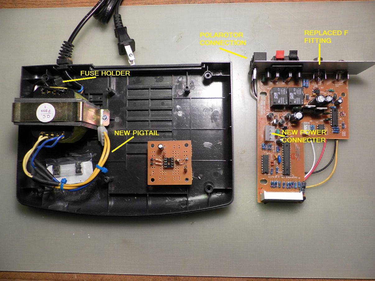

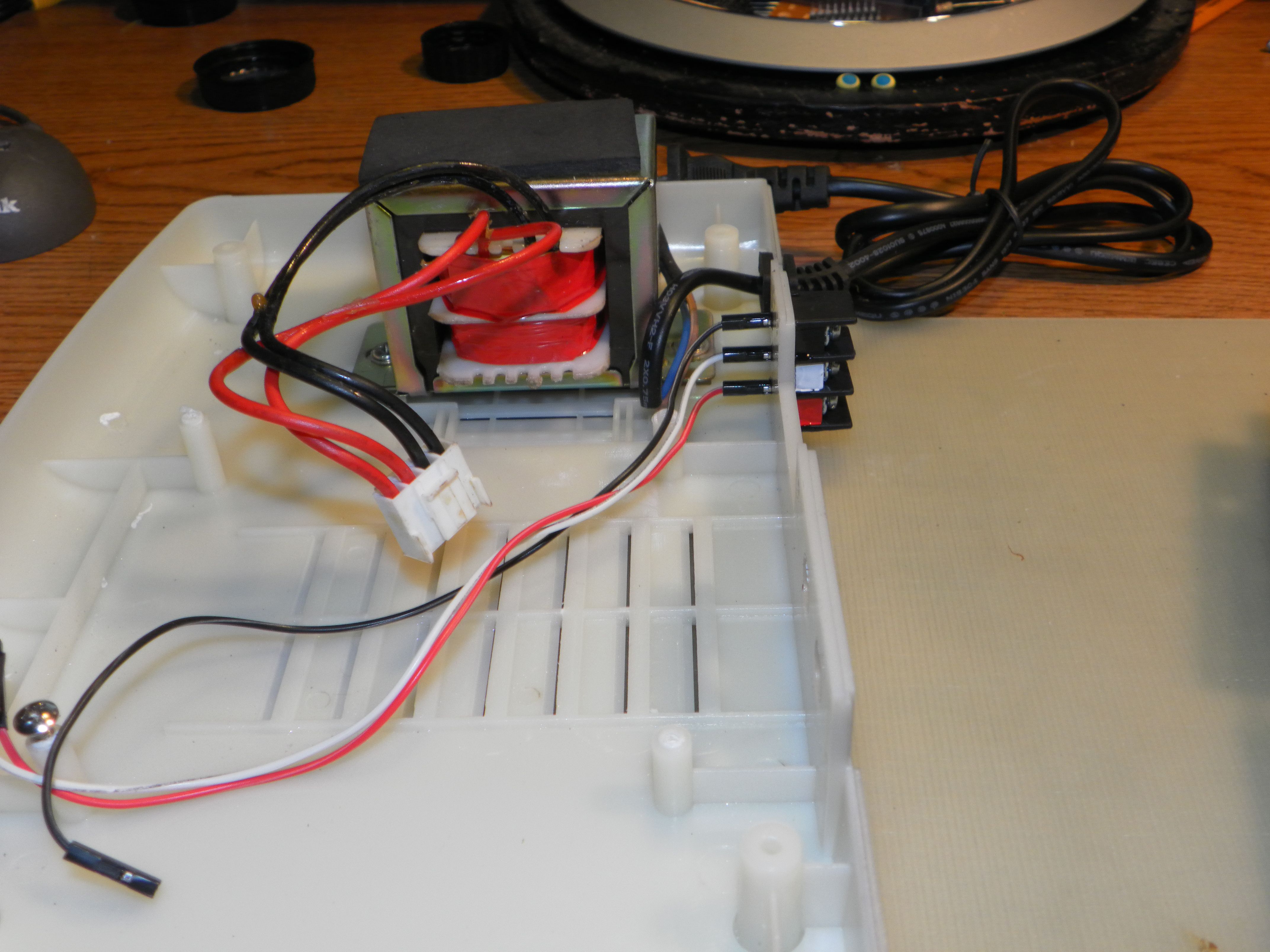

I have an old VBox 7 with a broken F fitting. It has a metal I/O plate on the back for the connectors. I found a good replacement F fitting during salvage operations and I think I'll do an "OverHaulin" job on that VBox and make some improvements and make it look pretty.
It needs a fuse for one. Unlike the newer cheaper cousin the old VBox does not have a connecter from the transformer to the main board. :( It's soldered directly onto the board. That makes working on the main board like dragging a ball & chain. I salvaged one of those connectors too :) The polarity indication LED is a bit bright and I think I will leave it inside behind the darkened lens on this unit. The old VBoxes have a better firmware than the new ones. This one will go on the Pinnacle with a Corotor II.
