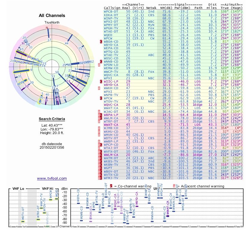

I dropped Dish and went with OTA/Netflix a couple of months ago. I have a Tivo Premier and I'm currently using a Winegard Sharpshooter (indoor) antenna that is on top of a tall cabinet in the living room of my 1 story house. It worked fine in the winter, but as I expected, I'm getting some break-up on some channels now that the leaves are starting to come onto the trees. I'm looking at putting an outdoor antenna on a 5-foot mast attached to the gable end of my roof - which would put it roughly 20 feet above the ground. Right now I'm getting all of the full power Pittsburgh TV stations, and several of the lower power independents with my antenna pointed west-northwest. I would be satisfied with getting the same channels with a roof antenna - without the breakup I'm getting now. It would be gravy to pickup some of the more distant stations (Steubenville, Morgantown, Johnstown) but I don't want to use a rotor - since most of our viewing are programs recorded when we're not around.
I was considering an 8-Bay bowtie antenna, such as the Xtreme Signal HB8X because it has two panels that can be pointed in two different directions - but I'm concerned about the wind resistance and the increased chance of multi-path issues. So, now I'm thinking of lowering my expectations and going with something simpler, like the Winegard FreeVision FV-30BB - a bowtie style antenna - or a Winegard HD7694P VHF/UHF - more of a traditional antenna, with a Yagi style portion for UHF. Most of the stations I want to get are in the general west-north direction - but they are spread out enough, that I need something that will cover about a 90-degree wedge. Some other notes: The Winegard Sharpshooter is amplified and I'm feeding not just the Tivo, but 5 other TV's as well (using amplified splitters). I'm assuming that whatever I get will need to be amplified as well. TV Fool plot is attached.
Thoughts?
That's a pretty nice tv fool report. Since you wouldn't mind getting stations in other directions but can't use a rotor because of unattended recording, you might want to give this a try (4 of 5 stars in reviews): http://www.solidsignal.com/pview.as...-Antenna(MS2002)&c=TV Antennas&sku=1579830649

My only comment on what FTA4PA and boba offer is that non-directional antennas in hilly areas don't often work that well, and the area around Pittsburgh is very hilly. You might try the antennas they suggested, but multipath could cause problems due to reflections off the hills. I'd suggest going with the Winegard HD7694P, pointing it where you get the best reception on those stations to the northwest. Your signals are strong, so you should do fine like that.
Reactions: spongella
Since most of the stations he is looking to get are nearby and LOS it probably won't be an issue. Definitely worth a try if he can get the 'gravy' of other stations as well but you do make a good point larrykenney. Living in PA myself, the mountains make my stations 2edge reception at 42 and 57 miles away and I need the 'big guns' for that. :)
With 28 broadcasters LOS and most of those under 15 miles away he should have good reception. I found an Aspen Eagle on ebay for $14.95 plus ship so I would give it a try if eliminating amplifiers doesn't give desired reception.
