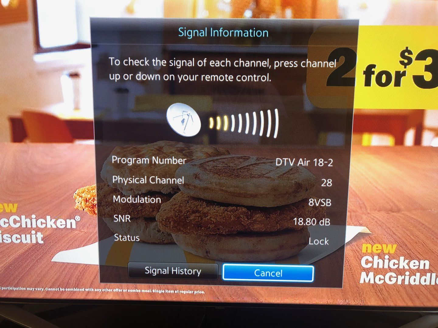

In addition to the longer mast in my original post, I also purchased a powered splitter (Antennas Direct 4-Port TV Distribution Amplifier) and installed both today.
I am seeing basically the same results. Attached is a screenshot of the signal strength from one of my TV's. Notice it is getting 18.80dB SNR. The other channels that come in fine are 31-34dB.
I unfortunately didn't check the signal strength before making the changes today to be able to compare.
Is a mast-mounted pre-amp the next thing to try? What I don't understand is that I am pointed at 4 transmitters, and the channels from 3 of them come through excellent. Why is the 1 so much worse? Is it the channel/frequency? Do I need a different antenna?

That question was answered early on, it's a low power station. An in-house distribution amp is seldom the answer because it can't make the signal any better than what's coming from the antenna. A mast-mounted pre-amp would be the way to go.
Oh, because they are transmitting at lower power than the other stations? I think I get it. Thanks.

Since nobody better qualified has answered this, I'll have a go. Yes, I think that is what radioguy was suggesting to mount on the mast. It may say distribution amp on it, but it has a variable gain up to 25dB which is what you may need to receive that low power station. The problem with low power stations is they are orders of magnitude lower in power than the big boys. So amplifying all the powerful stations along with the low powered station might result in distorting all the channels and even overloading the inputs of your tuners. I would try it if I were you, and play with the gain until you find a happy medium (if possible).
The reason people are recommending mounting a signal amp as closely as possible to the antenna is to avoid amplifying noise added by various connectors, barrels, and the coax itself. I've had success with distribution amps mounted in my attic about 25' away from my antenna. YMMV.
The problem here with distribution amps is that they do not have the low noise figure that the better preamps do. The SNR in the system is highest at the antenna feedpoint. If you are working with a low power signal, you have the best chance with a preamp placed here. The good vendors offer preamps with higher overload immunity if you have high powered signals to be worried about. Again Kitztech rules the roost they have a preamp with a .4 db noise figure. A good Channel Master distribution amp, 2 db. Better yet is a better antenna the 751 has low gain.
