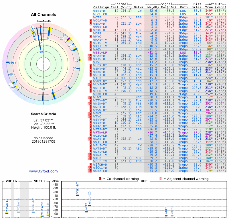

Attached is my channel list Most nights I can get all of these at the current 60' height this summer I will be moving to my new height of 90'. I was using an 8bay Channel Master clone with a CM7777 pre amp and was fairly happy with it except during the day I would usually lose half the channels. I am hoping 30 more feet of height will go a long way toward correcting this but if a better antenna can be had now is the time to do it! Attached is a picture of my current antenna and also a TV fool report at the EXACT tower location.

I believe this is your location and data from the rabbitears.info site.
You may notice the channel designations are different as rabbitears is a little more up to date with the repack than TVFool.
Height is your friend with deep fringe TV watching, but distance and weak signal power are your enemies.
You must not get high winds because the antenna is relatively high load design and it appears to be mounted maybe 10 ft above the top of the tower. Hopefully with your 90 ft tower you can mount it a little closer to the bearing.
TV reception, especially digital TV reception is more of an art than a science. The numbers only get you so far and the rest is by experimentation.
Most of your reception will be spotty at best, sometimes impossible, sometimes great. You receive at the whims of the atmosphere.
You do have one VHF high station 60 miles to your west on channel 13 but the rest are UHF and UHF is the least amenable frequency to "bending" over the horizon.
Best wishes.
