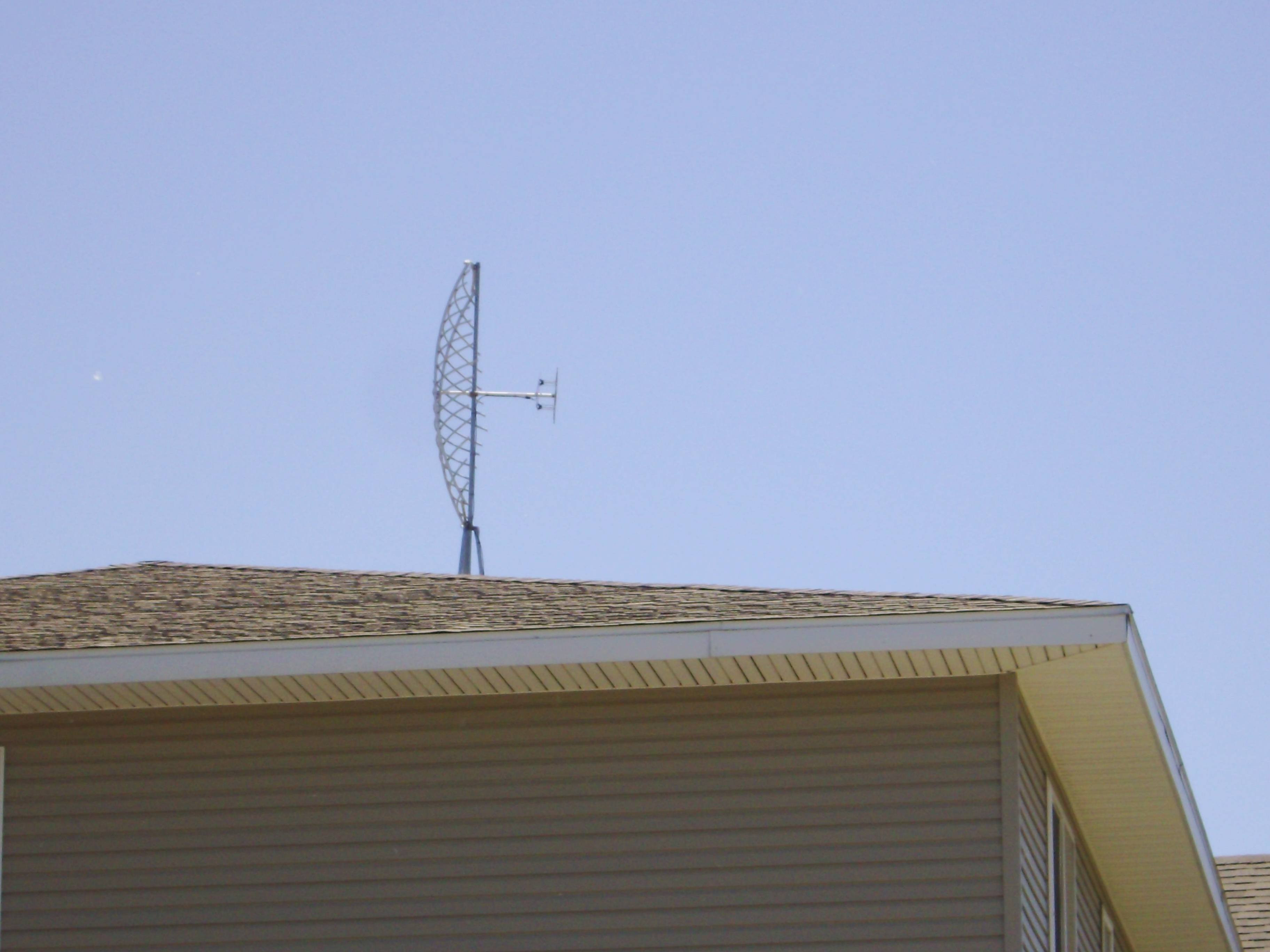

By the way here is the antenna I've seen on housing by the college. Too bad they can't be got anymore :(
