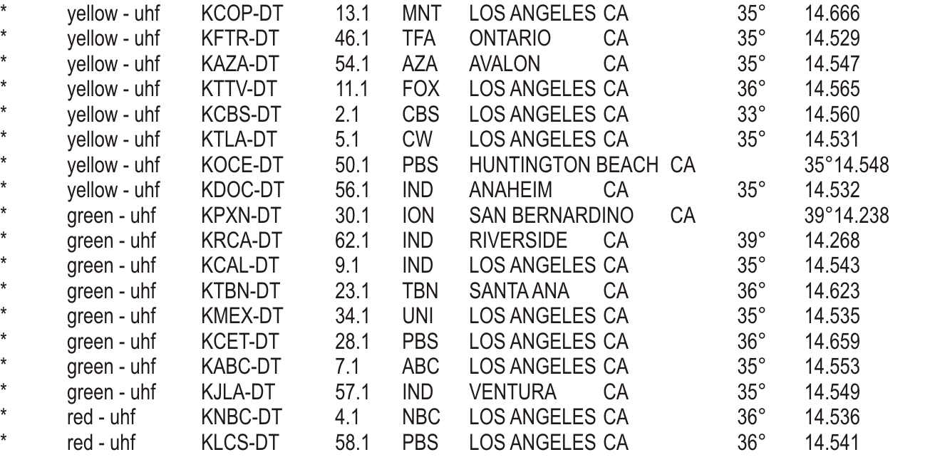

Looking for a suggestion for an exterior HD antenna for Metro Los Angeles. Live in a condo so I can't use a pole mount antenna because of the HOA. I'm looking at either the Winegard GS2200 Sensar III or the Winegard SS-2000 square shooter both of which can be mounted to the satellite pole. All stations in this area are UHF and all broadcast from the same antenna farm. Attachment shows the info from antennaweb.org.
Any suggestions/recommendations between the two or even suggestions of something else.
Thanks
Save you money and headaches from buying something so "gimicky" and get a quality regular antenna like the CM 4228 or CM 4221
