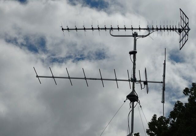

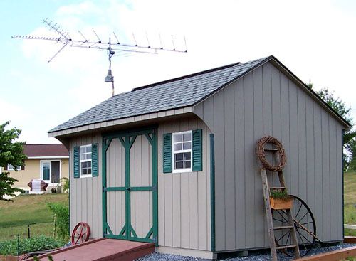

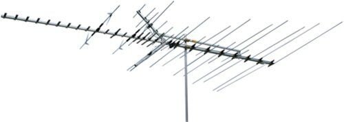

Forget the 751, way too small. No Omnidirectional antenna will help either. Few are line of sight either it is not hopeless here, but you have to think big. Height will be critical at least 30 feet. Do the VHF low stations interest you (Real channels 2-6), that will determine selection. You could get a real flamethrower VHF low and high/UHF and use a rotator with a good preamp. Option 2 is 2 antennas, without VHF low. A high gain UHF Yagi along with a high gain VHF high Yagi, combined together and run through a preamp. Tough location, have to watch out for preamp overload with those few close in station that are LOS. Attached is a photo of the 2 antenna idea, high gain Yagis for VHF high and UHF. And an all band Winegard HD8200U. Remember receiving 360 degrees means NO GAIN, there is a saying in the radio biz that Omni antennas receive equally poorly in all directions.
