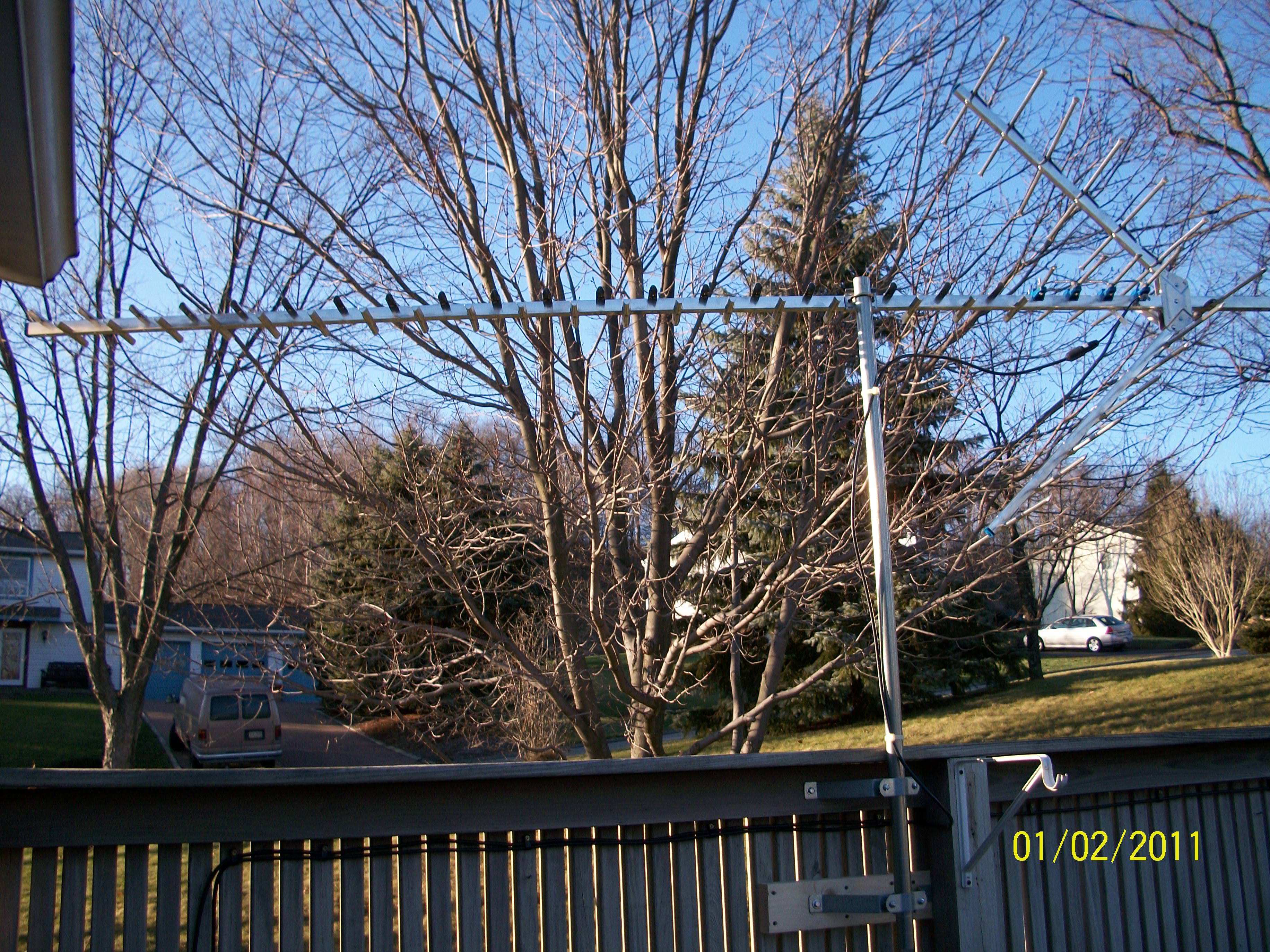

Just as Iceberg suggests, you need to get it higher. Maybe a gable mount at the top of your roof, or run a pole up the side of the house for the antenna is above the house. Trees will greatly reduce the signal. For the most part, UHF signals are line of sight and easily blocked. If it is very far off then a good quality pre-amplifier will also be needed. Check tvfool web site to see how strong of signal you can expect before going any farther. It should give you a starting point for what to expect.
I purchased a preamplifier and will eventually mount the antenna higher. Right now I'm receiving all the Pittsburgh channels with very good signal strength as well as several stations from Johnstown, PA approx. 54 miles away from my location in Gibsonia, PA. By mounting it higher I will be able to receive channels from Youngstown, OH as well.

I'm thinking about purchasing an Antennacraft 10' mast from Radio Shack this weekend (snow permitting) to replace the 4' mast my UHF antenna is currently mounted on in the back of my house on the deck. As you can see in the attached photo the antenna is just about touching the edge of my roof. Using a 10' mast the antenna should be just about the same height as if it was mounted onto the roof.
Question: Within the TV Fool website you enter the height of the antenna in feet from ground level. We live in a split level house where the ground is sloped, so in the backyard the ground is level with the second level. The antenna is currently located 9' high on the back deck. Would you consider the antenna to be 9' high or 18' high (9' from driveway to second level and 9' from second level to antenna)? I say 18', but my wife argues 9'. :)
It does not matter because it is just not high enough!!!... :p

Before getting a longer mast, try going up on the roof and hold the antenna or rig a temporary mount to see what improvements it will make. From your pictures, 10 feet will not make a difference. You need to get up higher, hopefully above the trees. First try at the peak of your house roof to see if that makes any difference.
Uneven terrain is hard to judge, but I would measure from ground level where the antenna is located.
Last weekend when I first installed the antenna I had it 8' high and a station from Johnstown, PA approx 53 miles away was received with a fair signal, but with breakups. I then raised it only 1' to 9' high and this channel was received with a good signal strength with no breakups. Every little bit counts on receiving a better signal.
