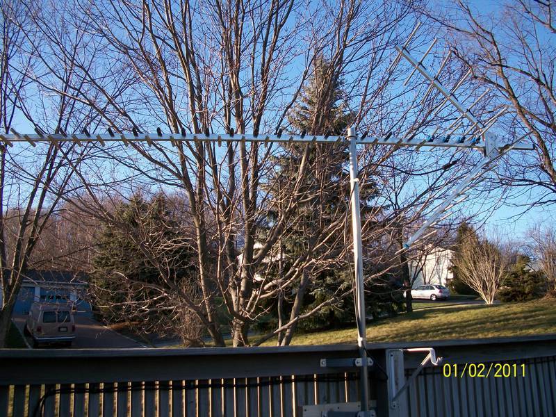

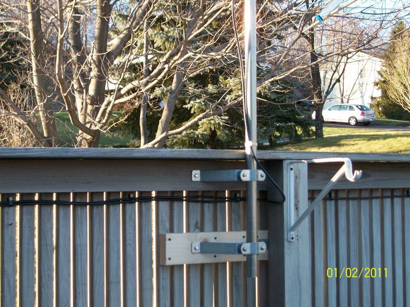

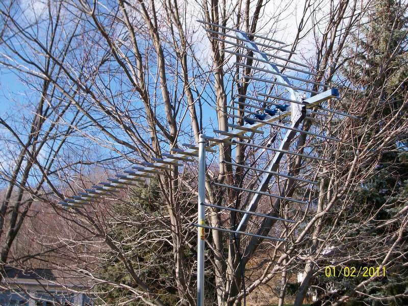

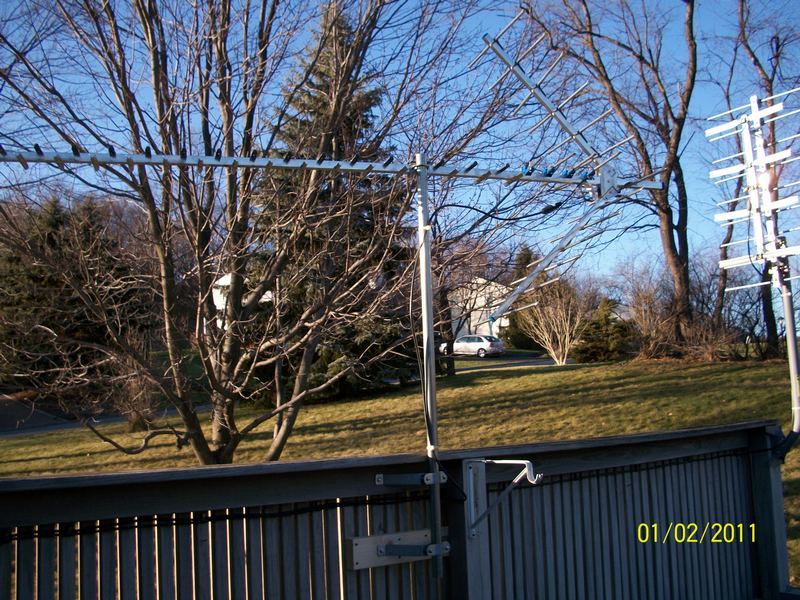

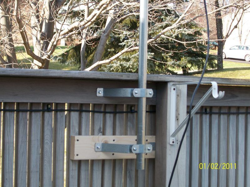

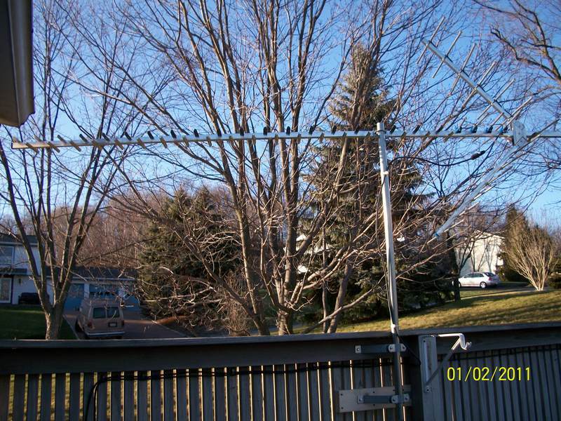

I took advantage of our 30 degree sunny day today and installed the Antennacraft MXU59 UHF antenna that I received for Christmas. Not only does it receive local Pittsburgh channels, but also channels from Johnstown, PA and Youngstown, Ohio that are approx 55 miles away.

The MXU59 tends to get overlooked in a world full of XG-91s, HD-8800s, 4228s and HD-9032s, yet just about everyone who's posted their experiences with this antenna raves about it. Thanks, Pop! :up

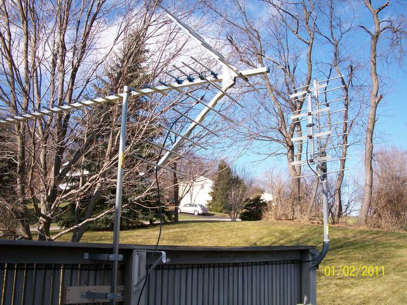

I also took signal strength comparisons of our local Pittsburgh channels using the Antennacraft MXU59 UHF antenna vs the TerkTV32 UHF antenna in their current location as pictured below. I was surprised to see how well the TerkTV32 performed.

Tomorrow's Project
My project tomorrow (if it doesn't snow again) is to do the following:
1) Install the Antennacraft MXU59 UHF antenna onto the 10' mount in the corner of the deck 3' off deck floor (13' high) where the TerkTV32 UHF antenna is currently located. This will raise the antenna 4' from it's current height of 9'.
2) Install the TerkTV32 UHF antenna onto the current 39" J mount where the Antennacraft MXU59 UHF antenna is currently located.
3) Properly ground both antennas using #8 wire from masts to grounding rod as well as install a dual grounding block for the coax.
Because the TerkTV32 UHF antenna receives our local Pittsburgh channels very well it will be used to receive the Pittsburgh channels. The Antennacraft MXU59 UHF antenna will be adjusted to receive either Youngstown, Ohio or Johnstown, PA channels.
Eventually, I will install a preamplifier onto both antennas and combine them creating a solid state antenna setup receiving channels from two different locations.

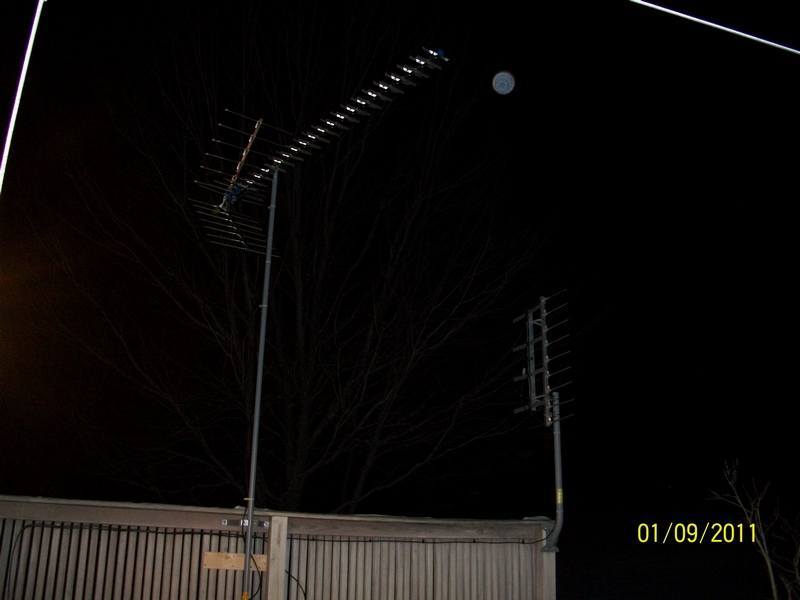

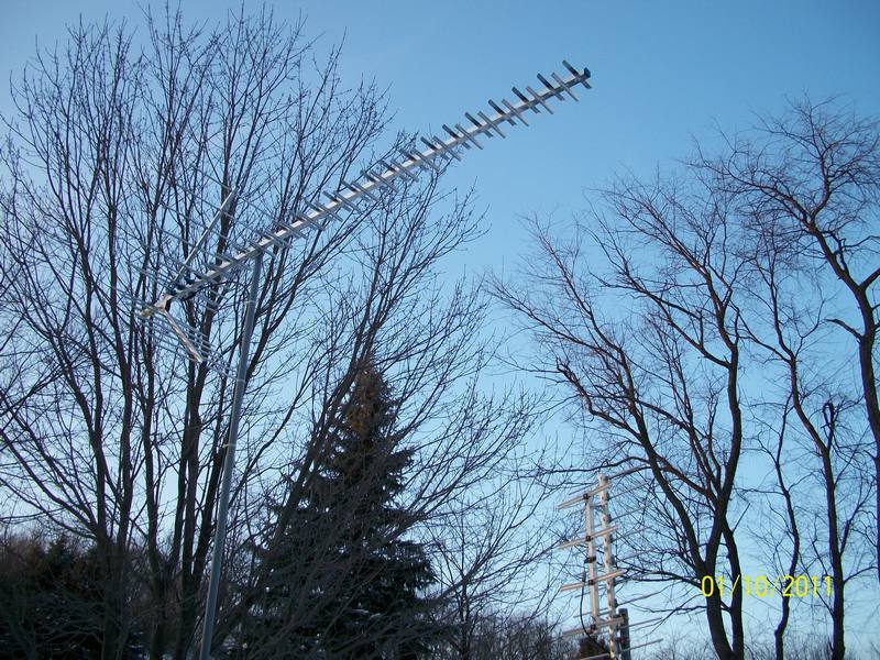

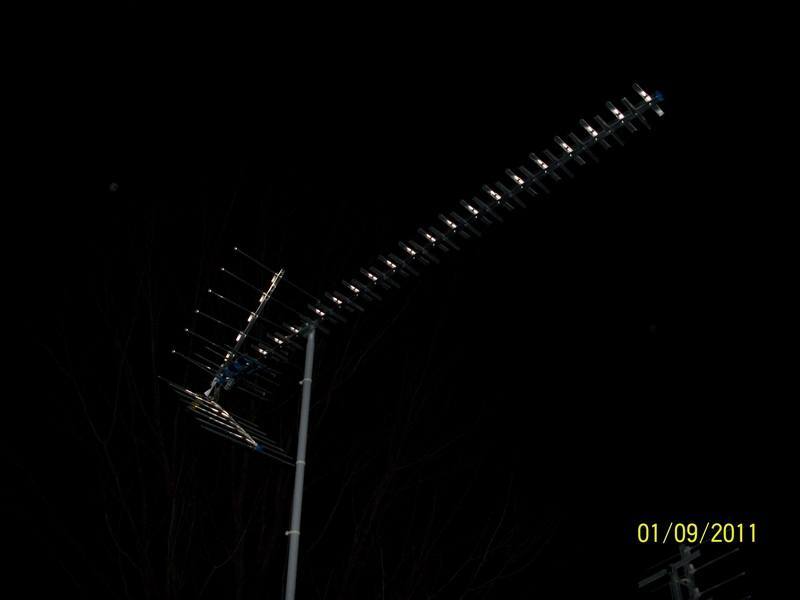

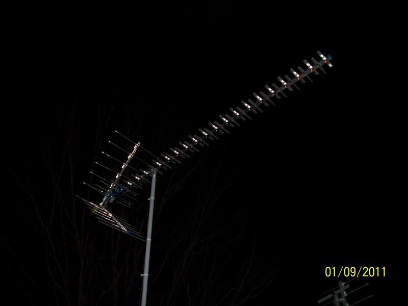

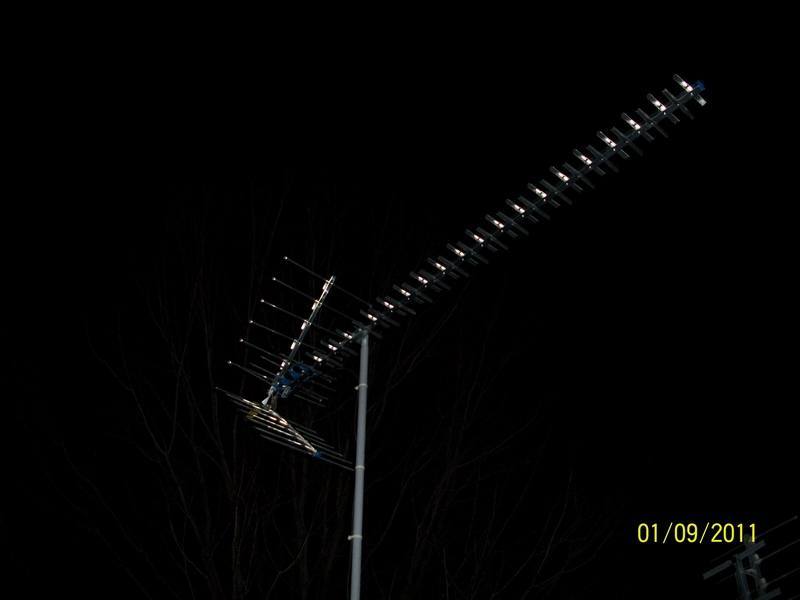

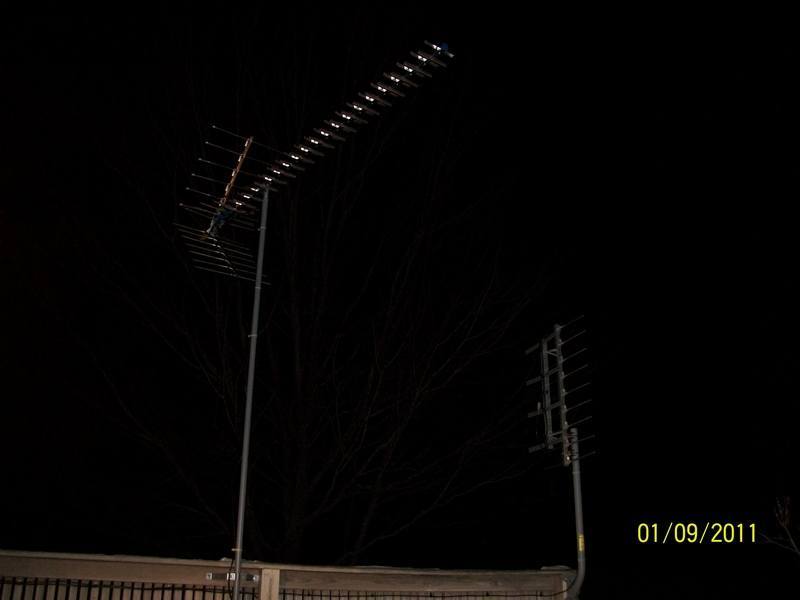

Update: JAN 09 2010
Because it was still snowing today and we had a high of only 24 degrees, I simply replaced the mast of the Antennacraft MXU59 UHF antenna that raised it another 4' and aimid it towards Johnstown, PA. The signal from Johnstown went from fair to good with a signal strength of 72.
Due to the cold weather I didn't ground the dish, but will as soon as it gets warmer and the snow melts.

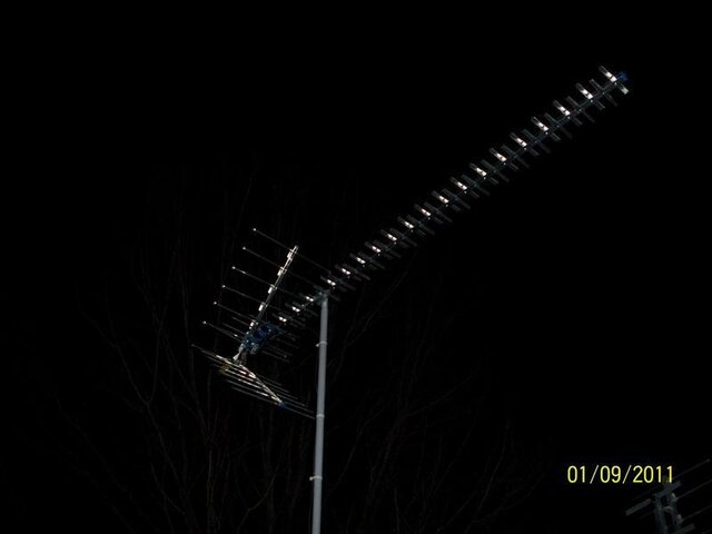

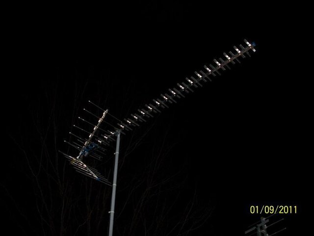

Attached are some nite pictures I took of the antennas.

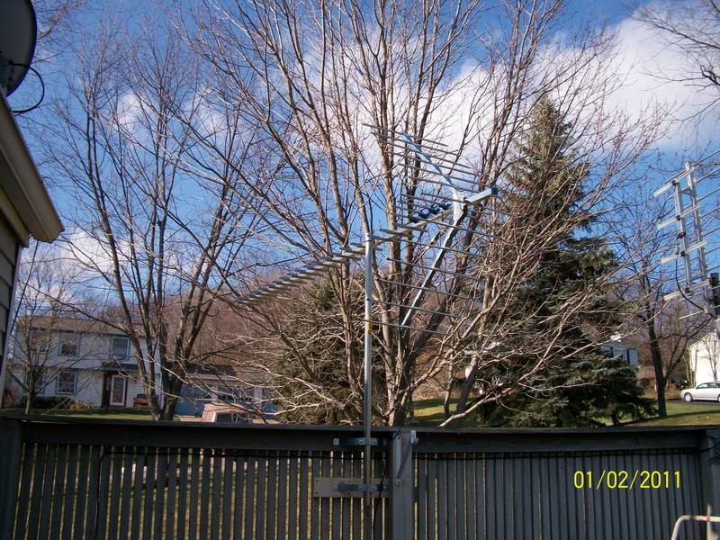

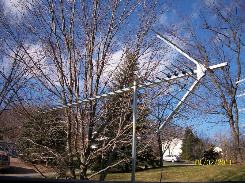

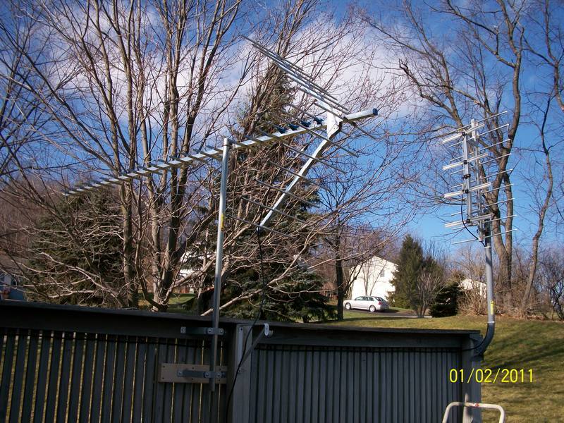

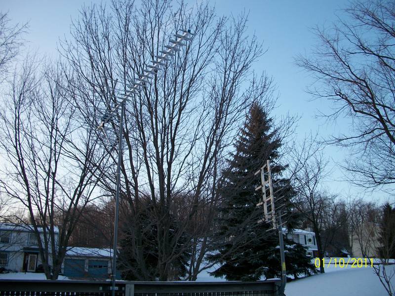

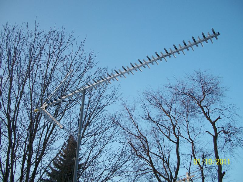

Daytime Shots
Daytime pictures attached:
