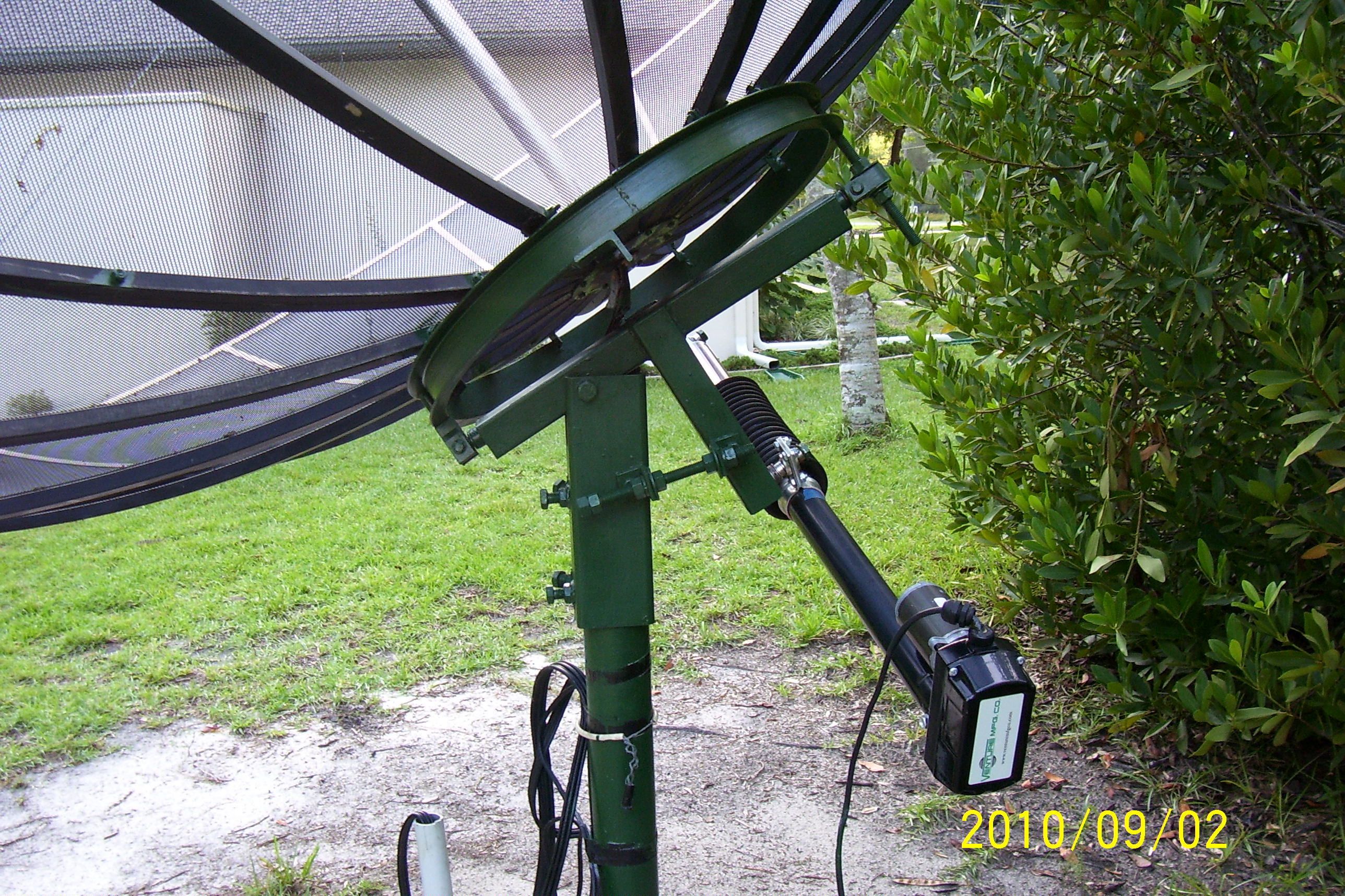

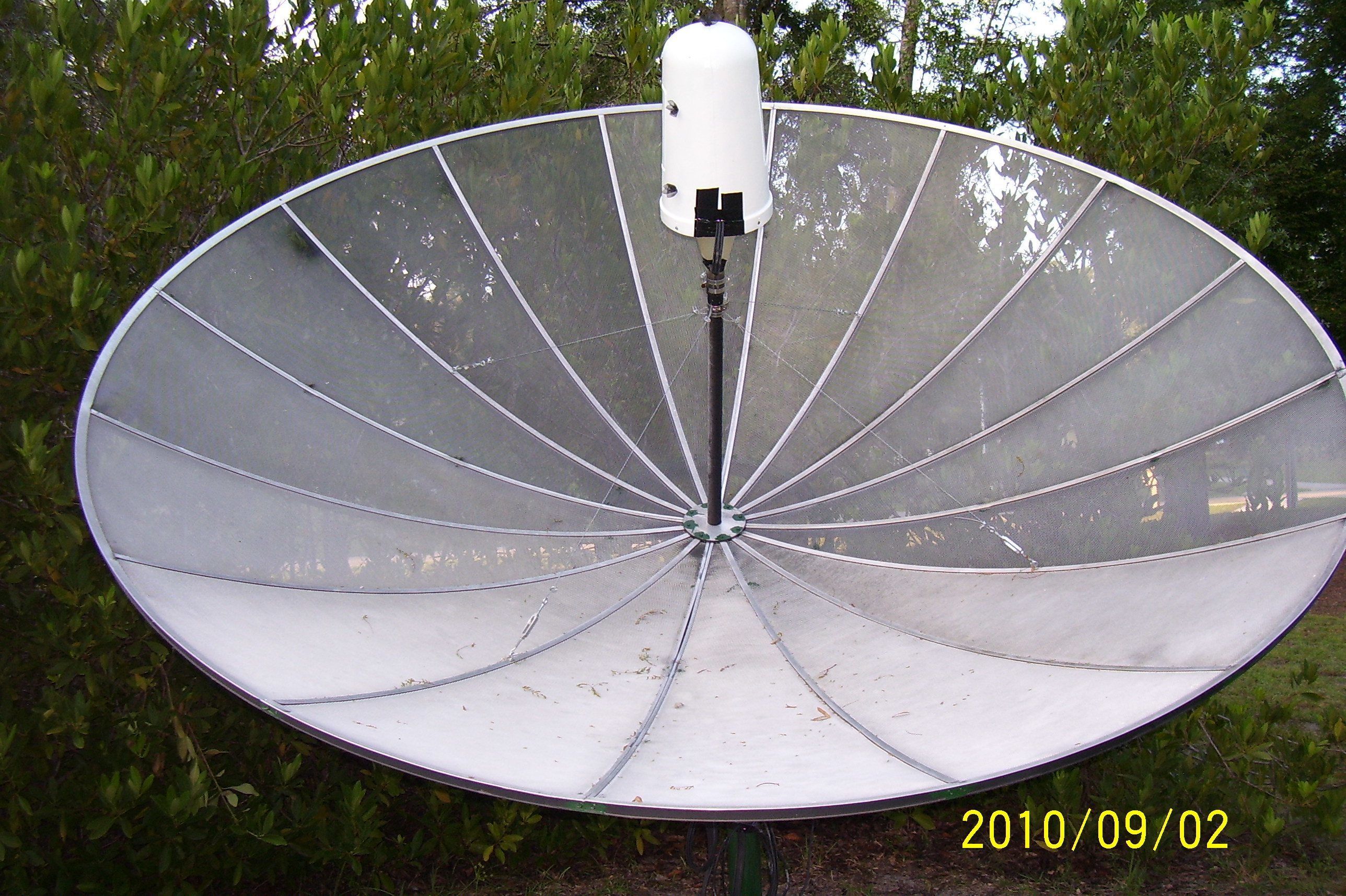

Some pictures of my 10' working bud. For me it was an 8 month nightmare.
I give credit to Fat Air and Stanleyjohn for getting this project working.
See the attached photos.
I dread the thought of going through this again in the event of another tree falling on the dish, hurricane, lightening strike or whatever.

Thank you Stan,
Wish it was a 12'er but I by myself would never been able to handle it.
This is a nice compromise.
Now if could only paint it hunter green. But I think the heat down here
would fry the lnbs.
NICE! Doesn't look to be a hail ding anywhere, unlike mine. (Don't look too close)
(???) Oh-Oh, Thinkin' here, maybe if you paint the backside, the color may be visible, but not so that it absorbs the suns rays(???) just thinkin. If that's raw aluminum, I would put a coating of something on it. Maybe the hunter green won't be so bad. Paint a test piece of metal with it, and a piece flat white or light grey. set in the sun, and check temps .(????) Just thinkin.

Looks great! Like the cable supports for holding the mast in place. I might utilize that idea on one of my dishes. My 10' solid picks up the S2/8psk signals very well on C-band (and Ku), so I don't think I would ever "need" anything bigger. You will be happy with your setup for sure!
-C.
Thanks guys for the kind words.
Most of the credit goes to Fat Air and his experience.
I had trouble with expansion and contraction of the guys wires
when they were connected to the outside of the dish.
Moving them in 2' on both sides cut that way down.
They seem to be pretty stable.
