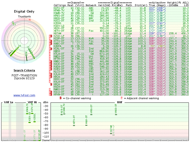

AntennaWeb is very conservative in its recommendations. I'd like to take a look at what TVFool says -- it's more precise as well as more technical -- but, like AntennaWeb, it relies on location. Can you provide a ZIP code?
Thanks Don_M for the response. My zip is 92129. Looking at TV fool myself it looks like all the LA channels are in the red and I'm about 100 miles away from Mt. Wilson.

Ouch... 103.4 miles, to be exact. The attached file shows the post-transition TVFool report for your ZIP code, which is arranged in order of strongest station to weakest. Basically, the first half-dozen channels show signal strengths in rabbit-ears (or Silver Sensor) territory. From there, the signals get half again as weak with each 3-point step down the scale in the dBm column. The pre-transition report for KCAL's temporary signal on channel 47 is even worse by about 10 points. Catch my drift? You might be able to get KCAL-DT on channel 9 in four months, but only by going outside and high above your roof -- at least 30 feet, and quite possibly more. Even at that, you'll probably need an expensive single-channel antenna and a high-gain pre-amp.
Pestering the satellite provider isn't likely to get you far, either. I'll bet they consider your area to be outside the LA market. If that's the case, they can flatly refuse your requests with no fear of regulatory repercussion.
Sorry about that, amigo.
