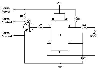

If you are able to, or have a friend that can do so, you can build your own servo controller from this simple schematic:
http://www.aaroncake.net/circuits/servocon.asp
Parts
Part..Qty.....Description
R1.. 1.... 820 Ohm 1/4W Resistor
R2.. 1.... 68K 1/4W Resistor
R3.. 1.... 10K 1/4W Resistor
R4.. 1.... 1K 1/4W Resistor
R5.. 1.... 1K Linear Taper Potentiometer
C1.. 1.... 1uF 16V Electrolytic Capacitor
Q1.. 1.... 2N3904 NPN Transistor (or use a) : 2N2222, Most Small Signal Transistors
U1.. 1.... 555 Timer IC
MISC.1.... Perf board, Wire, Knob For R1, 8 Pin Socket For U1
Notes
1: R1 adjusts the skew position of the servo.
2: Connect the servo to the circuit as shown in the schematic. For common Futaba servos, the red wire is power, the black wire is ground, and the white wire is control.
That circuit is as simple as it gets.
