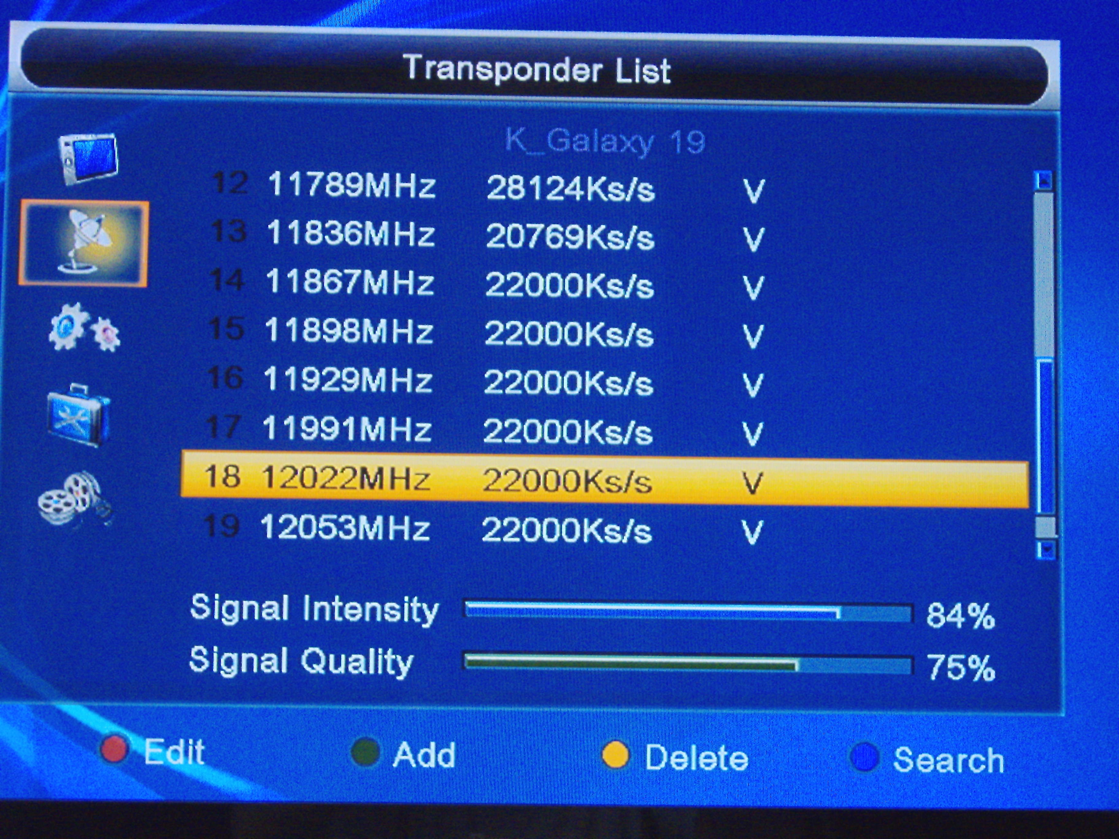

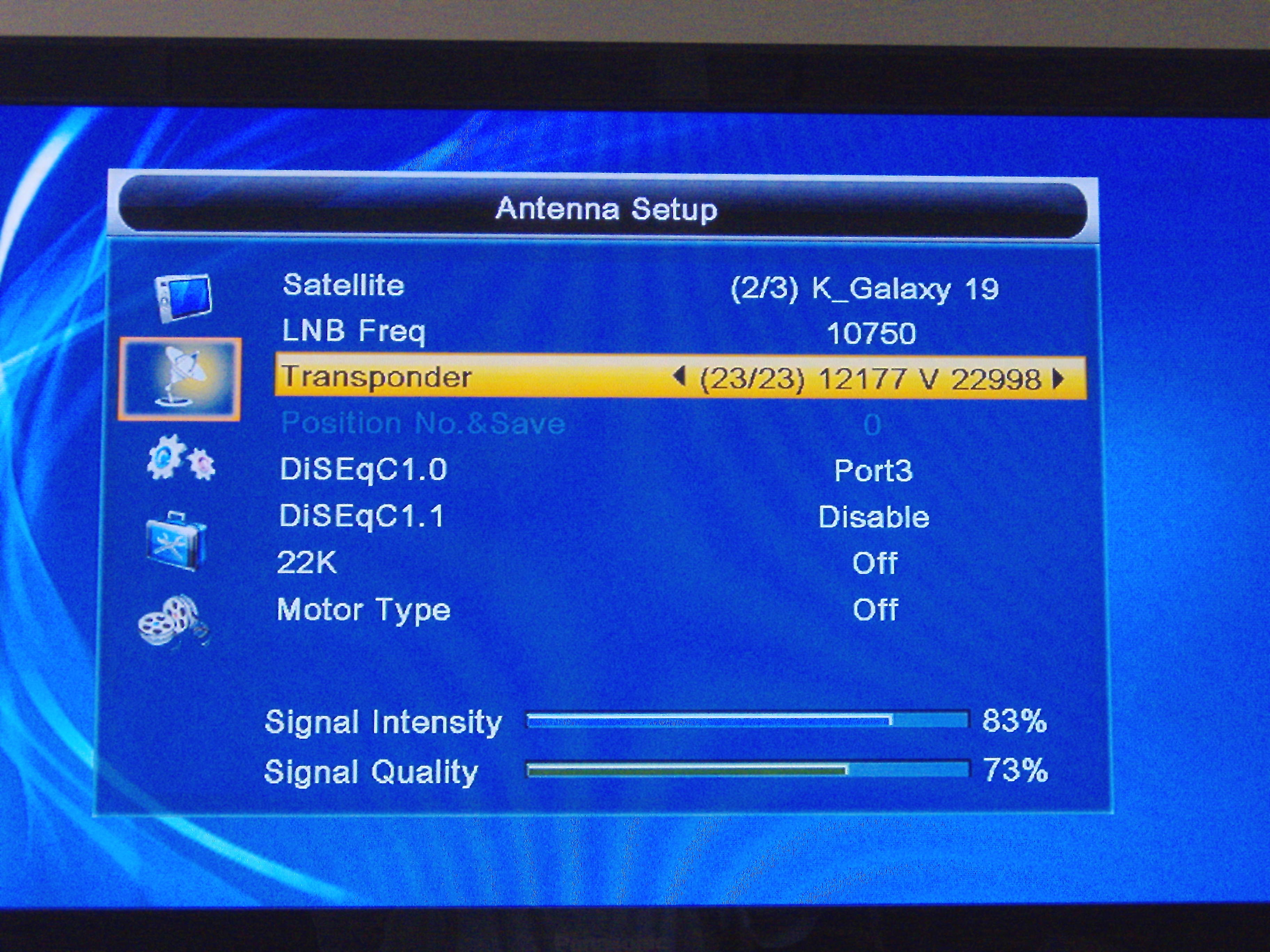

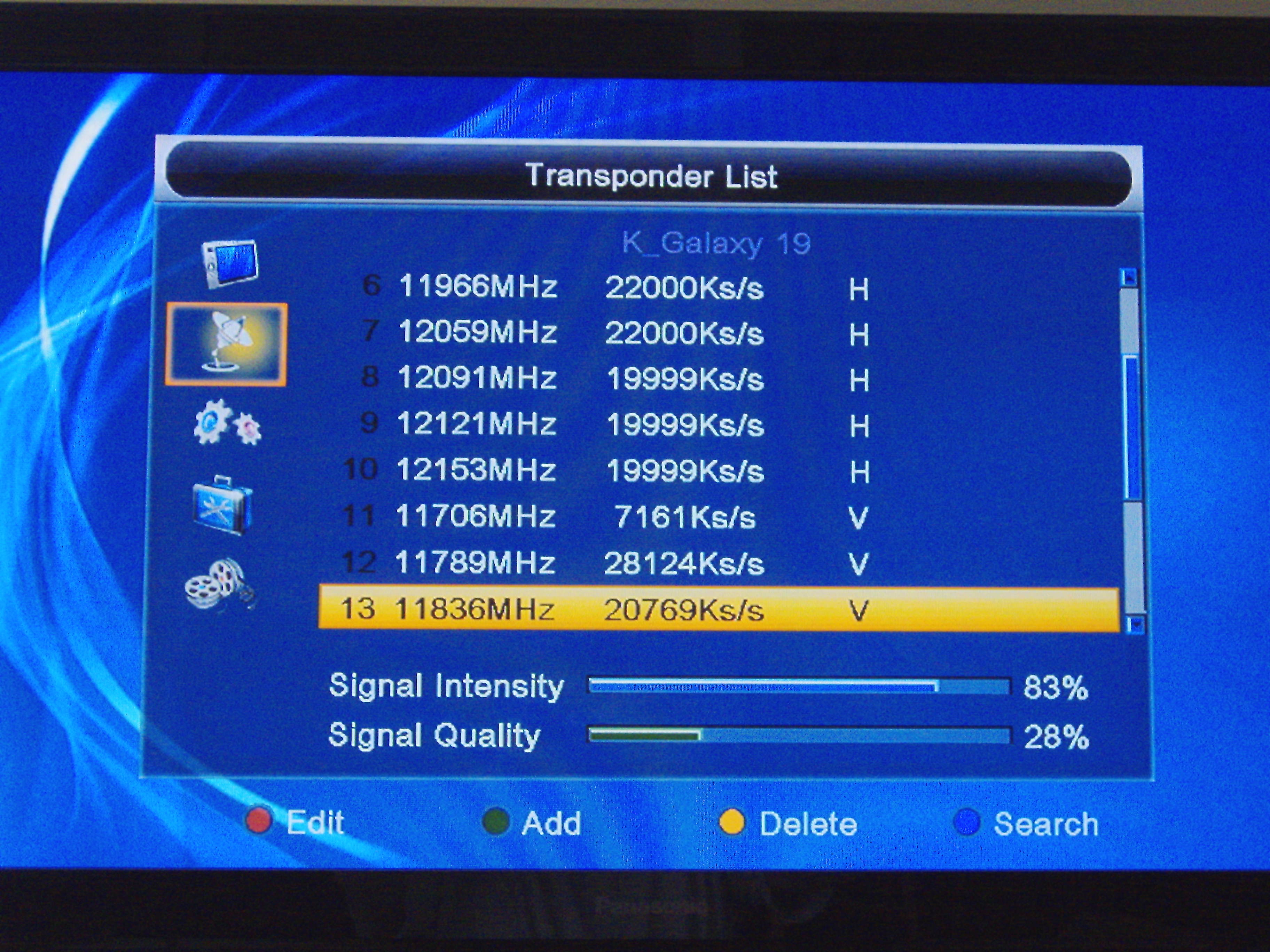

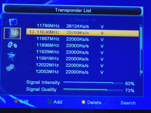

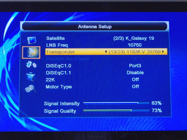

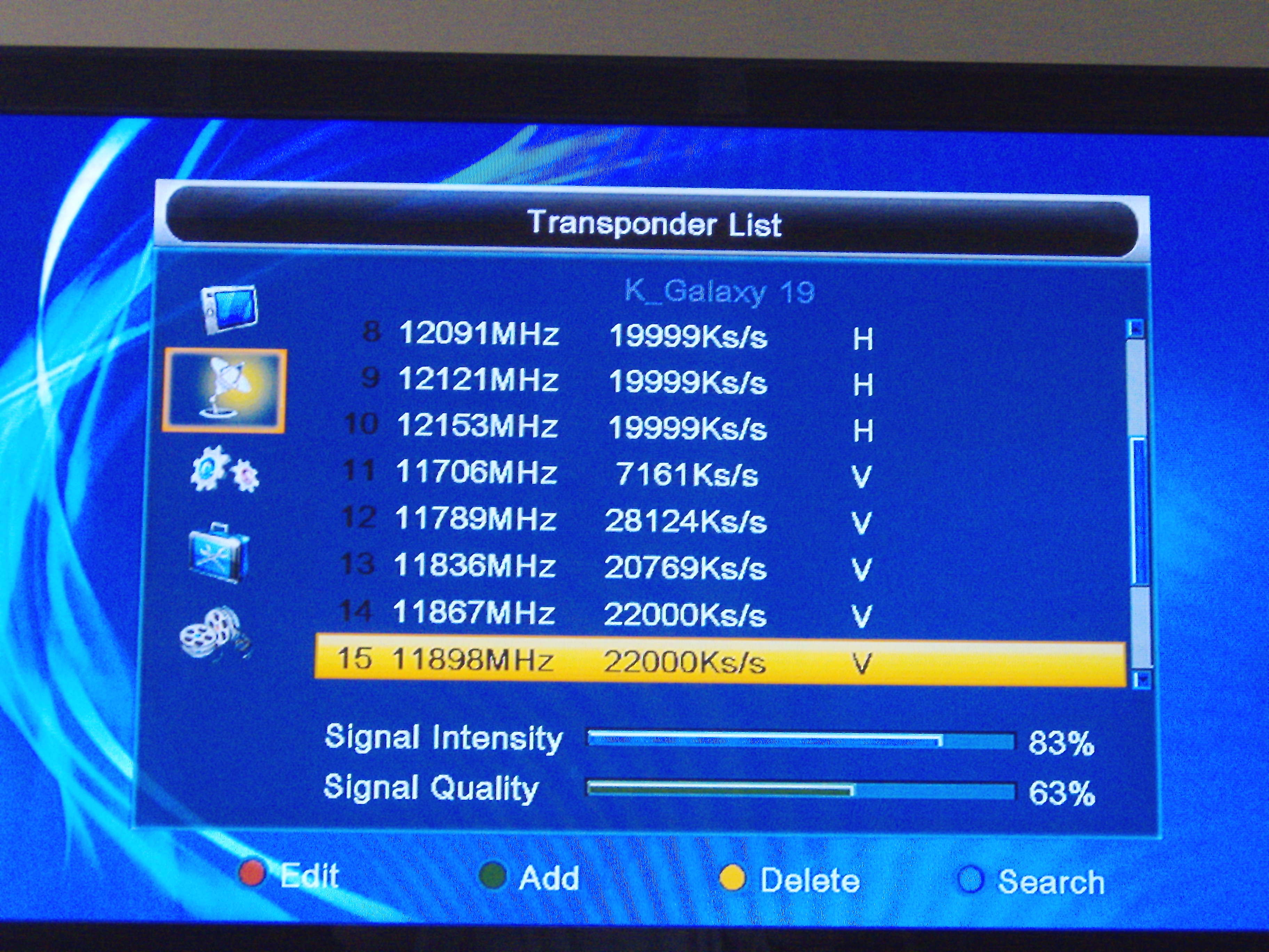

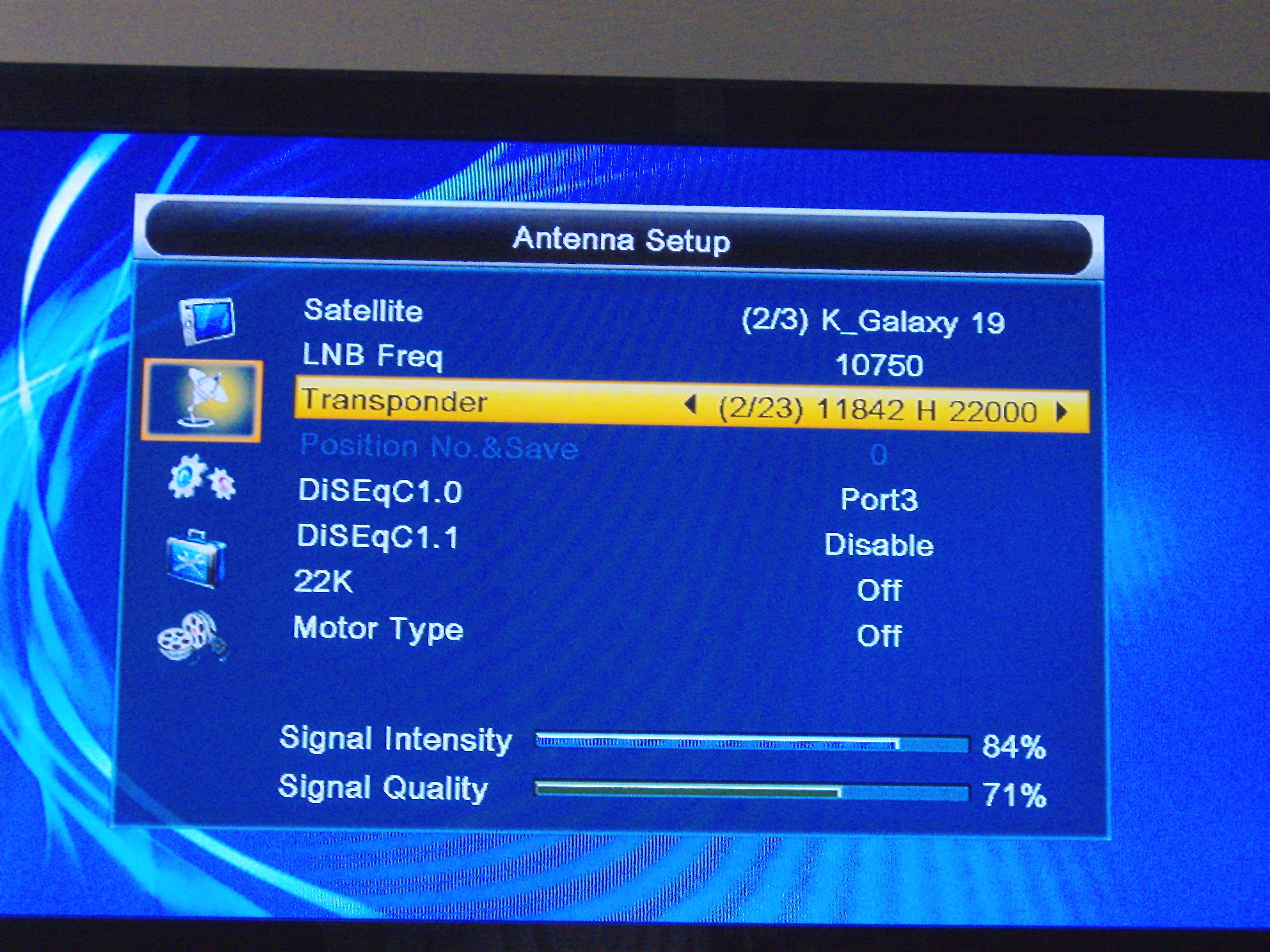

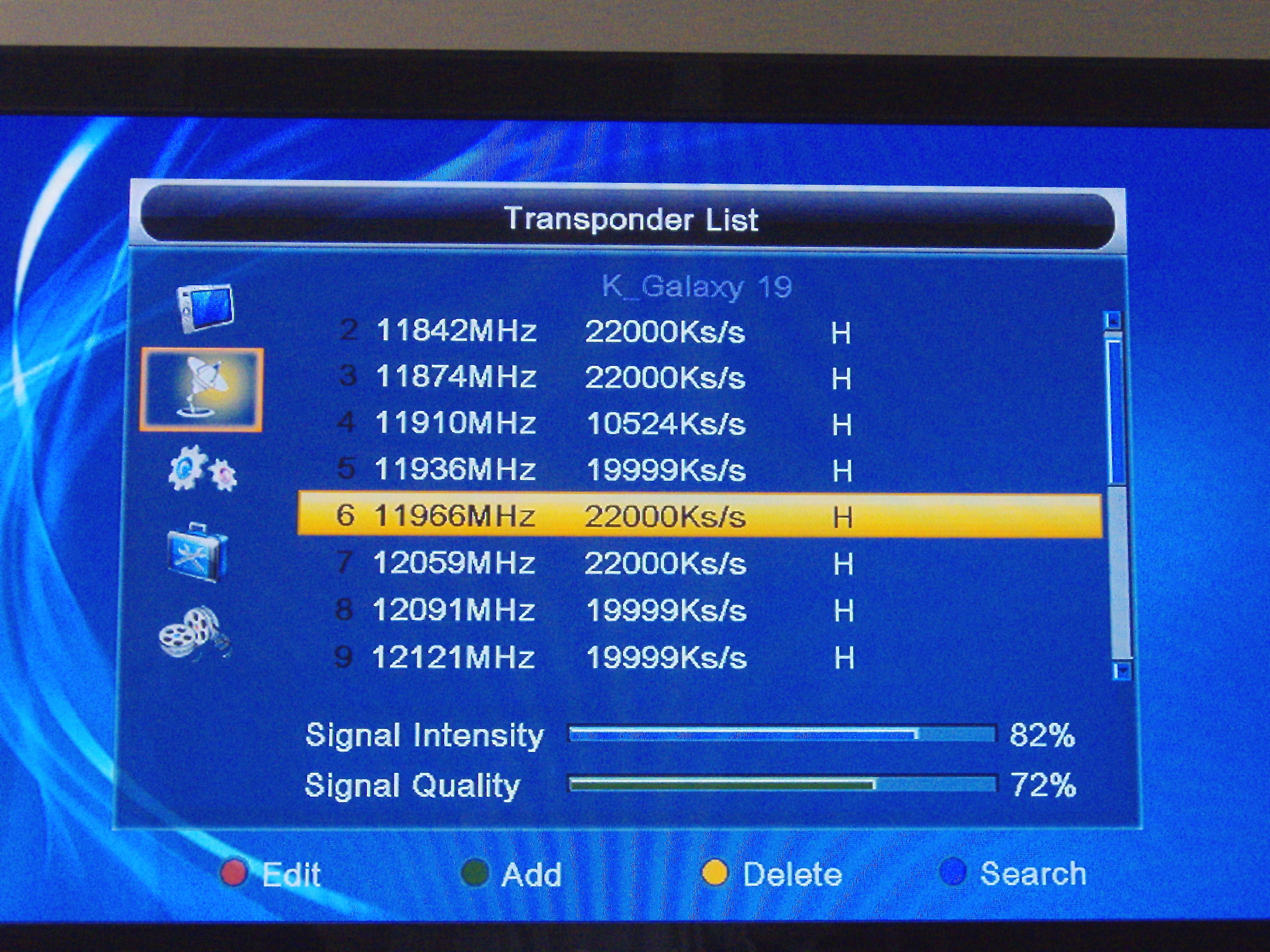

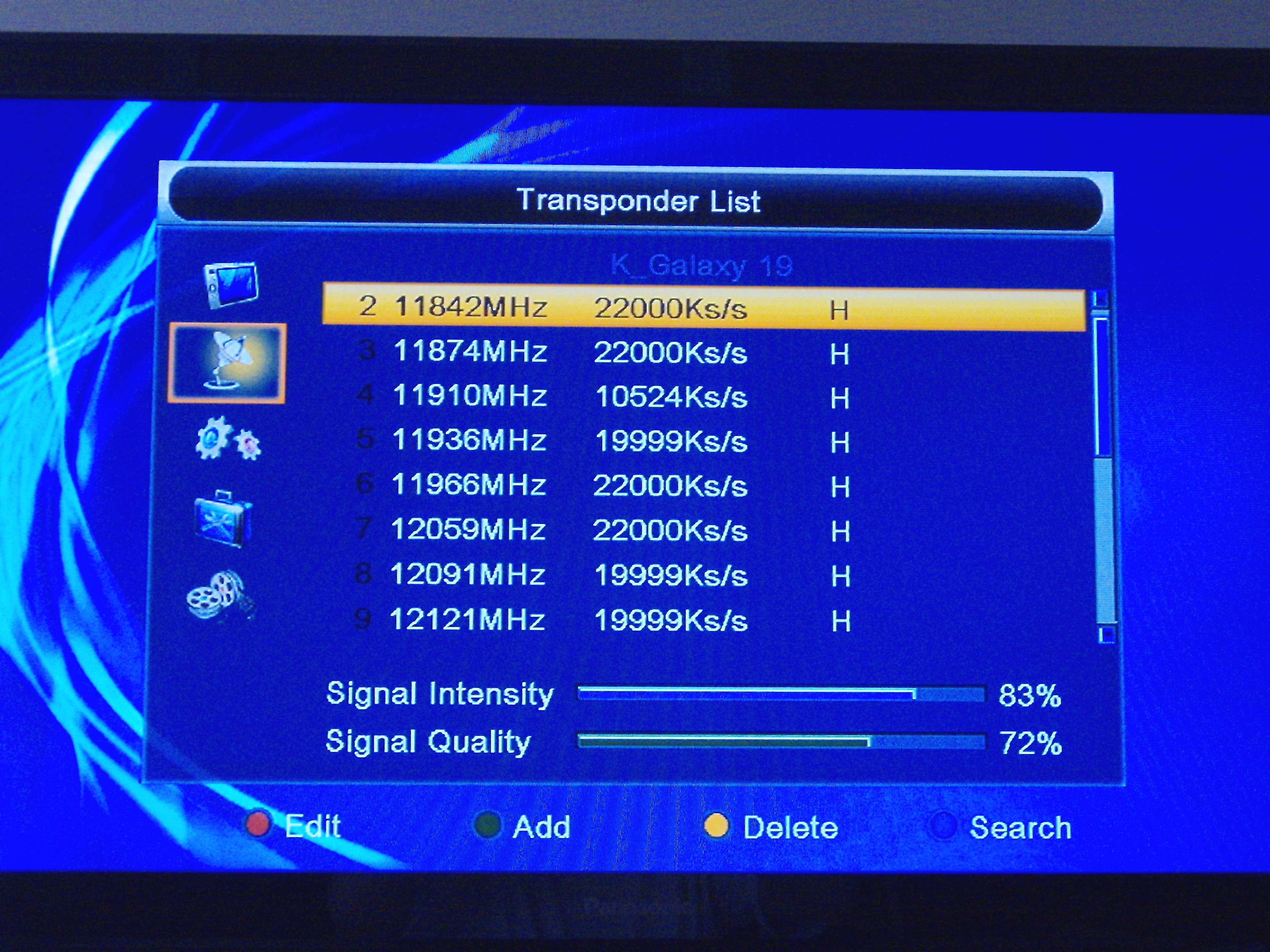

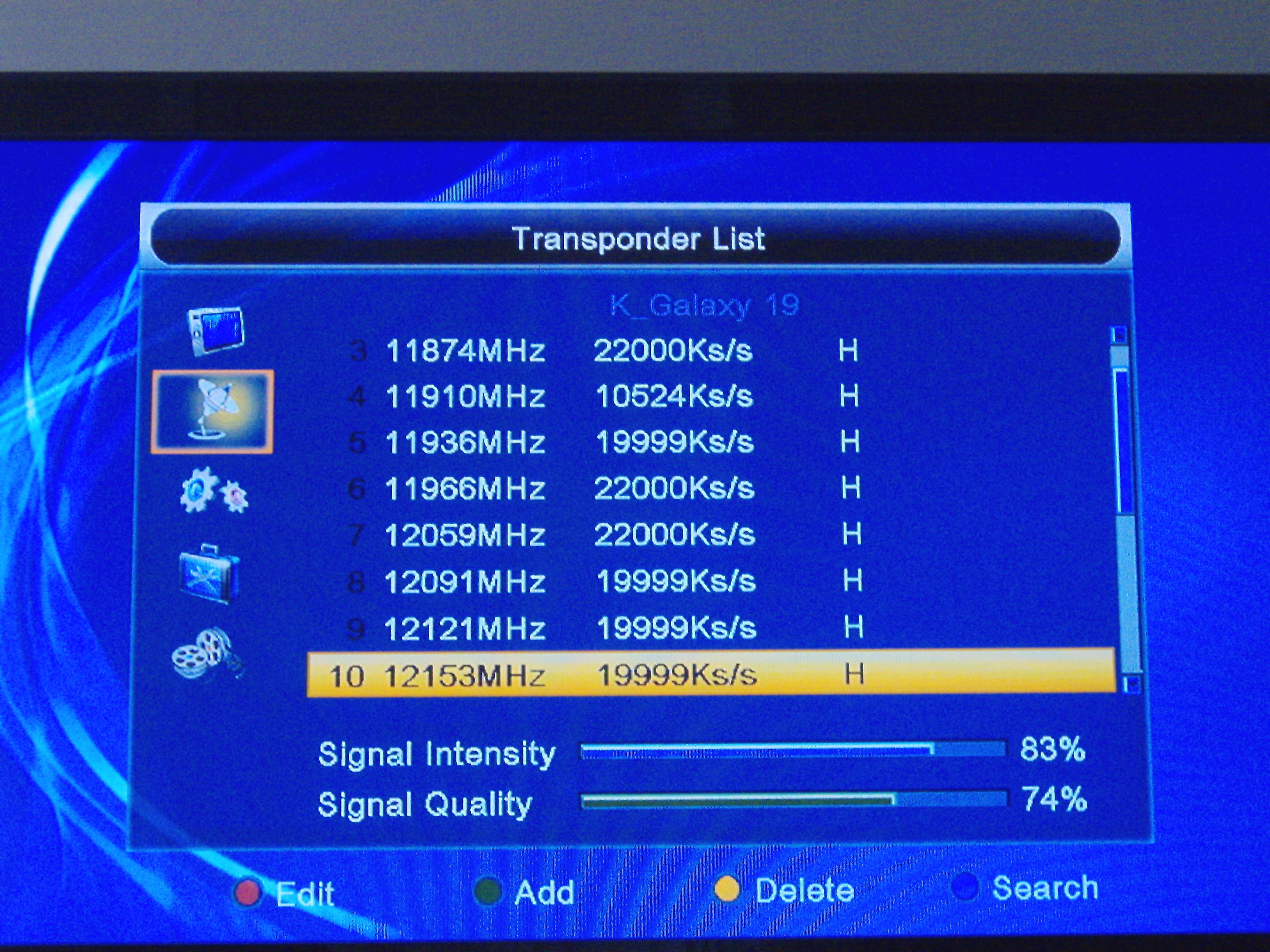

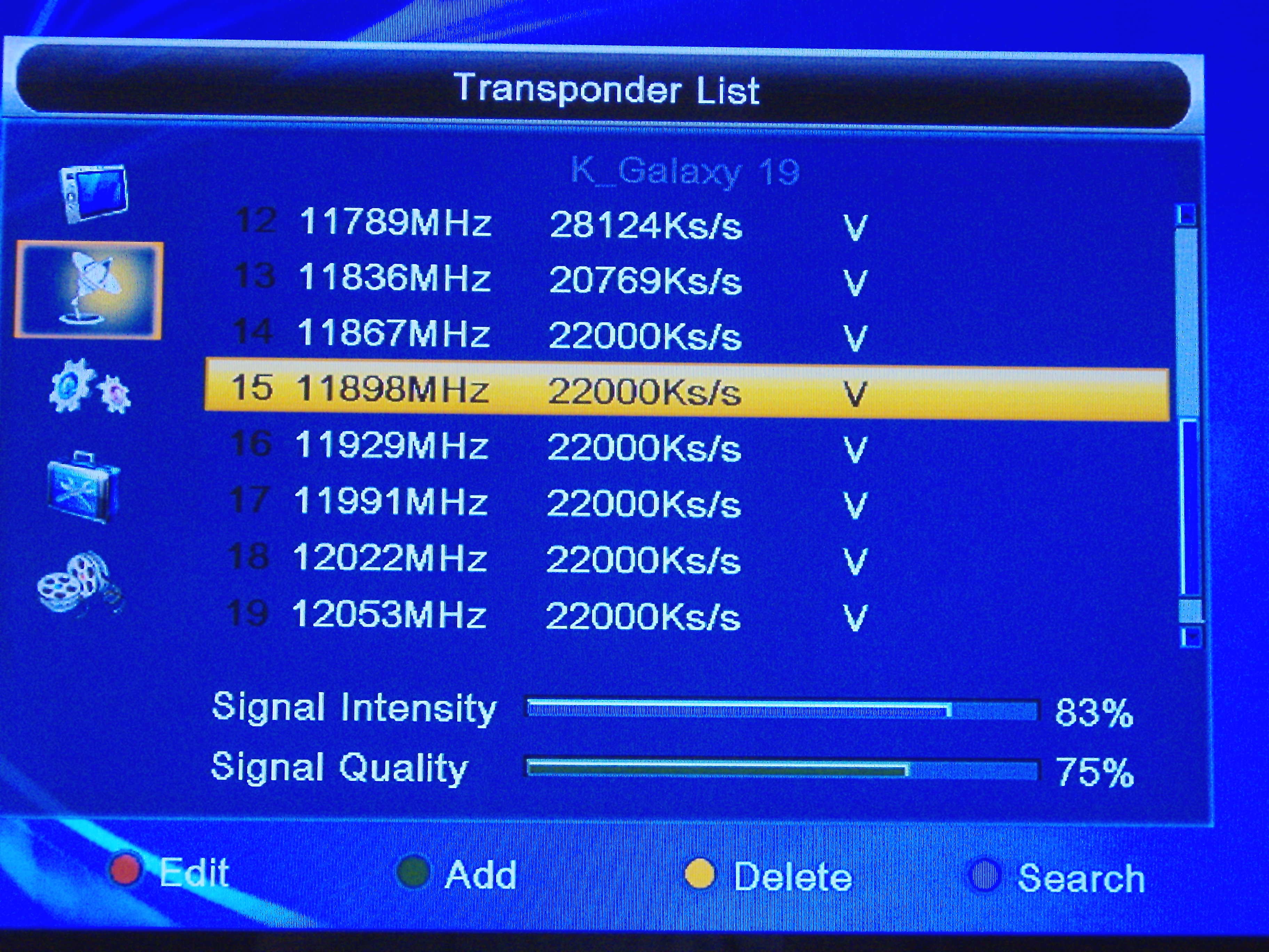

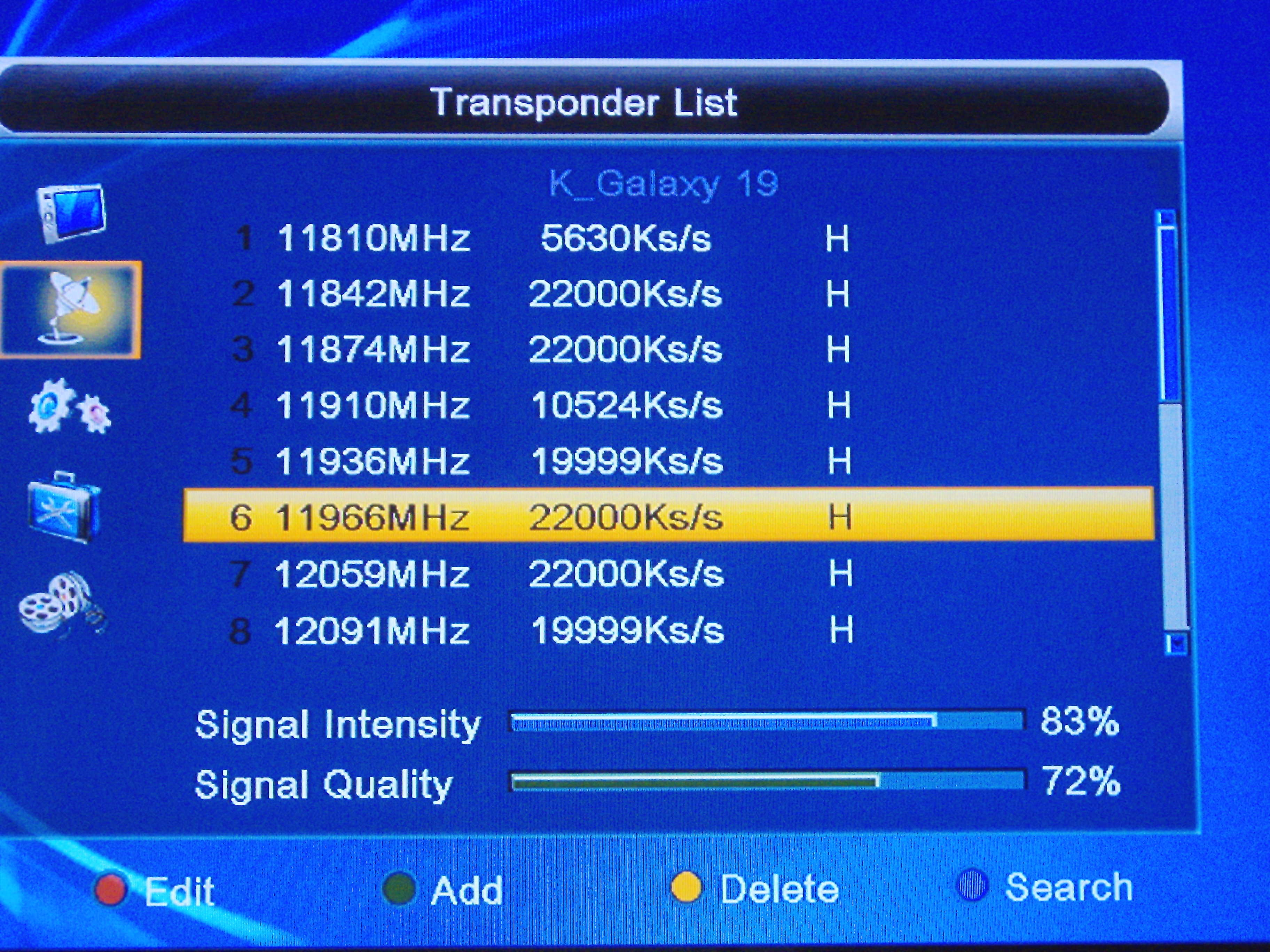

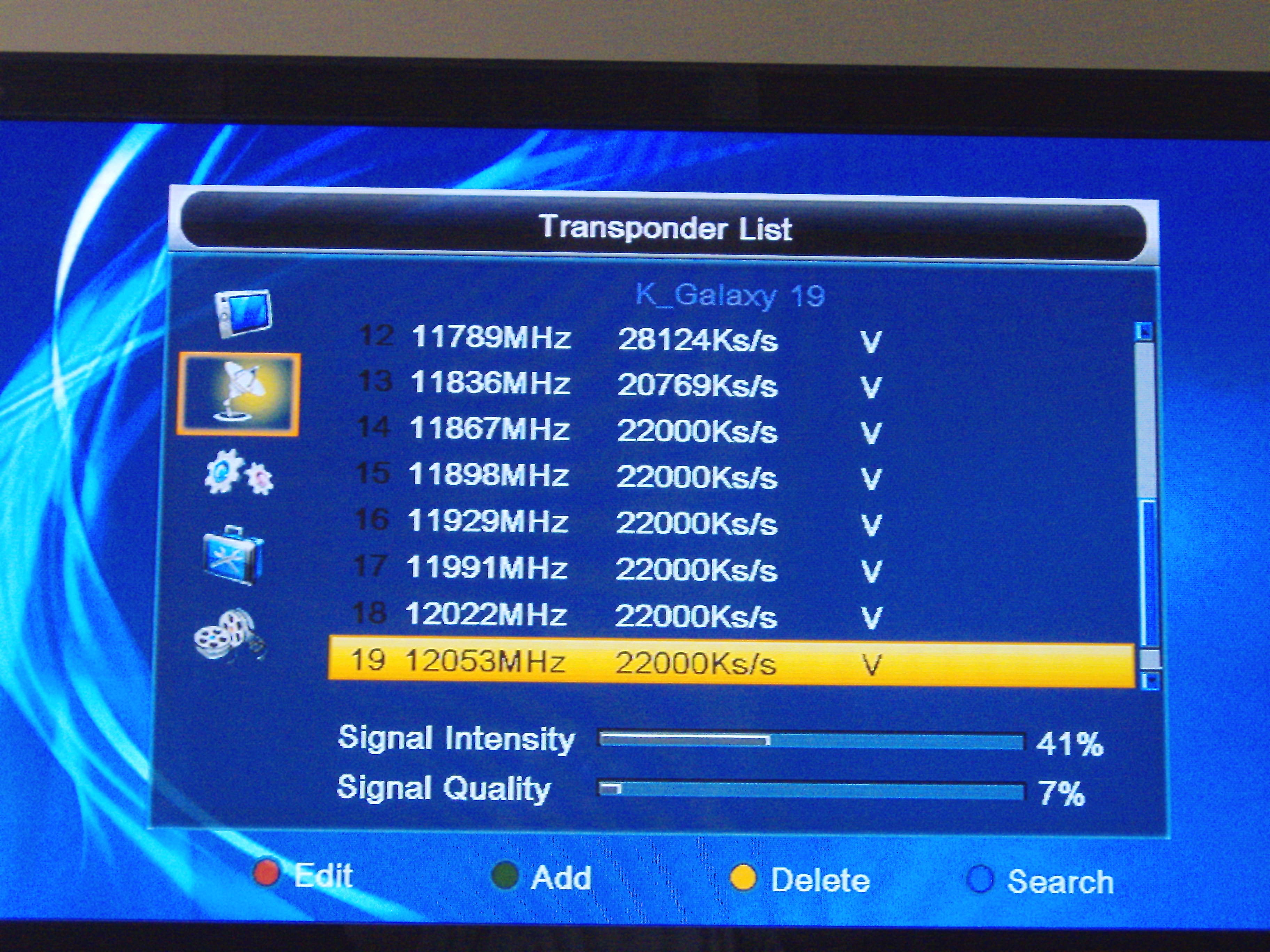

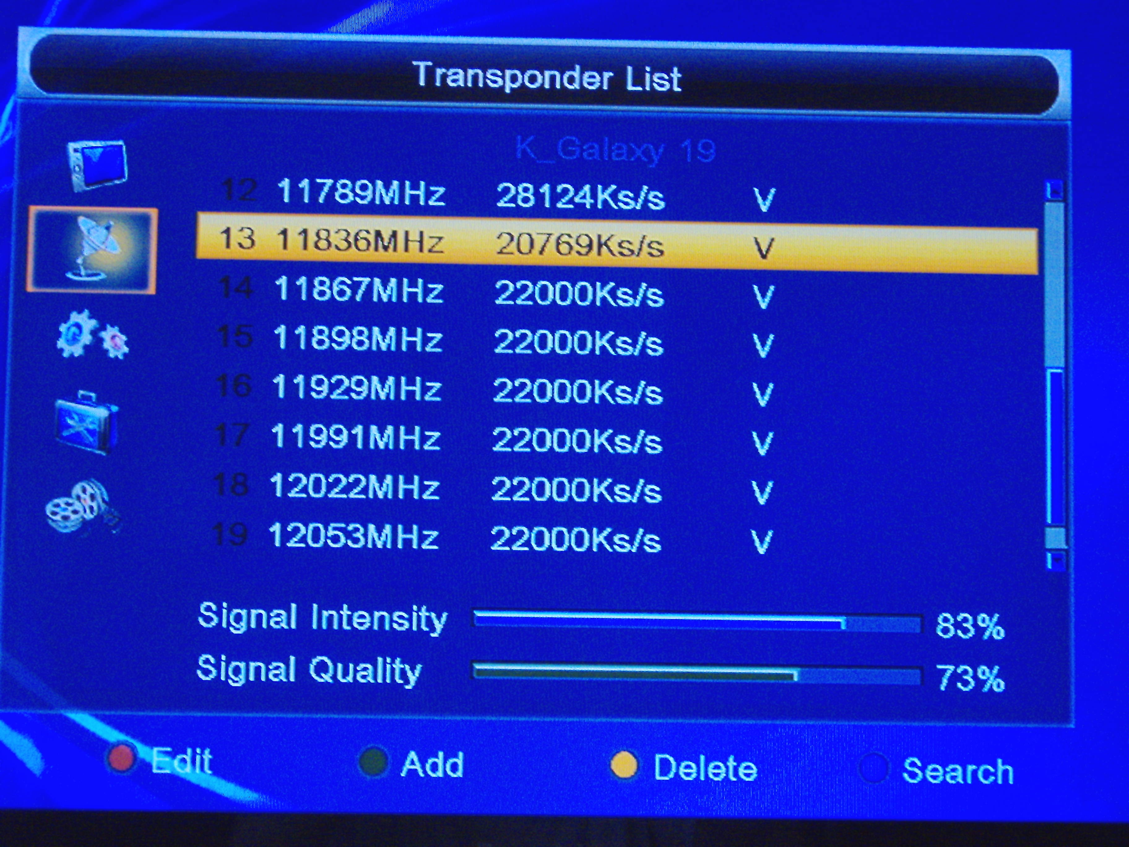

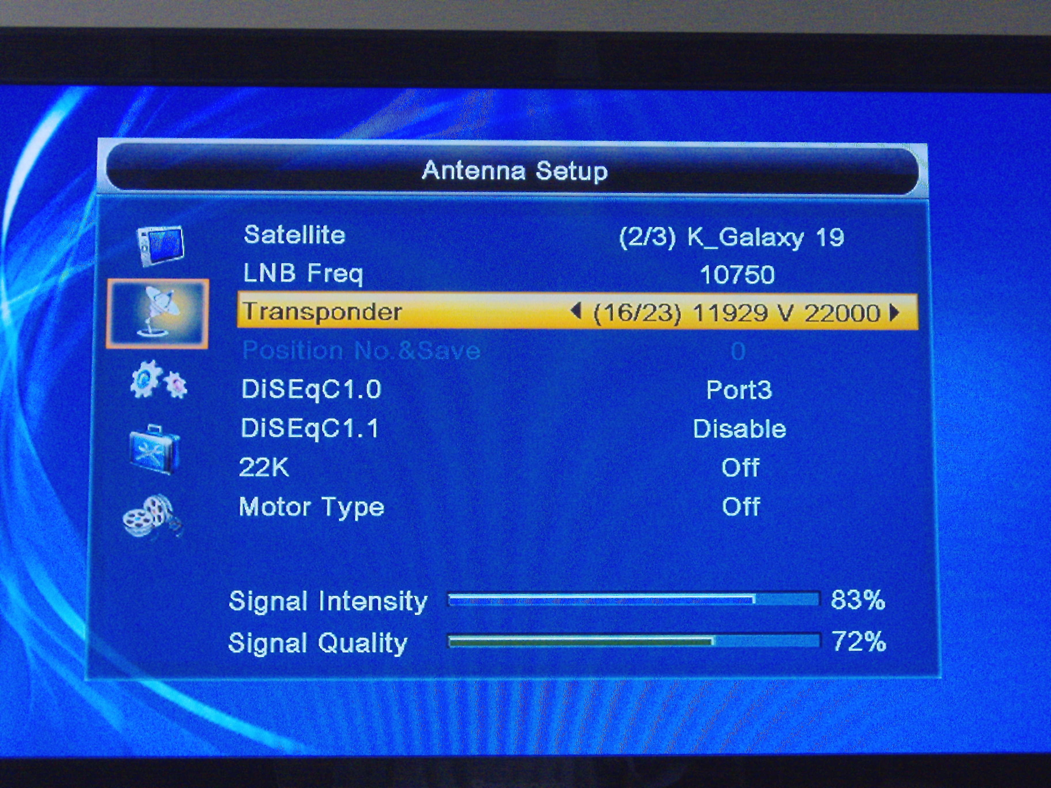

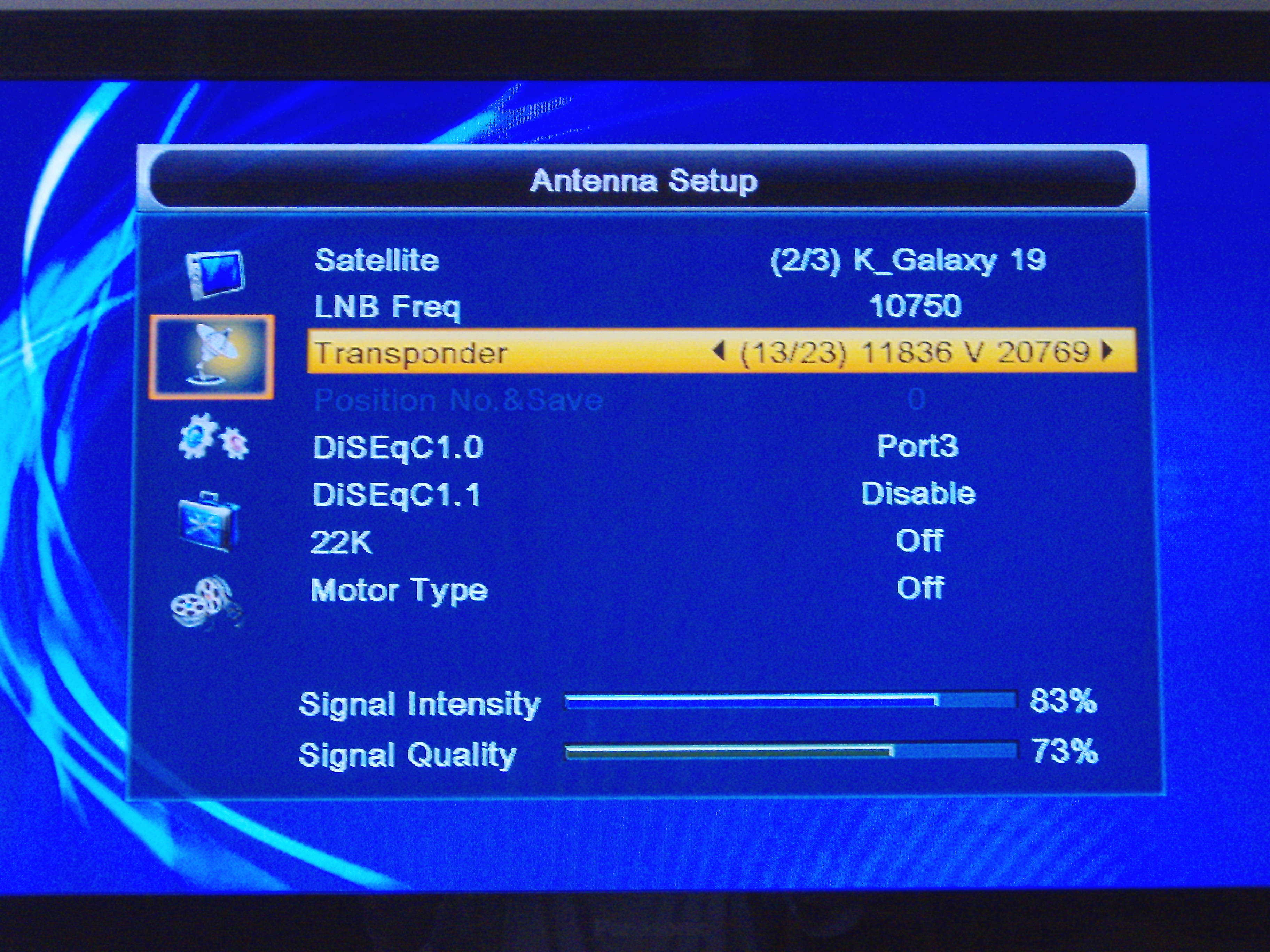

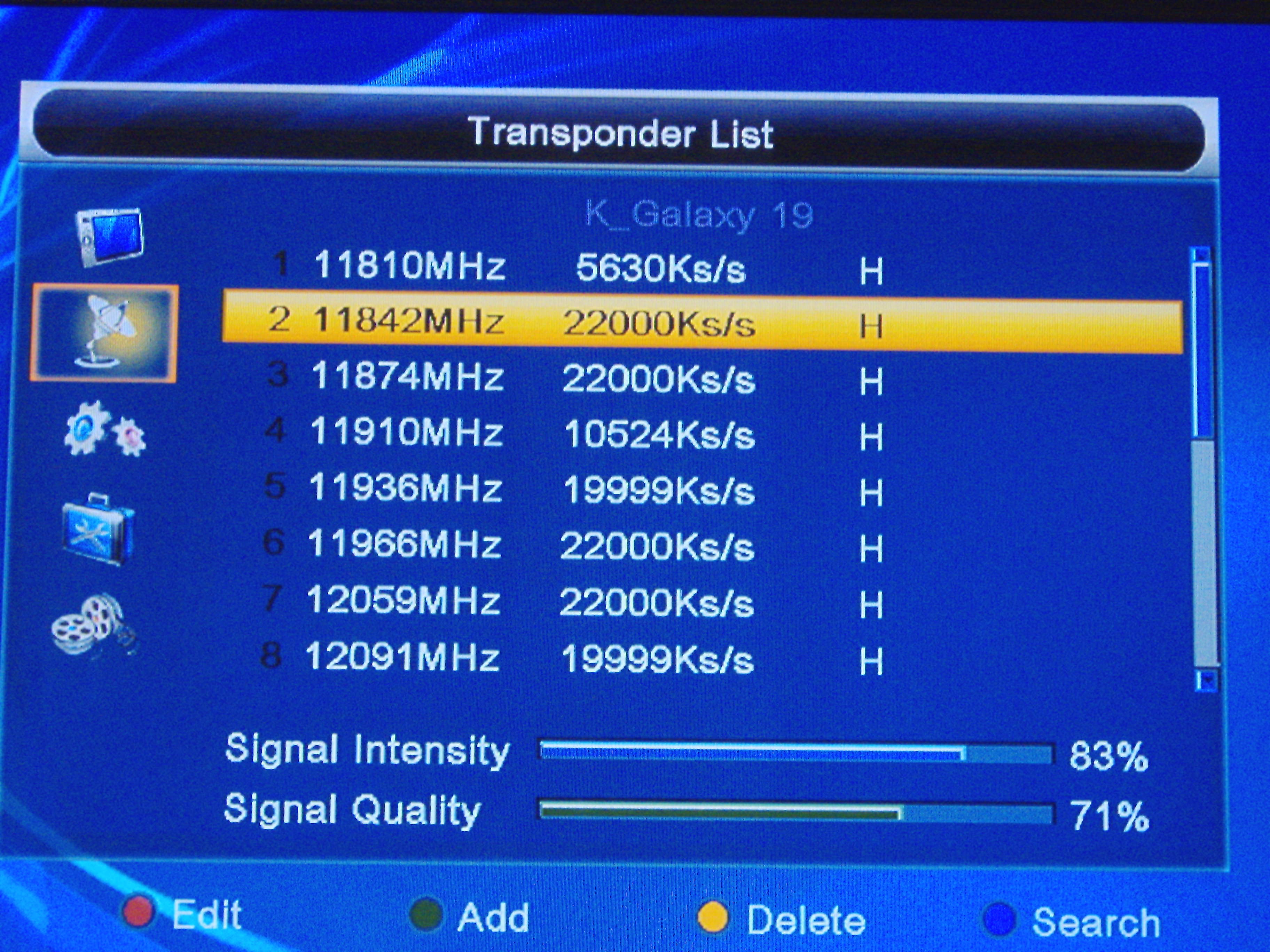

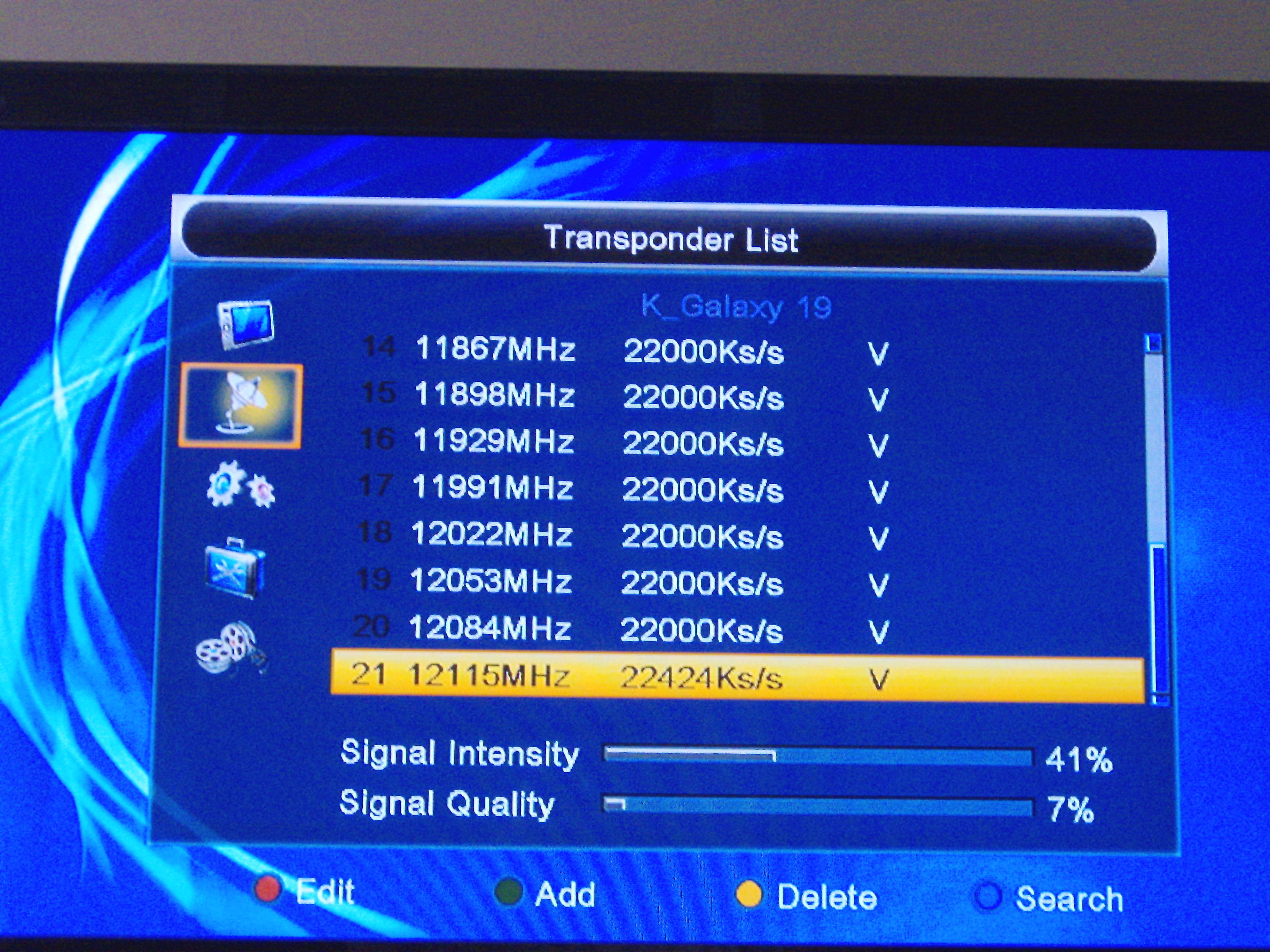

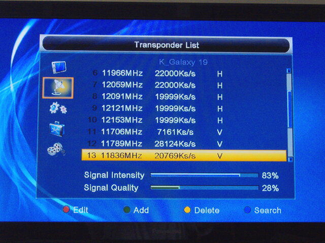

OK this makes no sense....did 3 tests
-hooked SSO to the loop out of the Coolsat which is on 97W and took results of a handful of TP's...both H & V
-hooked SSO directly to the motor setup. DIsh hasnt moved (SSO isnt set for motor) and took results of same TP....a couple V worked but low signal. All H worked fine
-Then hooked SSO to the 4x1 diseqc I have set up for the azbox which has feeds from both motorized setups and 99W C-Band. Nothing else is hooked up to maybe send power. Results on SSO are the same as slaved
Tried new cable from motor to SSO...same thing as before.
I'm at a freaking loss here. If it wasnt putting out 13v the diseqc would show the same bad results as the motor.

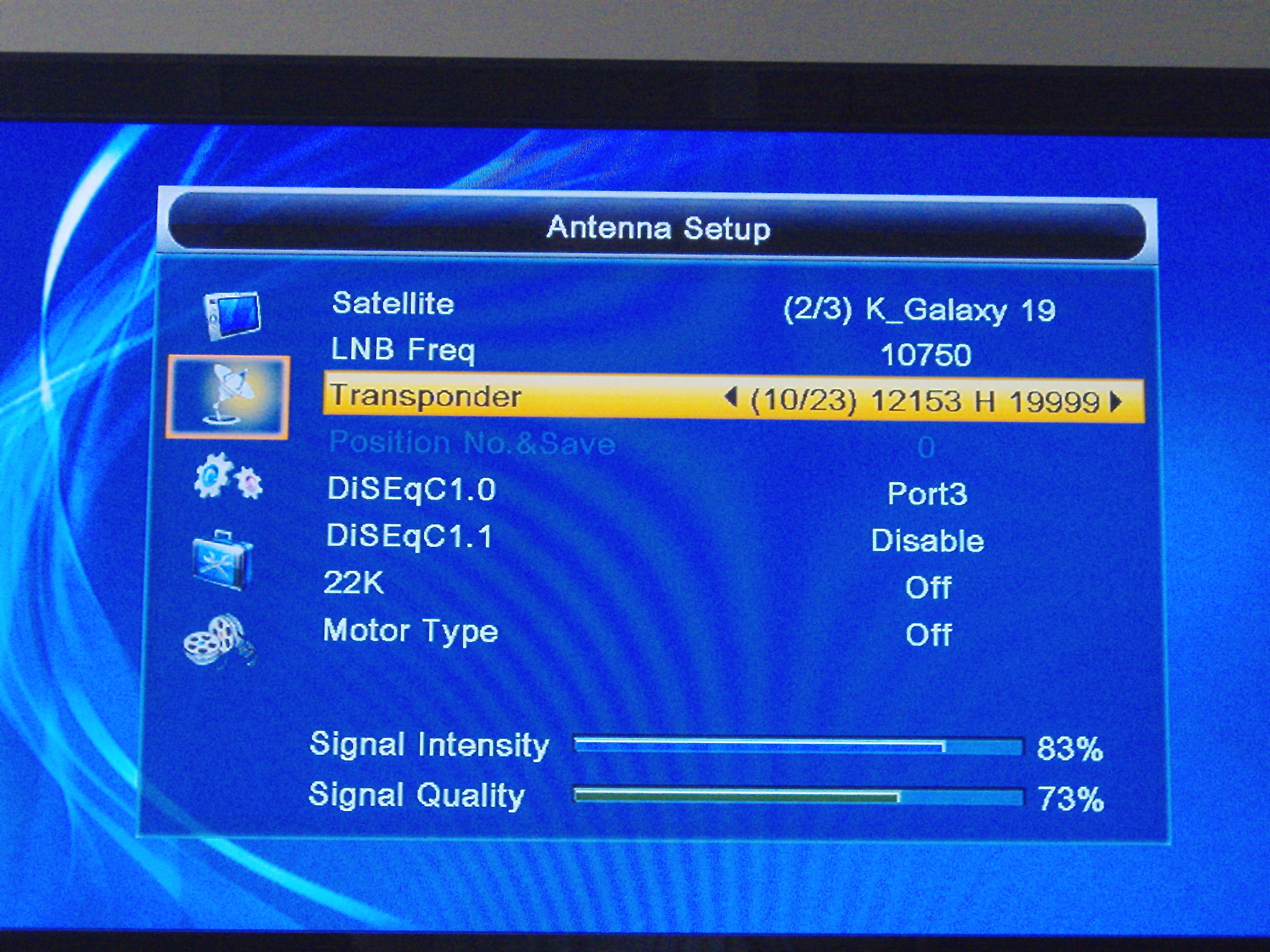

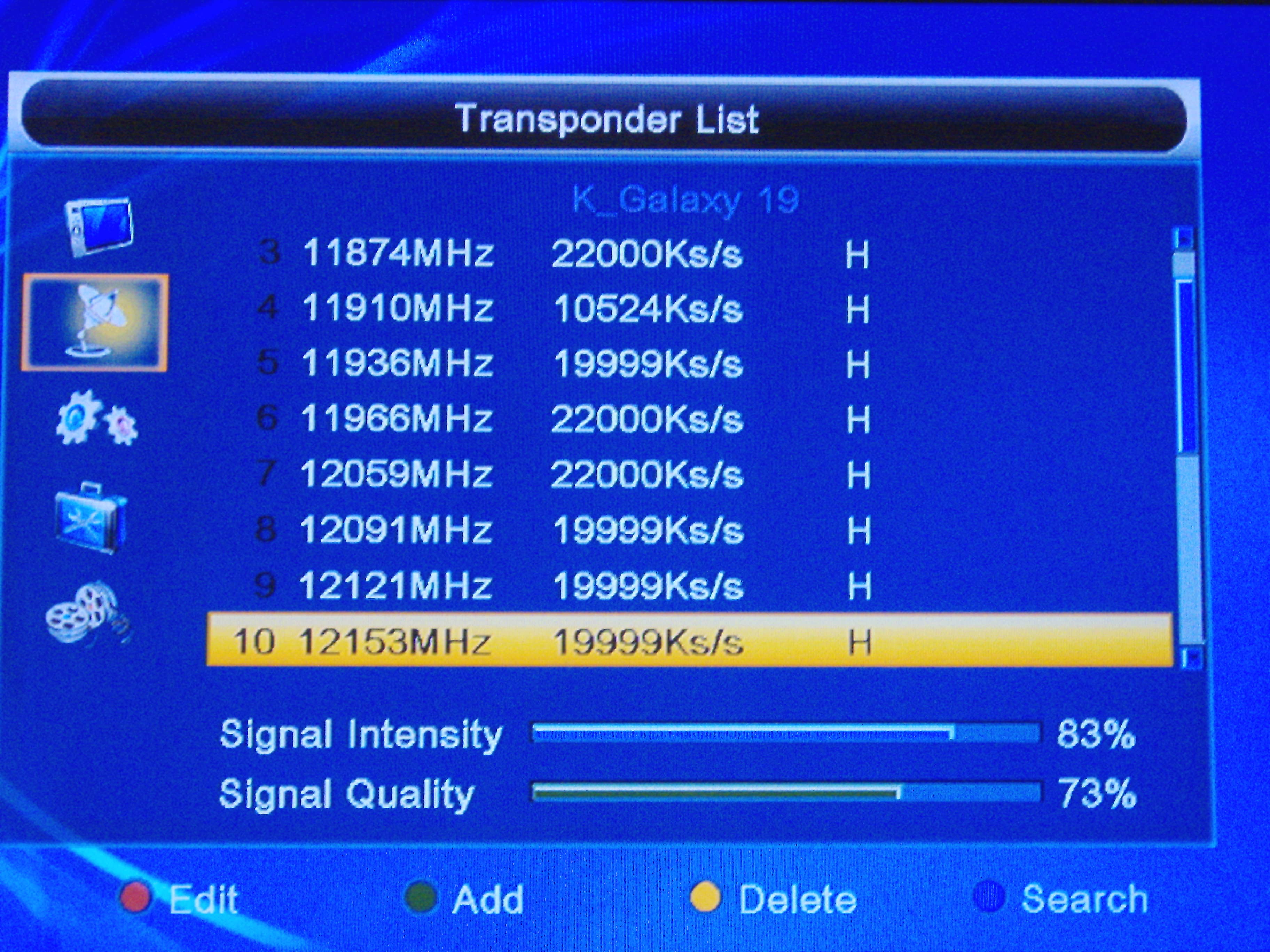

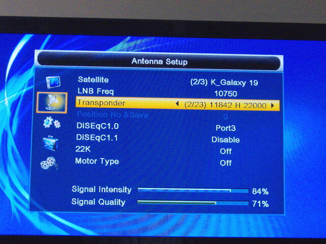

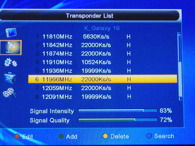

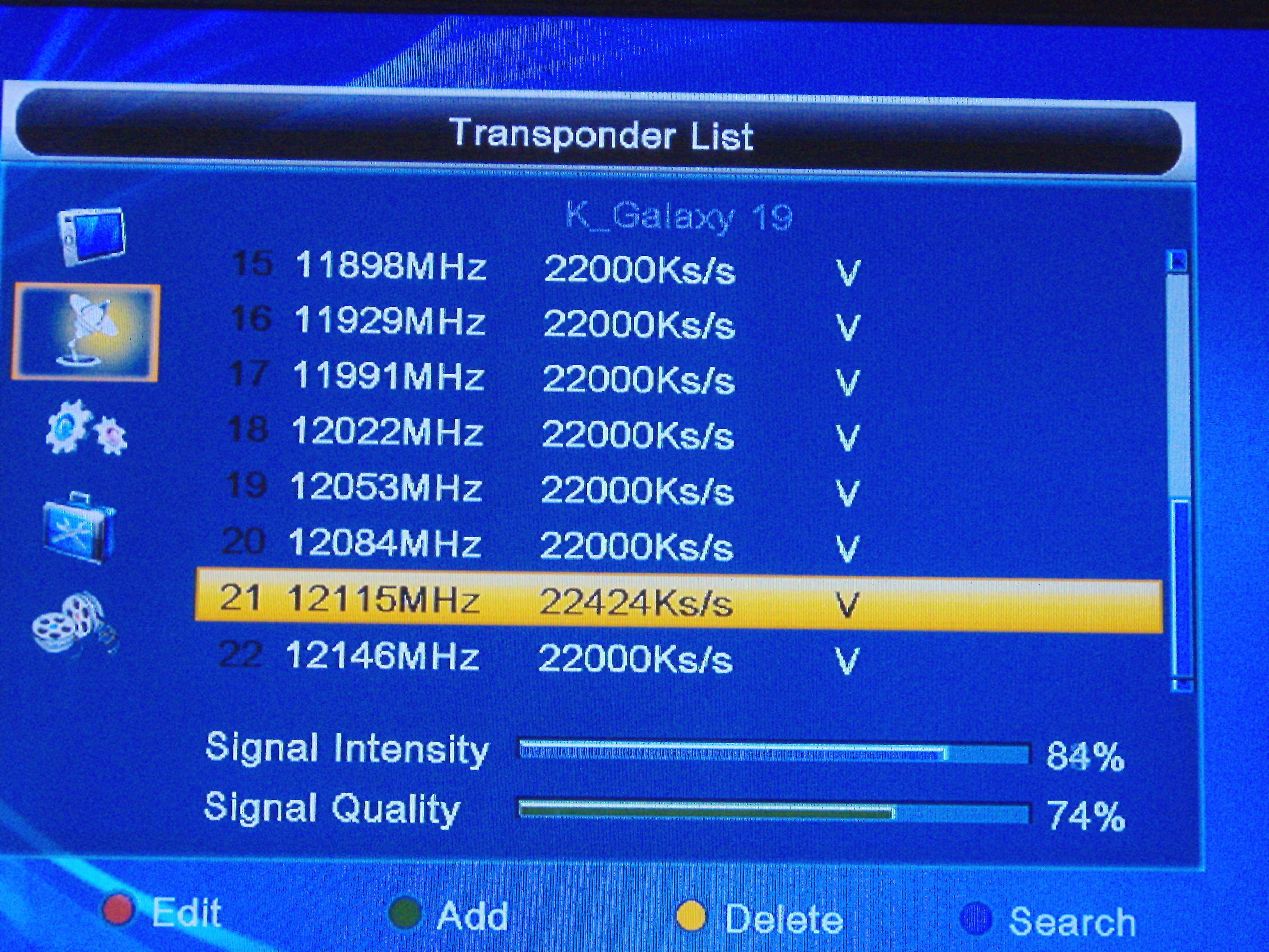

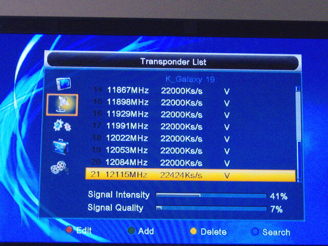

Here were results
vertical TP's
1st column is "slaved"
2nd is direct to motor
3rd is on diseqc
11836 73 28 73
11898 75 63 72
12022 75 00 **
12115 74 00 74
In 3rd setup I goofed and picked 12177 instead of 12022...showed at 74

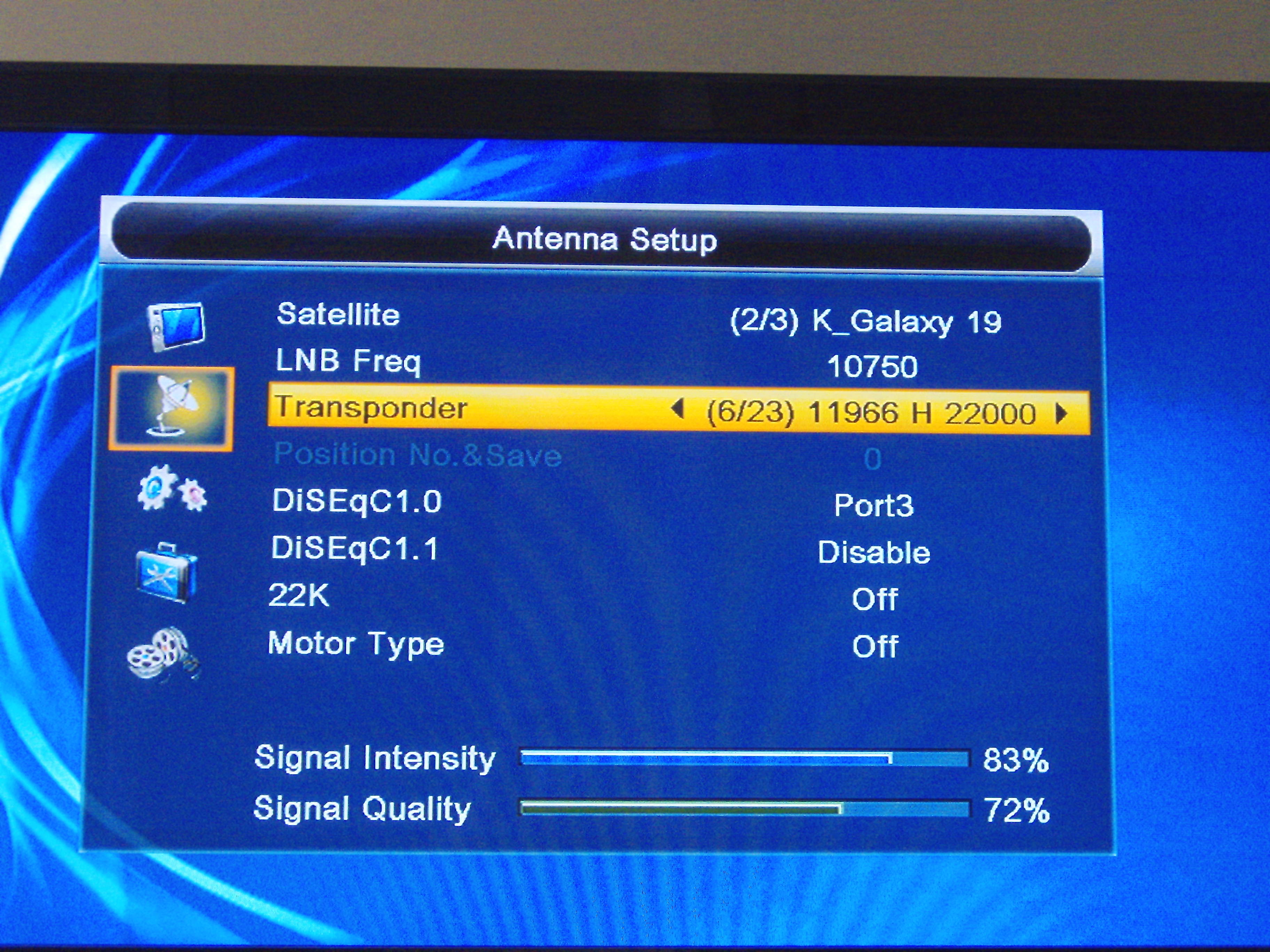

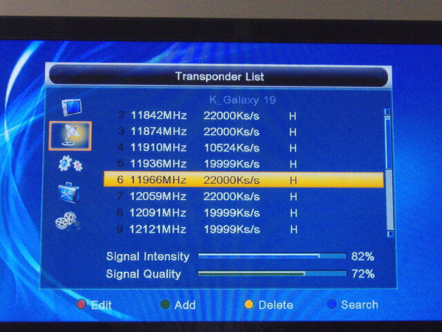

Horizontal
same as above
11842 71 72 71
11966 72 72 72
12153 73 74 73
and pics

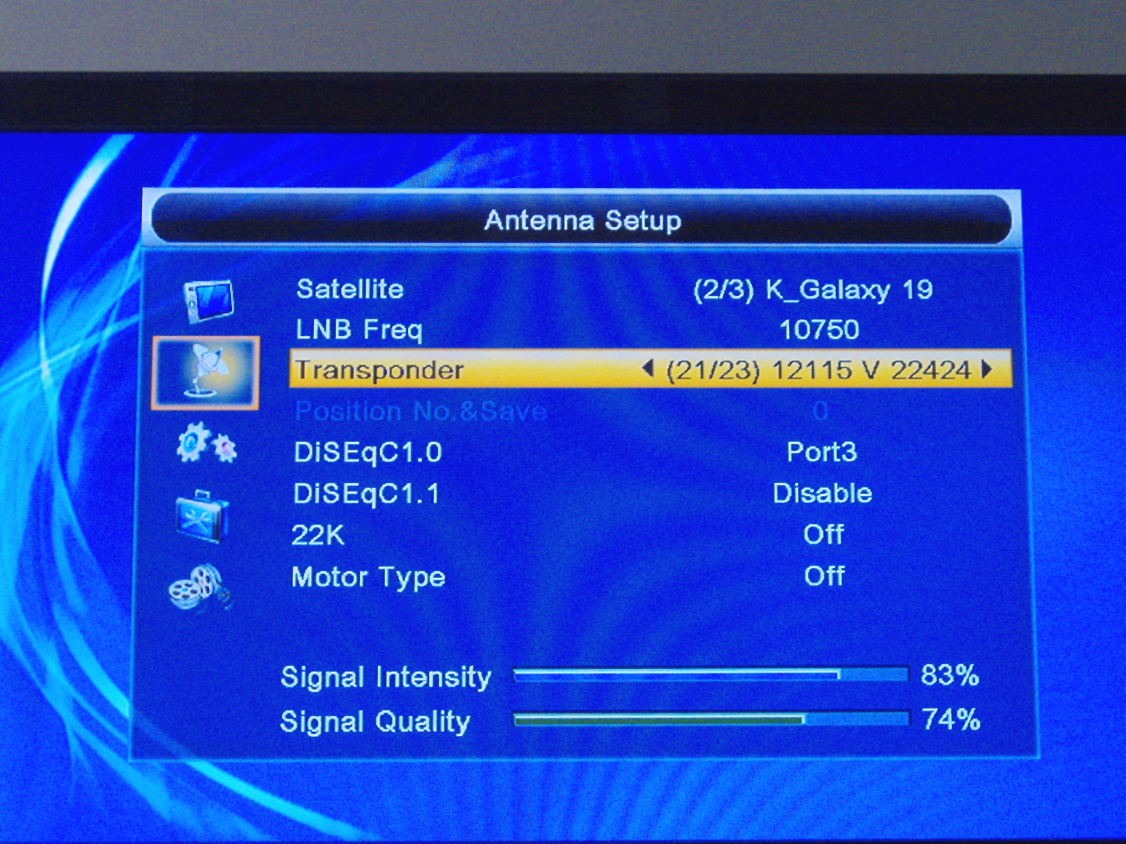

OK let some more confusion come in
Hooked up a ecoda 22k switch...motor on 22k on line from 99W on 22k off
same results....a few V transponders sneak through. H works fine
so if its slaved it works
if hooked directly to motor...no
if hooked through a 22k switch to motor....no
if hooked directly from LNB (bypassing motor)...no
if hooked to 4x1 diseqc...works
OK I give up now :rolleyes:
Hooked up a diseqc switch like popcorn has his set up
port 1...99W C-Band
port 2...motor
works perfect. All transponders come in fine (both V & H) on 97W....havent tried to motor it yet
This makes absolutely no sense...since when is a diseqc switch "magical"?
OK now I REALLY am confused
Swapped the diseqc....put port 1 as motor and port 2 as 99W....works fine
Turned off the Diseqc in the settings...works fine
Unhook switch...wont work
so now why does
receiver-----diseqc port 1----------------------motor-----------------LNB work yet
receiver----------------------------------------motor-----------------LNB doesn't?
well that worked for like 10 minutes....when the switch is hooked up the motor wont move when you select a vertical channel. Once on the sat it will show both polarity just fine
so I hooked it back up with the Pansat in between and its working just fine. That makes no sense as the Pansat is in standby and the SSO is working fine
-runs motor E/W on either polarity with no issues
-scans both polarities
-shows good signals across the board.
weird.....
I hooked the SSO back up to the motor (bypassing the Pansat) and it seems to be working now. I noticed the other day I had a 22k switch in between for 99W C-Band and some signal were low. Hooked the Coolsat back up and it did the same thing. Tried other 22k (both ecoda's) same issue. Some TP's were very low in signal quality
I swear this is so weird. When it works it works great. But when it doesnt work...hoo boy
