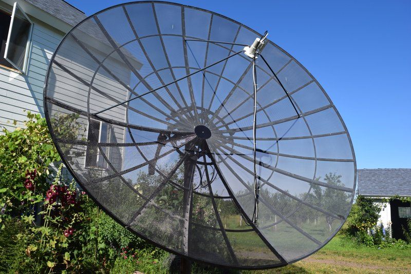

An update to this dish. Last summer 2016, i scored an old throw-a-way 12' dish and mount. Dish was junk, but mount was awesome. I took out the destroyed feeble tek2000 mount, and Frankenstein'd in the new mount. I then put everything back together. It worked ok for winter of 2016 but the dish performed horribly on the weaker signals.. I had some warped / bent panels from when the dish crashed and burned on the old mount. Since the new mount survived without incident through the Winter, I thought id see if i could get 2 replacement panels from Tek2000.
I ordered the new panels from Tek2000. It took 3 months to get, and i got them yesterday. I am VERY HAPPY to report the panels came in pretty much perfect condition. I spent all day taking down the old panels, and putting up the new panels. I am happy to report that the dish is in top notch condition once again and i got a wonderful 3db increase in signal replacing the warped panels with new ones.
I can finally say for the first time, i am HAPPY with my 12' dish! :clapping

3db is a HUGE improvement! Good job.
Yea, i was ecstatic. I believe it was a two prong problem. Less signal from the damaged panels, and i think maybe some adjacent signal bleed from neighboring satellite on certain transponders, also from the damaged panels. Needless to say, you never know what is gonna shake out until you get the thing rebuilt. I will have a smile on my face for days because of this successful resurrection.

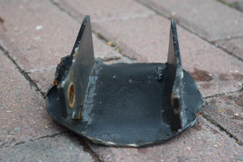

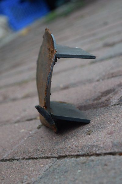

Here is a picture of the original Tek2000 mount top plate that was on the pole cap that got sheered off by the wind force.. The entire load of the dish on that dinky thing! Look how thin the metal is! They have supposedly beefed it up, as i bought this in 2015. Either way , I am happy to not have a tek2000 mount holding this 12' anymore...
