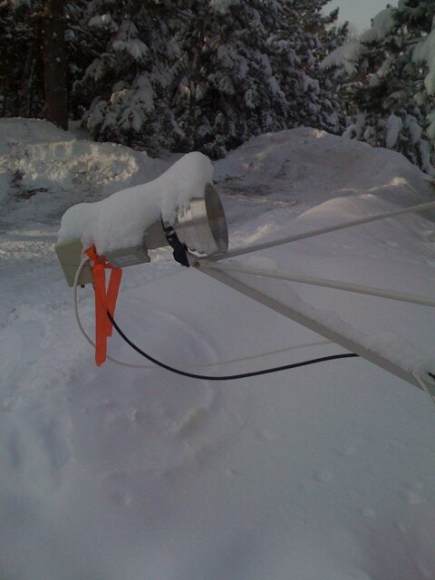

1.2 Meter dish with home made combo LNB

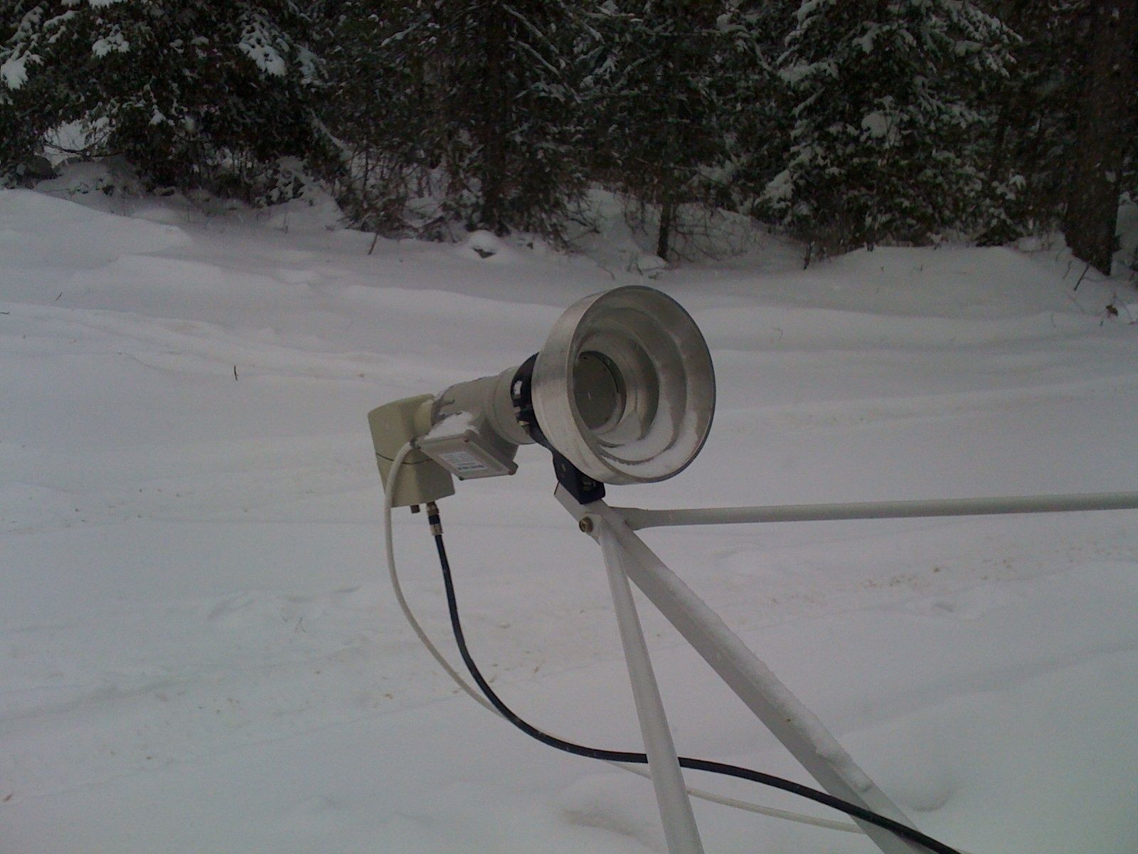

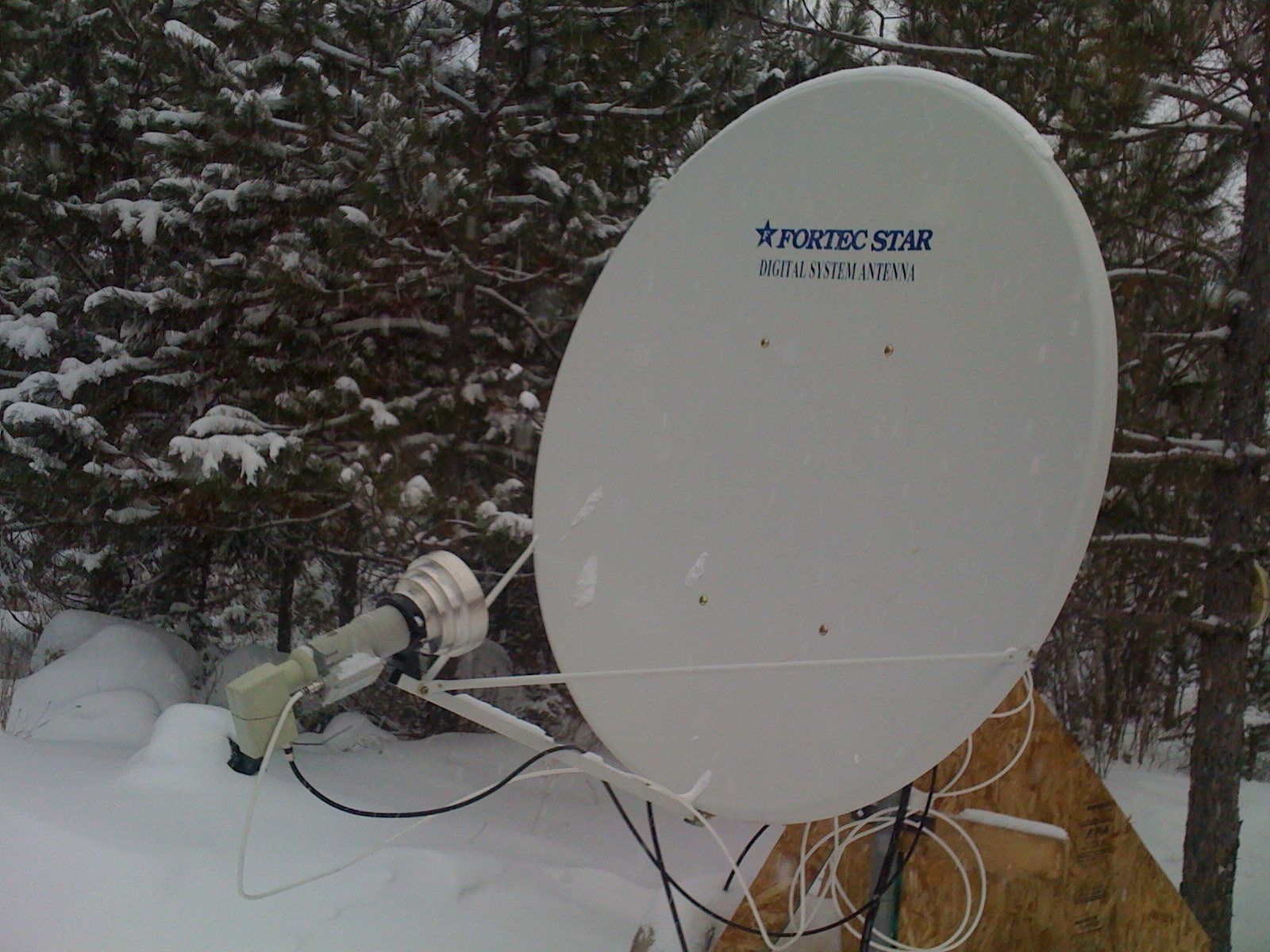

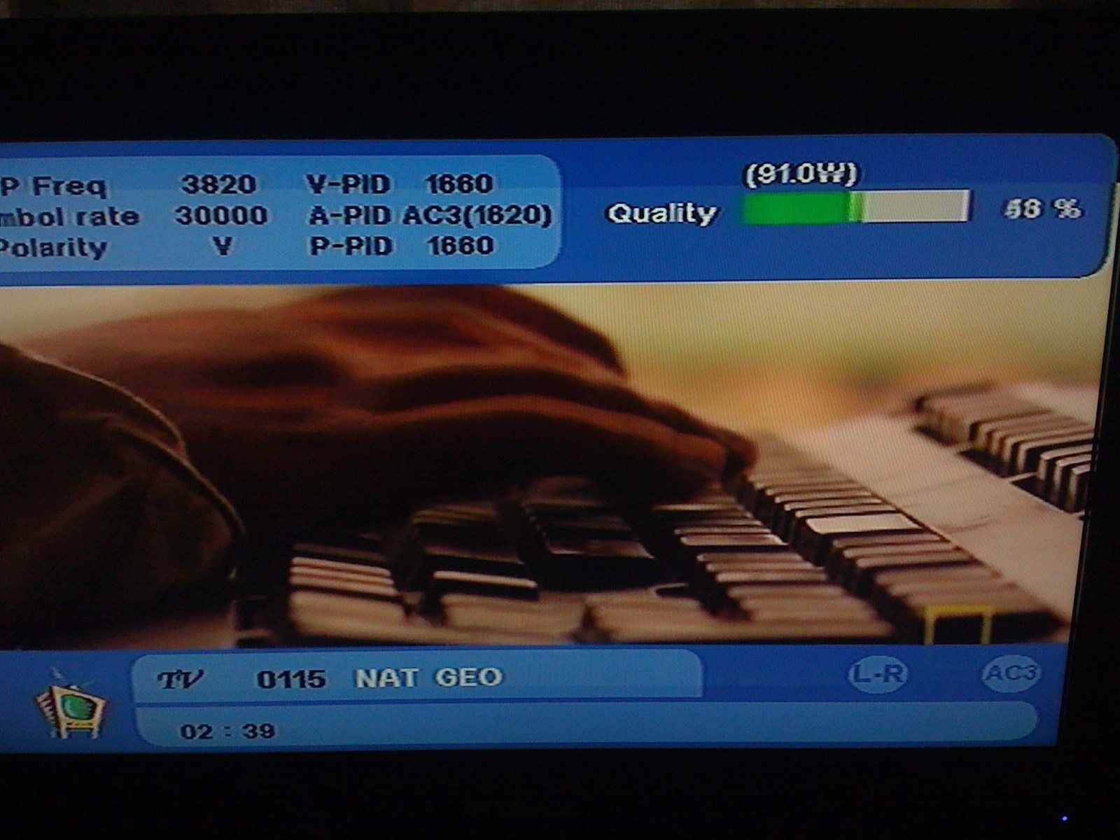

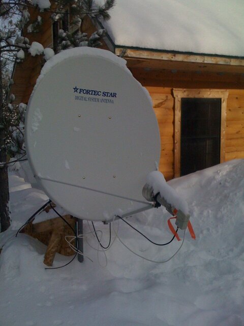

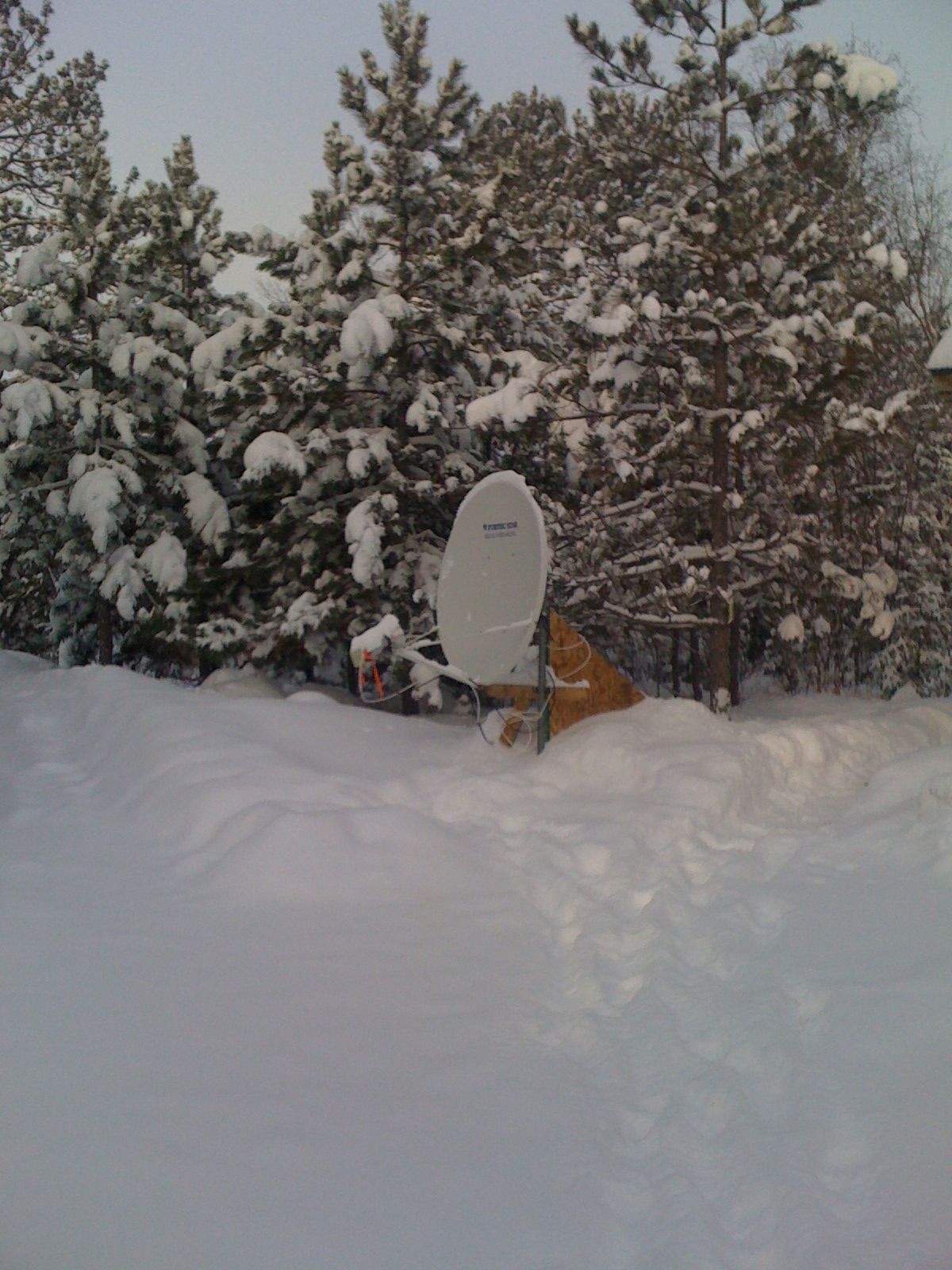

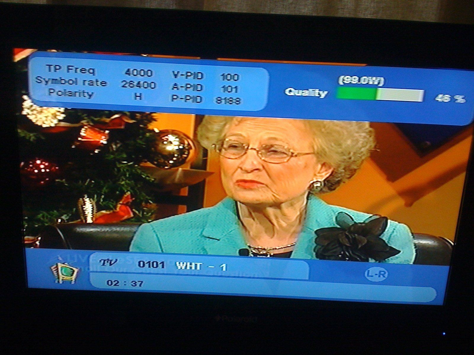

I have a 1.2m setup at a relatives house in extreme northern Minnesota that reliably receives Ku band and C band. The Caribbean Networks and the Sportsman's channel come in at 45Q on a Lifetime NA and only fade during storms that drop the visability to 1/2 mile. I've included some pics.

The Scalar ring was designed and machined by myself. It is machined from a single piece of aluminum on a CNC mill. I will have to check my receipts for the LNBs as I made three different versions.

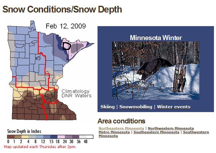

the circle is the vicinity of Ely...this is from the dnr site on snowfall

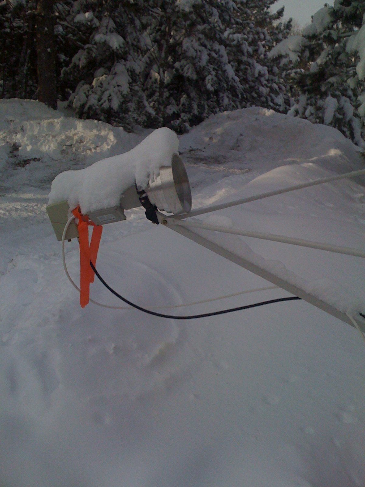

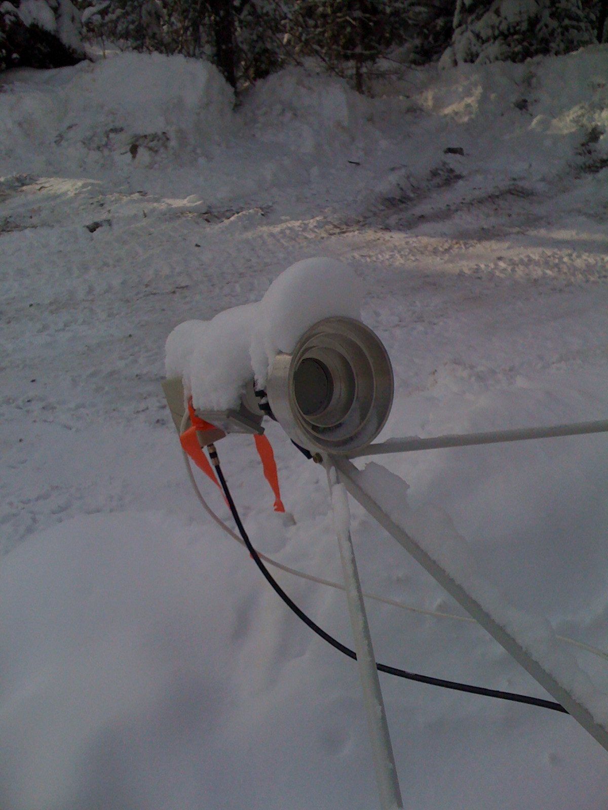

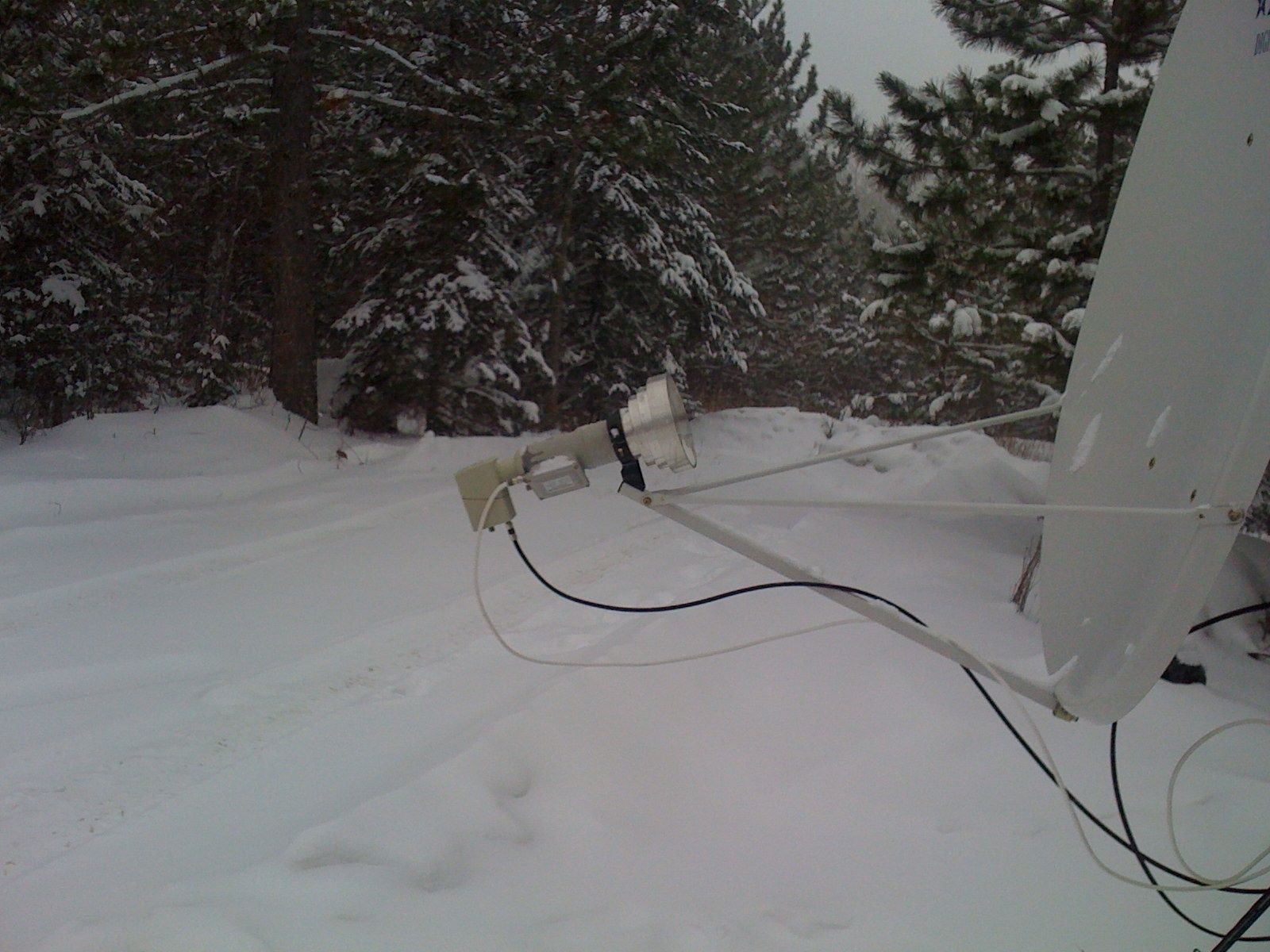

LNB pics without snow
These are some older pics with the LNB mount not mounted correctly.

jtuttle, that looks like an interesting lnb combo. It looks like the back of the c band wave guide was removed and an offset ku band lnbf was glued into place. How well does it work on both bands?
