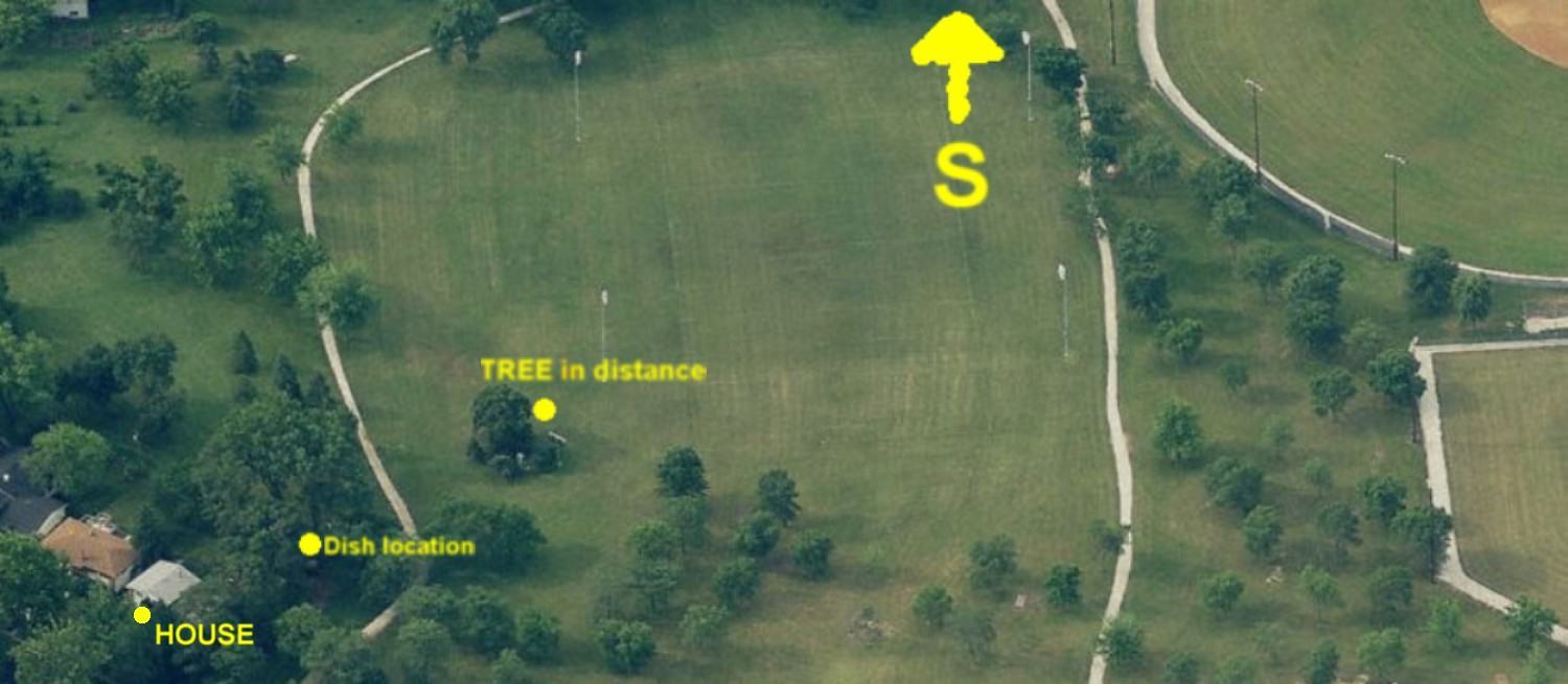

This is ( Imaginary ) what it kind of looks like , imagine setting up a bucket mount and having a fence that's 70 ft high and solid , now imagine an opening 4ft high and 4ft wide from the ground up and setting up the dish to see thru that clearing.
In the distance there is 1 more tree but it's far enough.

I surveyed the backyard and found a great spot almost up against the tree line , tree line is about 10-20 ft from property but a little geometry gave me hope.
Hey I included a pic from a birds eye view looking south , you'll definitely see the tree problems.
site survey on paper
Beautiful picture, and easy to work with.
How did you get it?
Can you go South from "Dish Location" to the fence and shoot from there?
Pick out some locations for possible dish placement.
Get a protractor and draw lines from "Dish Location" and other candidates to the south at angles of:
- 211º for the 110 bird (or 215º magnetic, if your South on the picture is magnetic)
- 222º for the 119 bird (or 226º magnetic)
- 233º for the 129 bird (or 236º magnetic)
- 144º for the 61º bird (or 147º magnetic)
- Assuming that the South marking is 180º, this should be a snap :cool:
If I had a protractor, I'd do it to the picture in about 2 minutes.
How did you get it?
Thanks to images captured from Microsoft LIVE Search ( very similar to Google Earth ) but no need to download a thing , just type address and zoom in , then choose Birds eye view. Closer sharper pictures where available , better than google earth most of the time IMO.
Here's the link .
Live Local Search
