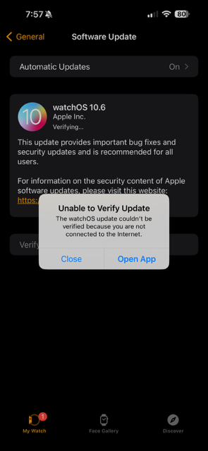

Tried to install the latest WatchOS 10.6 which had already downloaded but install couldn't Verify because it said I am not connected to the internet. which was false because Chrome loads and plays videos fine. Safari says I am not connected to the internet. I rebooted the iphone and it still shows the same issue.
So this morning I was able to download the watchOS 10.6 to my iphone but after download, the next step is to verify the download and I got this message again:
Internet is fine! Checked several browsers and all worked including Safari.

Went into my router settings and discovered the https option was not checked. ???
I selected that and then went to test my wife's iphone for updates and it is now doing the install just fine on wifi about 6 times faster than mine did on LTE.
I guess that was the problem. For some reason Apple diagnostics was not specific enough for the average guy to know the problem. This change requirement to be https was new last evening when my Apple TV+ just lost You Tube channel but none of the others.
