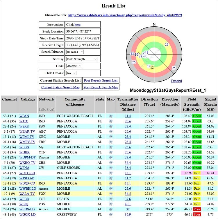

Thanks for the link to RabbitEars. There are only two stations that I'm having a problem with. One is WKRG TV which is showing a field strength of 99.65 (Good)/Signal Margin of 60.29 and is 36.4 miles away and WALA TV which is showing a field strength of 74.08(Fair)/Signal Margin of 38.08 and is 34.5 miles away. I've been able to pick up WKRG in the past but I've never been able to pickup WALA and if a new antenna would allow me to pickup WALA i would be almost assured of once again picking up WKRG. All of the others are OK what do you think my chances of finding any indoor antenna that could be hidden behind my flat screen TV are now?

WKRG is UHF channel 20, so a small antenna should work. WALA however, is VHF RF9, which means you need a much larger VHF antenna to receive it solidly.
I don't know your exact location, and you haven't given the link to your rabbitears.info signal report, but this report seems to match fairly closely your reception description:
RabbitEars.Info
My opinion is that The Krell's last option may be your only option.
