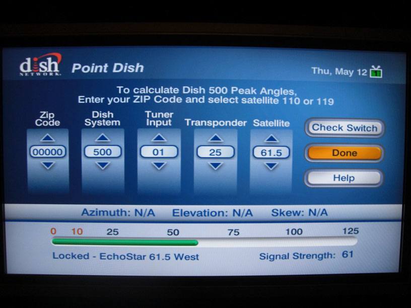

My current dish pointing at 65.5 has a steady signal of 61.

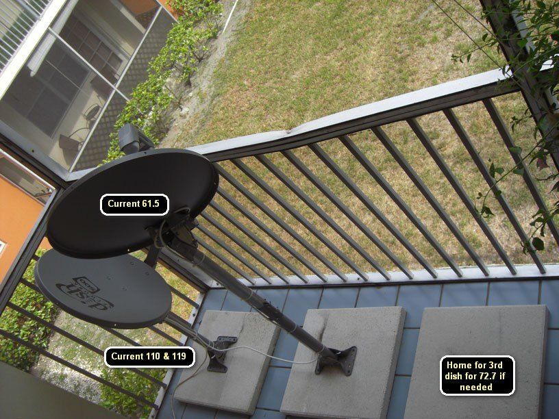

I currently have a Dish 500 with a dual LNB set on 110 & 119 and a Dish 500 with a single LNB set to 61.5.
Here are the steps I think I should take to get what I need.
#1. Confirm I can pick up 72.7. I'm thinking the easiest way is to just take the current 61.5 dish and see if I can pick it up with that..
#2. Once I have confirmation I can pick up 72.7 I was going to use the Dish 500 with the Dual LNB and set that to pick up 61.5 & 72.7. Then I was going to take the Dish 500 with the single LNB and use that to pick up 119 for my Local HD. I'm not concerned with SD programing so I don't think I will be missing anything by not having 110?

Raise the 61.5 dish about 5 degrees and move it right about 21. That should get you close. Then you should be able to peak and see if you are getting a good signal on it. Once you've done that then you can do the move the dish that is on 110/119 to East for 61.5/72.7 & the single LNB dish to 110. Have fun.

Can someone explain to me what a check switch does and when is it required? On my VIP722 if I go into the menu and press 611 I can see that it already has 72 and 77 listed.
I'm under the impression a check switch is really only required if your adding a dish to the system or if your moving a dish to a satellite the receiver isn't aware of?

Anytime you add a satellite , delete one, or change to another arc satellite like western 110/119/129 to eastern arc satellites 77/72.7/61.5 , you MUST Run a check switch or you will not be able to even see the satellites in your matrix. This means if you don't run the check switch , you won't see any difference in your setup no matter where you aim the dish towards.
Hit Menu
System Setup #6
Installation # 1
Point DISH #1
Then Test
Once you are done and it shows the satellites in your matrix , you hit save and then cancel out and let it download the guide or no channels with any guide data . You MUST let it down load the new guide, or you will have no channels in your guide to look at, once you get done running your check switch.

If your dishpointer photo is correct, you have line of sight to 61.5 72 and 77
Re-pointing your 61.5 to 72 is the easiest way to confirm, but will take some patience.

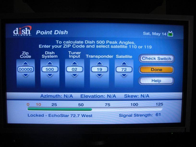

DON'T unhook everything and blank out the checkswitch screen. Re-aim using your best guess then run a checkswitch. It usually won't show signal level for a particular sat on screen unless it is picking up enough signal from that sat to register in the checkswitch screen
If you get 72 to show in the checkswitch screen, (may take a few attempts) go back to the signal strength screen and select sat 72 and trans 19 to fine tune

I actually went out and tried my first attempt today. Within 2 minutes I was showing 72.7 in the 20's and a few minutes later got it up into the 40's on the signal strength meter. I then realized this was on transponder 1 so I adjusted the transponders to 15, 17, 19 and 21 and I was getting nothing.. I immediately thought OK I must be doing something wrong so I just put it back to 61.5. Actually achieved a better signal on 61.5 than I originally had ;)
It appears the step I missed was after I picked up 72.7 I never did a check switch and I'm guessing that is why I'm getting nothing on those transponders.
I will try again tomorrow..

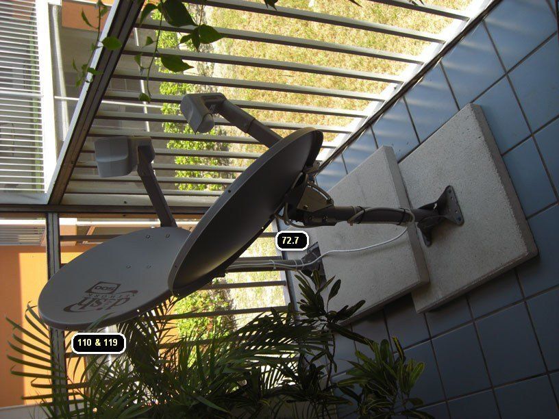

I was able to move my 61.5 dish to 72.7 and get the same signal strength of (61-62) I used to get on 61.5 that has worked like a charm for 2+ years ;)
As a matter of fact seeing as 72.7's elevation is higher than 61.5 I had to lower the dish because the roof of the balcony was blocking signal from hitting dish at the correct angle. By lower the dish I improved signal quality on my 110 & 119 as well. See attached before and after pics. You will notice in my old setup (done by dish) the arm of the 61.5 was in front of the 110 & 119 dish. Not anymore :)
110 signal was 75 and is now 80. 119 signal was 69 and is now 78.
So as I look at things I'm actually in a much better situation overall that I was previously.
