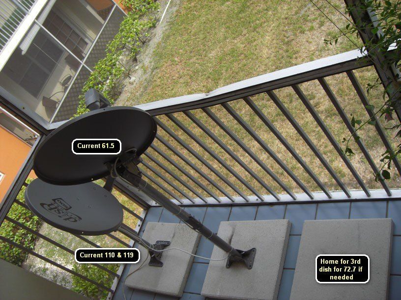

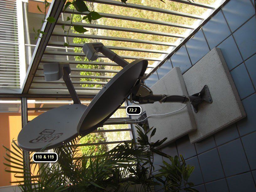

First I would like to say Thank You, Thank You, Thank You to all those who took the time to assist me with this.. Greatly appreciated.
It's unfortunate Dish wouldn't do this for me and I had to resort to doing it myself but I am greatly appreciative.

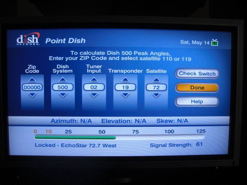

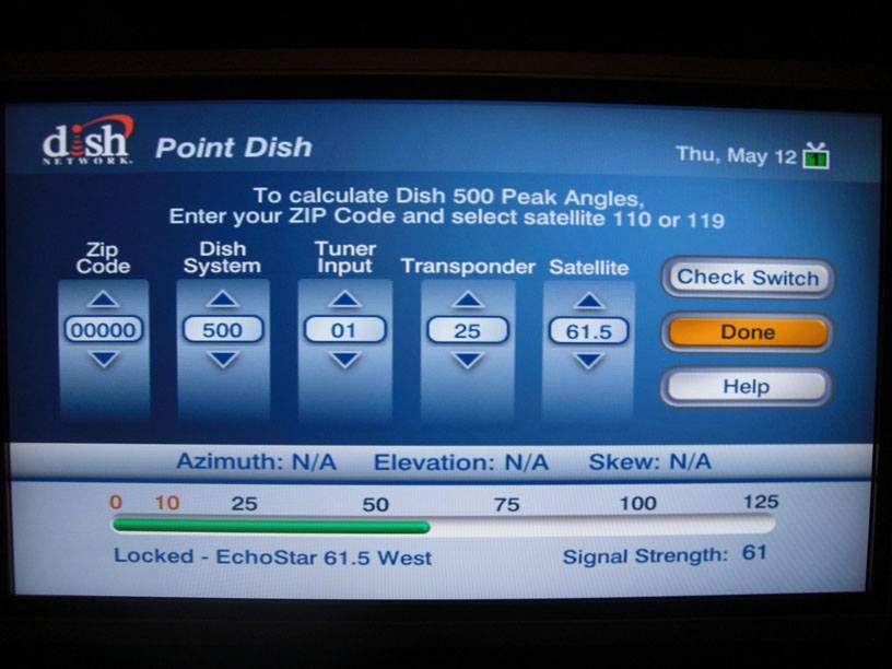

I was able to move my 61.5 dish to 72.7 and get the same signal strength of (61-62) I used to get on 61.5 that has worked like a charm for 2+ years ;)
As a matter of fact seeing as 72.7's elevation is higher than 61.5 I had to lower the dish because the roof of the balcony was blocking signal from hitting dish at the correct angle. By lower the dish I improved signal quality on my 110 & 119 as well. See attached before and after pics. You will notice in my old setup (done by dish) the arm of the 61.5 was in front of the 110 & 119 dish. Not anymore :)
110 signal was 75 and is now 80. 119 signal was 69 and is now 78.
So as I look at things I'm actually in a much better situation overall that I was previously.

Also does anyone have any idea why 61.5 and 72.7 are labeled West? Notice in the attached picture under the signal strength.

I guess you can do without 61.5 if all of your HD channels have been moved to 72.7 already, however, I think it's best if you would compare the channel lineup to your package to what you are currently getting just to make sure you aren't missing any channels that are important to you. Also, as I said before, you really don't need 119 since that's just SD only. Besides that, you should be all set.
