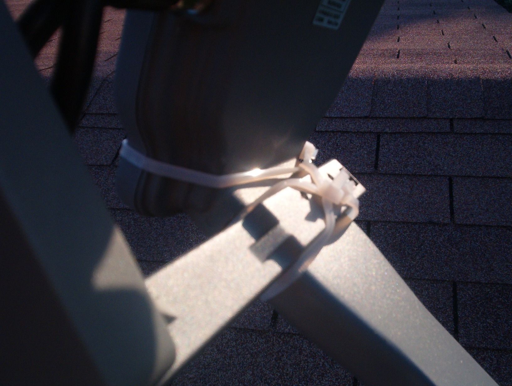

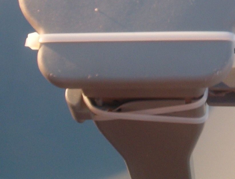

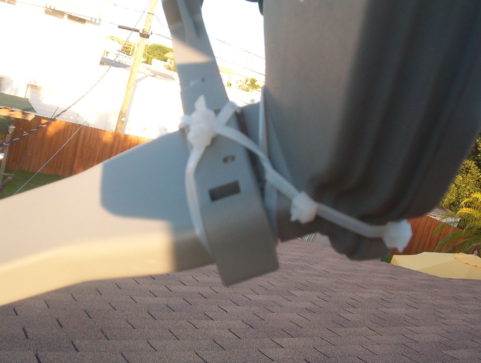

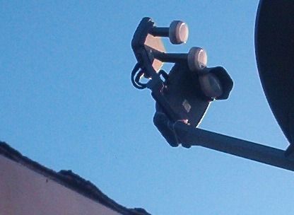

AT9 installation nightmare !!!
I didn't say it was aceptable hell I saw from the 1st picture what he did. I didn't even say it was right, I said he forgot the screws and from the last picture he uses the wrong LNB(110/119) lnb arm. Good luck getting anybody from Mastec local office to come. They don't give a SH@#@

I had a AT9 installed a few weeks ago along with a Directv supplied OTA antenna. The OTA antenna wasn't getting all the networks, so Directv gave me a credit to buy a new correct antenna. When i was installing the new antenna I noticed that my new AT9 dish's LNB's are connected to the arm that holds them with tie-wraps ??? It looks like the arm connects to the LNB's, thru some sort of bracket. Well the bracket looks bent so they just used tie wraps. This isn't noticeable from the ground since my dish is mounted on a pole about 14'. I called Directv and told them of this unacceptable installation and they are supposed to have the area manager for the local installer ( Mastec ) straighten this out. I told Directv since i recommited for 2 years that i want it installed right, as this "setup" obviously wont last...:eureka
Well the new " senior " installer showed up this AM to replace the AT9. He told me the original installer had the wrong arm on the dish - that's why he used tie wraps. When he first arrived, he thought that he probally just had to put screws in, but upon closer inspection he realized he had to replace the dish. He had the new dish up in under 10 minutes while the original installer took over 2 hours. Plus - the original had 2 AT9's in my yard and he still couldn't get it right - It took 3 AT9 dishes to finally get it right - Finally I'm a happy camper...:bow

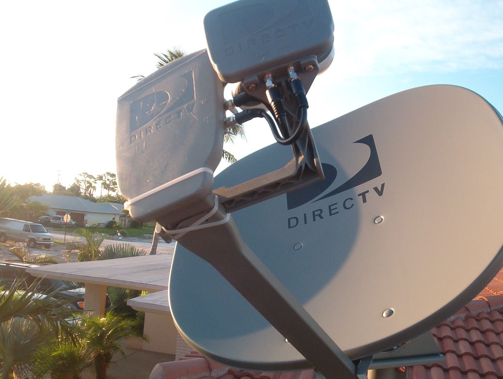

As an experienced structual engineer, I'd have to tell you that I am concerned over the strength of the pole's attachment to the end rafter board. It appears to be only on 3/4" thick wood and only with one through bolt. This, apparently, is not even a structual rafter, but decorative board held on with nails. The attachment is apparently a piple hanger meant only to hold a pipe to a wall and NOT a structual fastener.
The AT9 has a large sail area and will exert a lot of pressure on the 3/4 inch board. This appears to be an accident waiting to happen.
This said, a square frame, quite easily made form two inch slotted or regular angle iron available from Home Depot or Lowes, should be made tying the thin board to the rafter right under the stucco. At least three 3/8 inch diameter lag screws should go through the stucco onto the rafter. If the area is accessable in the attic, it should be through bolted.
The outboard section of the frame should be bolted to the 3/4" thick board with 2x4 sandwiched over the inside of the angle.
If your refering to my setup, It is attached to the a roof rafter behind the fascia board with a 3" lag on top. The bottom is bolted through the fascia board and then a 2x4 behind the fascia board to give it more area to hold it. the pole is in the ground 3 feet (with rebae going through the pole and set in concrete) with 180lbs of concrete. also the dish mount is tapped and bolted to the pole.
