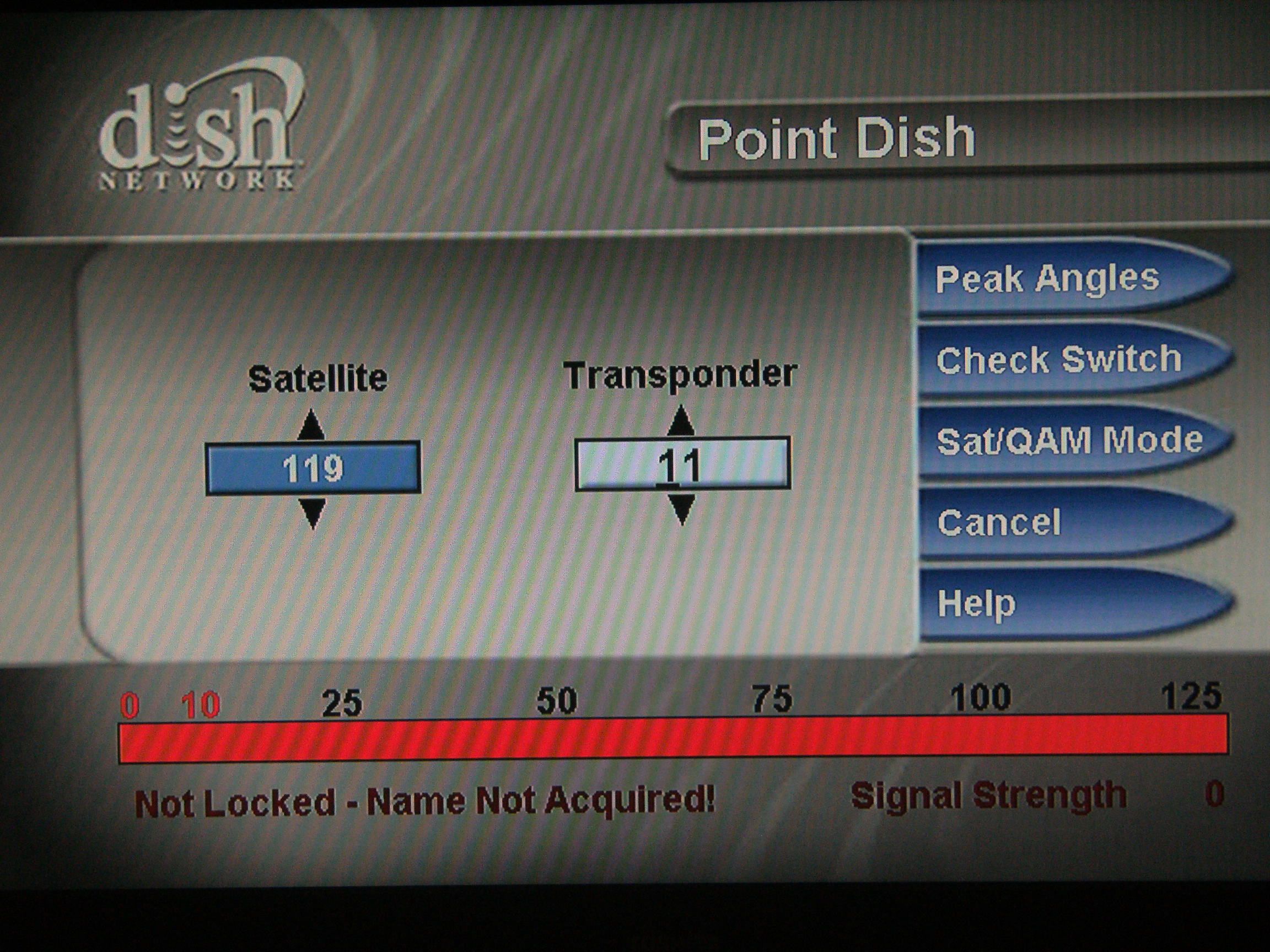

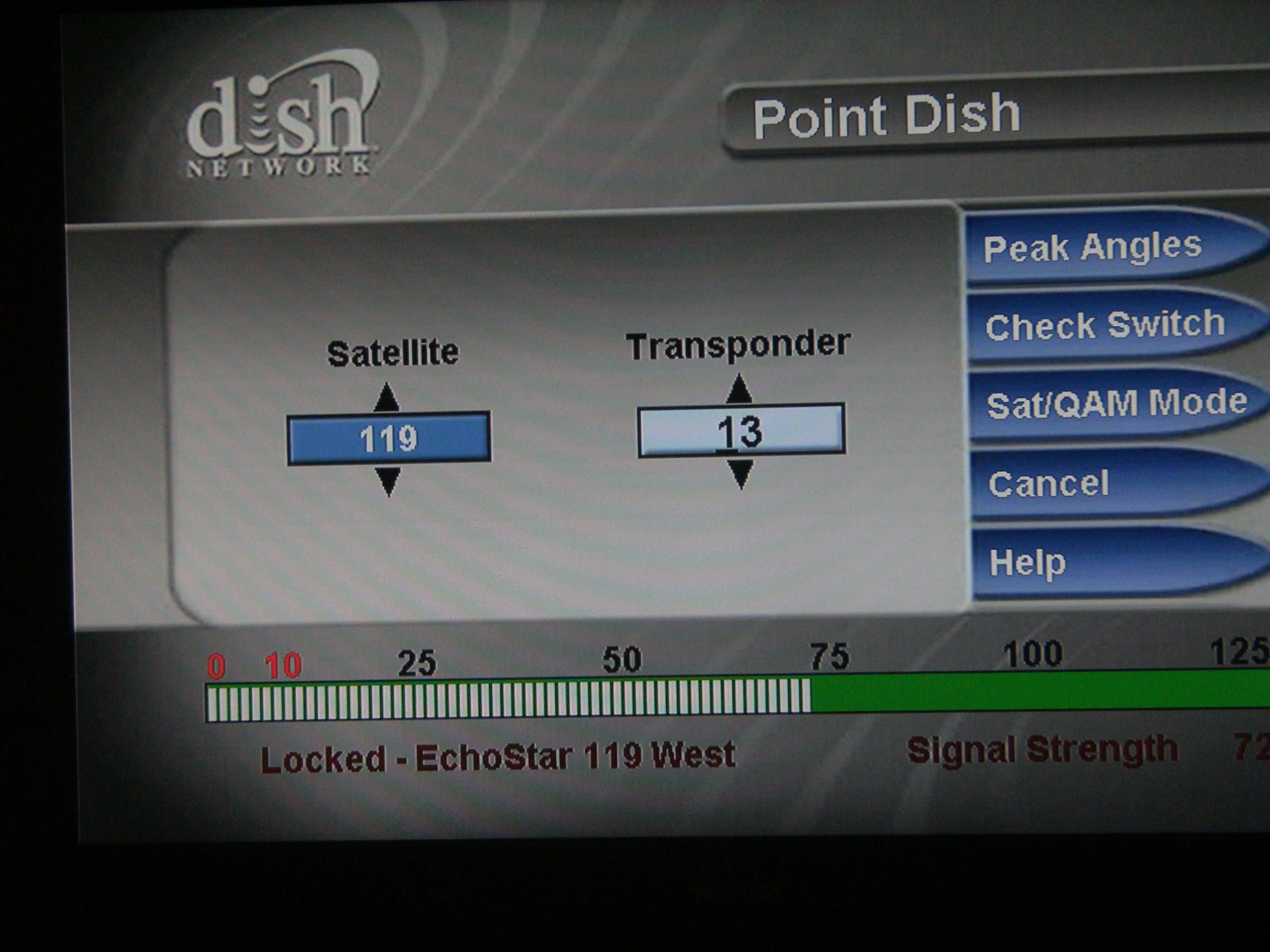

Signal strength on 119, 13 is running from 67 to 75. However, when I went to Point Dish, and put 119 on 11, there was zero.
When I exited from Point Dish, the system started the sequence again. It is still at 1 of 5 on the progress with Sat 119 and Transponder 16.

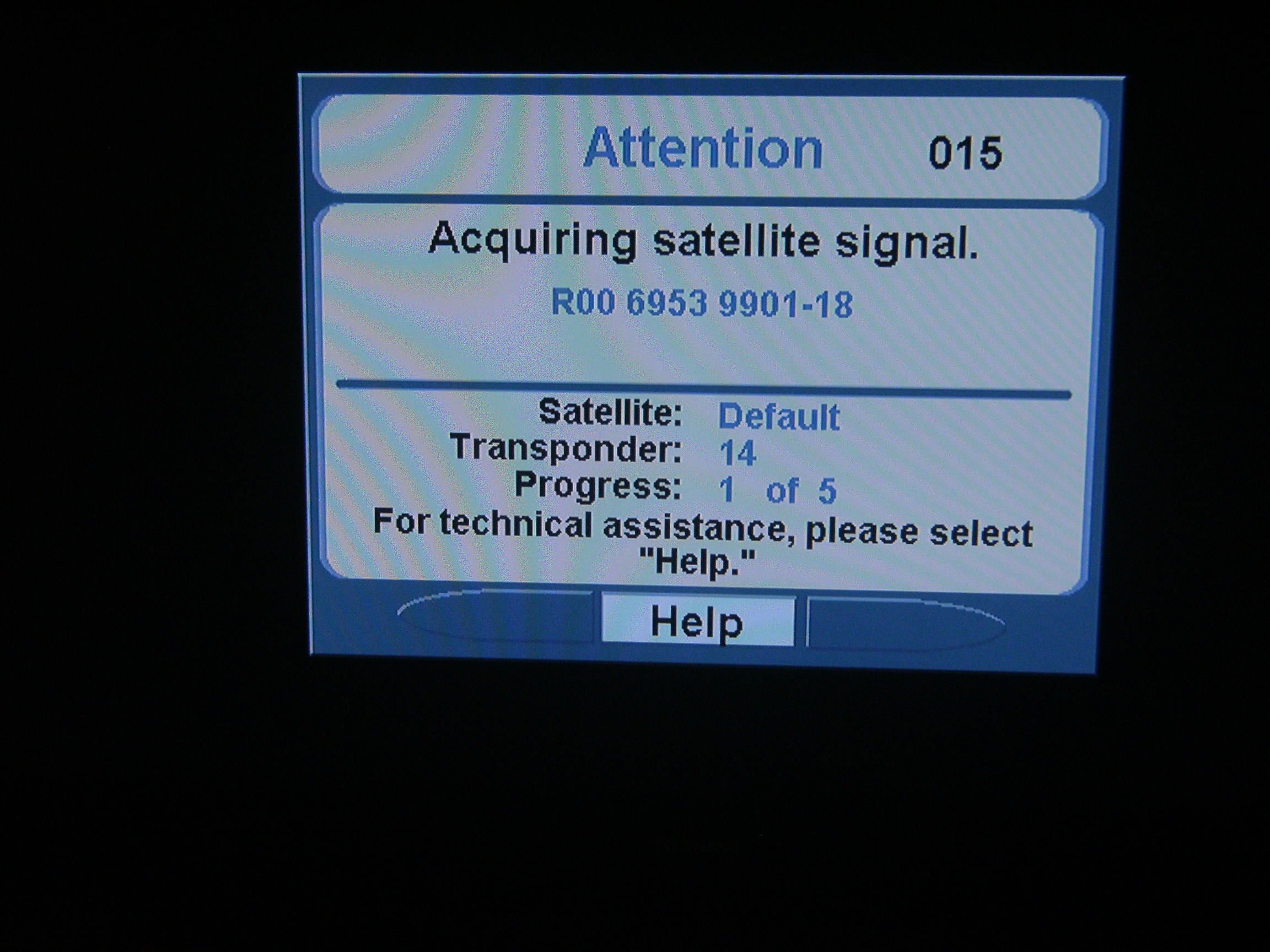

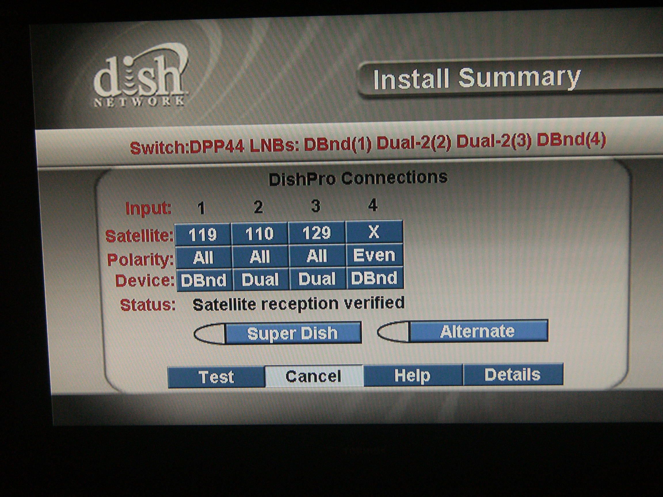

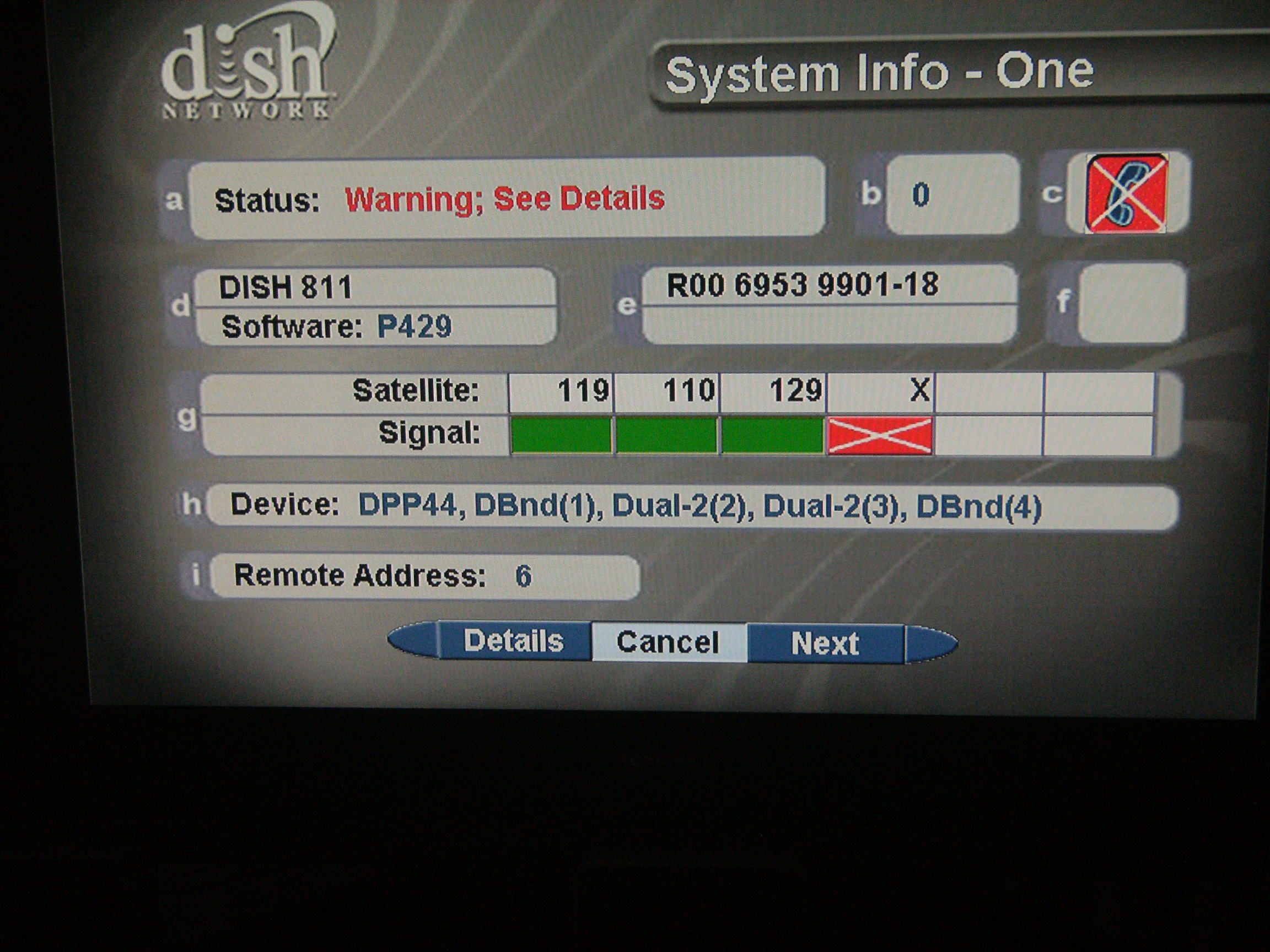

Here are some images from the screens. Attached.
On the System Info One page, there is an X in the X box. Not sure why that is, Dish people seemed to ignore that. The details said it's nothing to worry about and to run checkswitch. As you see from another image, I just did that but no success...
Right now it's doing:
Attention 015
Satellite: Default
Transponder: 14
Progress 1 of 5
And, my ZIP is 73112 if that's of any importance. I can't seem to find out where I would enter that so it would select the appropriate satellites if that is even necessary. I'm in Oklahoma and the original owner was using this in North Carolina, 800 miles away.

See that's interesting because it is a DP34. I'm certain of it by image as when I climbed up the ladder to look for a power slot it looked NOTHING like a DPP44 (familiarized myself from Google). It was exactly like the DP34.
Dish said that they think its a bad receiver for two reasons:
1) The smartcard ID doesn't display or show anything that it is being read when it's in place.
2) The receiver jumps around on the 015 screen. Sometimes it will read "Satellite: default Transponder: # Progress (blank)" and sometimes it will just be jumping from 0 to 1 progress (just randomly started that a while ago), or it will show the normal information "Satellite: 119 Transponder: 15 Progress 1 of 5"
It seems loopy.
Finally, the Ebay person responded saying that they had issues with it sort of. But, they didn't notate that on the posting or tell me in my inquiries. Said it would get to 3 or 4 on the progress bar when he last tested it.
Great. I got played I think.
agreed. luckily the tech is doing a free replacement as a thank you for serving the country sort of thing. that was really nice of Dish.
but, curiously, on the DPP44. should that be what we have, and i swear we do not, would it truly require a power reset for a new receiver being installed? i would assume it would have code in it to cycle itself when new hardware was introduced if it was necessary?
The 811 (had one) is only capable of MPEG-2, so no current Dish HD channels (all MPEG-4) and no eastern arc 72/77 channels even SD will work.
