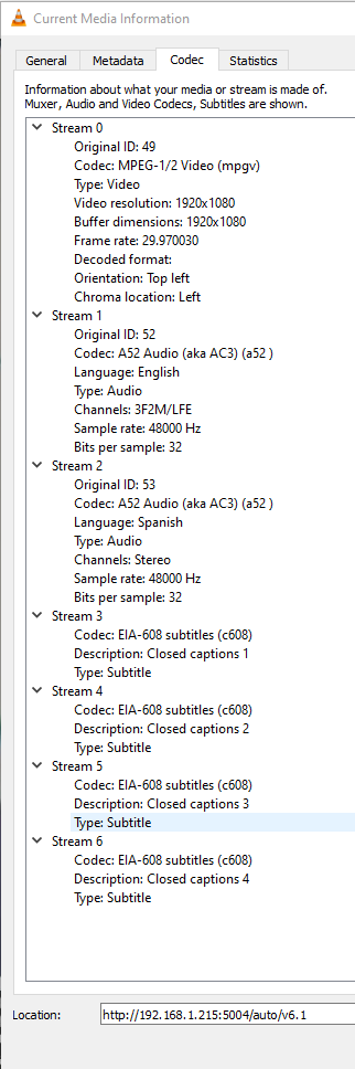

Most USB tuner dongles forward the MPEG-TS stream coming from the broadcaster containing all of the video, audio and data streams. As such, I would imagine that it is up to the DVR to parse the appropriate packets that are part of that stream.
Here's what comes from my HDHomerun (network-connected) for my local CBS channel:
