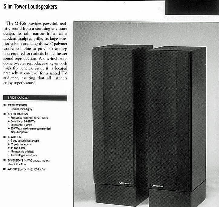

I wouldn't venture to presume that there isn't something wrong with the speakers without trying them on a known working receiver (which you don't seem to have access to). Fancier speakers can have all sorts of magical electronic components in their crossovers that may be subject to failure. There can also be issues with running 2ohm speakers with a receiver that isn't set up for them.

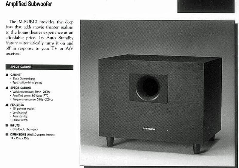

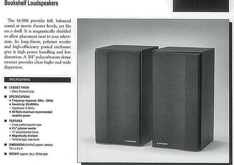

These are my 20 year old speakers.
i would start by trying diff speakers
even ordering a pair of bookshelves off amazon if you cant get any other access to them
If there is no center channel speaker, that could contribute mightily to muffled voices as voices are usually centered there with only echos on the fronts and/or surrounds (I think a 4.1 system has no rears). As audio mixtures have become more surround oriented, this is something that would be more of a problem now than it used to be. I'd hook up a spare speaker (or temporarily move one of the rears) to the center channel output and see if the voices don't sound a whole lot clearer.
Does FM radio or a CD/music played through the Blu-ray player (in DIRECT audio mode) sound mushy too? A set of headphones may be a quick solution to testing whether the DSP has bit the big one.
4.1 should be ok
you just have to run the setup on the receiver so it knows what speakers are available
it should redirect the center channel to one or both of the front pair
before i added my center i was running 2.1, everything was fine.
