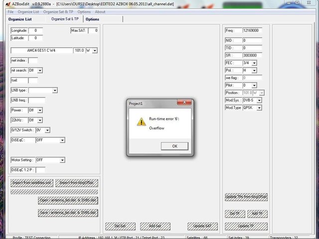

Hi All,
We are North Americanizing our Satellite List using AZBOX Edit. Run TIme Error.jpg
Keep getting a Run-time error #6, See attached
Anyone know how to deal with this or seen it before? This is happening when Deleting Satellites only
Thanks for you help

Hi Sonya,
I am not sure on this issue. I have the same version of the editor program (0.9.2880a) and I haven't seen this error come up for me. What operating system do you have on your computer? XP/Windows7/Vista, etc? From a gut instinct here, I think that you might be missing a specific library file that the editor program requires, but that is just a guess. Usually, a missing file generates a message that it cannot find file xxxxxxxx.yyy but there may be something more involved than this.
Check some of this information out for troubleshooting: What is a runtime error? Obviously, you can "google" for more resources on this subject, but that is the best I can offer right off the cuff.

Hi Radar,
We are running Win7
This error usually happens after I have been deleting un-needed Sats, then adding needed Sats (C and Ku) and then deleting more un-needed Sats
Tried reguarly saving after several changes but sooner or later this error preents me from deleting anymore Sats. We can continue to change Sat names etc, but can no longer "Delete" any unneeded Sats
Have scanned the "puter" for virus's and spyware: nothing found
Will continue working with this and see if we can figure anything else out
sonyajon,
North Americanizing the Azbox can be frustrating with the limited tools available.
I have never seen your particular problem before and suspect it is a bad file in the program someplace.
I do know that once you start the process to N/A the satellite list one should not stop and work on it at a later time as something has always seemed to pop up and go wrong or out of place. Always do it when you have the time available to spend a few hours of non-stop work to do it properly.
However all is not lost for you.
If you want a clean N/A list use the link on page 42 of the Azbox Users Guide,
(see the sticky area above to download the user guide) There are 2 channel lists at the site. One which is loaded with channels already scanned in and one with just a few for test purposes. Both have the same satellites from 5.0W to 139.0W listed.
These lists have taken into consideration several launches that are going to take place in the next couple years and you will see some new names on some/ along with the current names of the satellites.
This will save you the hours of time trying to delete one or two and then have the Azedit program crash on you.
Just remember that if you use them you may have to still edit each satellite a bit for the DiSEqC switch settings so it fits your needs. The names however are all correct, unlike what comes from the factory, and all C & KU have their own separate satellites listed.
I have had several people tell me they have used these lists and none have reported any problems later on with them.
Just remember to send them to your Azbox using the ACC program.
