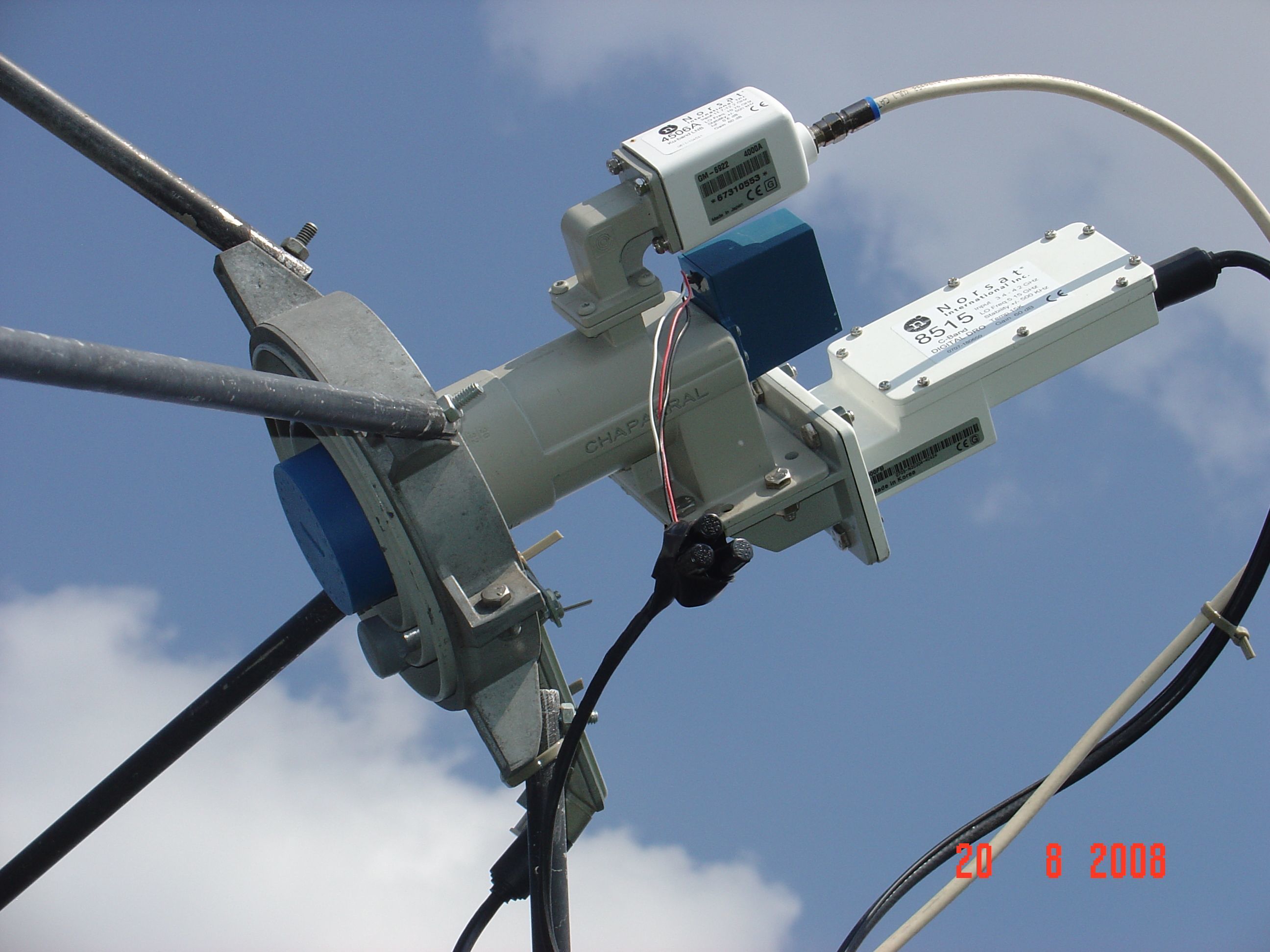

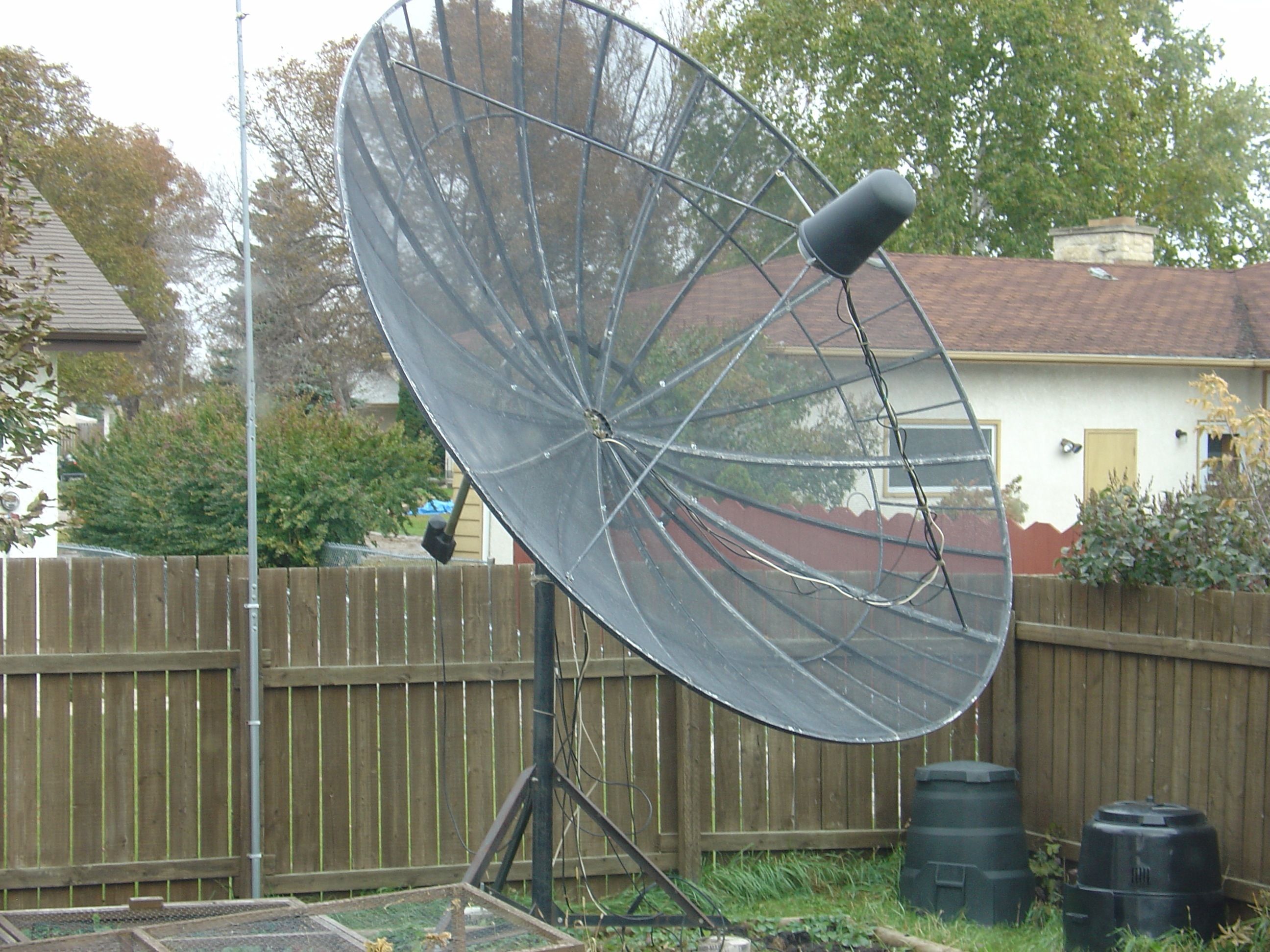

Hi jsattv. beautiful dish and lnbf's by the way. I'll try my best to answer your questions.
"Crackt, are you saying I may have some major hiccups with AZBox for these Basic Functions with VBoxIII, Actuator, and Uniden 9900 RX for Polorotor Control? I would like to get HD channels but if I am going to have a lot of problems ........now I am wondering if its worth it!!?

Thanks for comments on my Mesh Dish & LNB's Kevin, and your great info again. I checked out that European Sat List site and it looks like it Lists every Satelite out there in Europe as well as in North & South America, looks like you just check off the Sats of your choice - then download your customized list?? Wonder if it works well since I will be scanning in BOTH C and KU Band Sats?
As you noted I'll mainly just be replacing the ViewSat RX and rescanning again.
