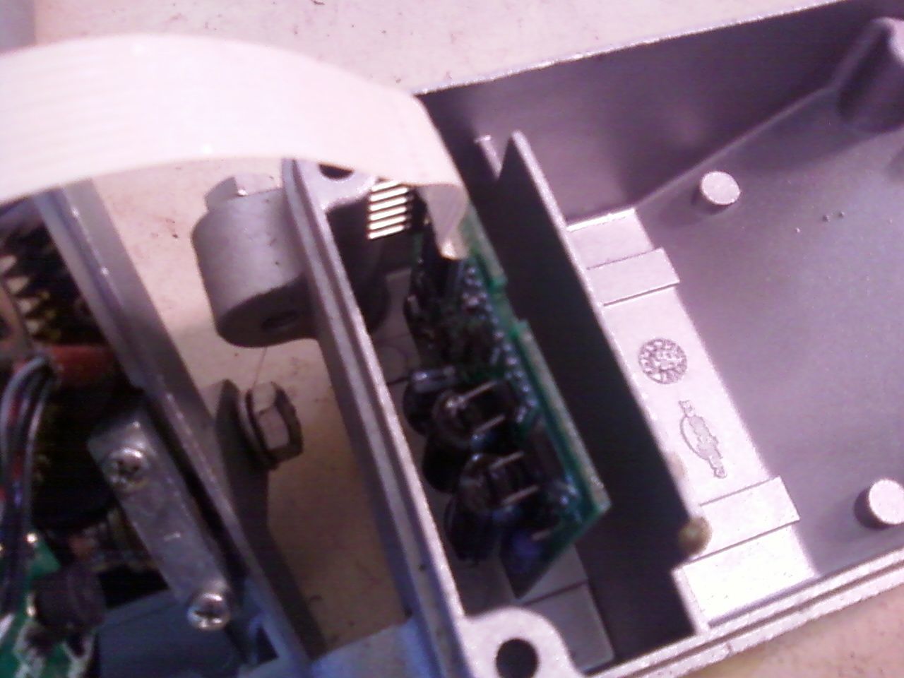

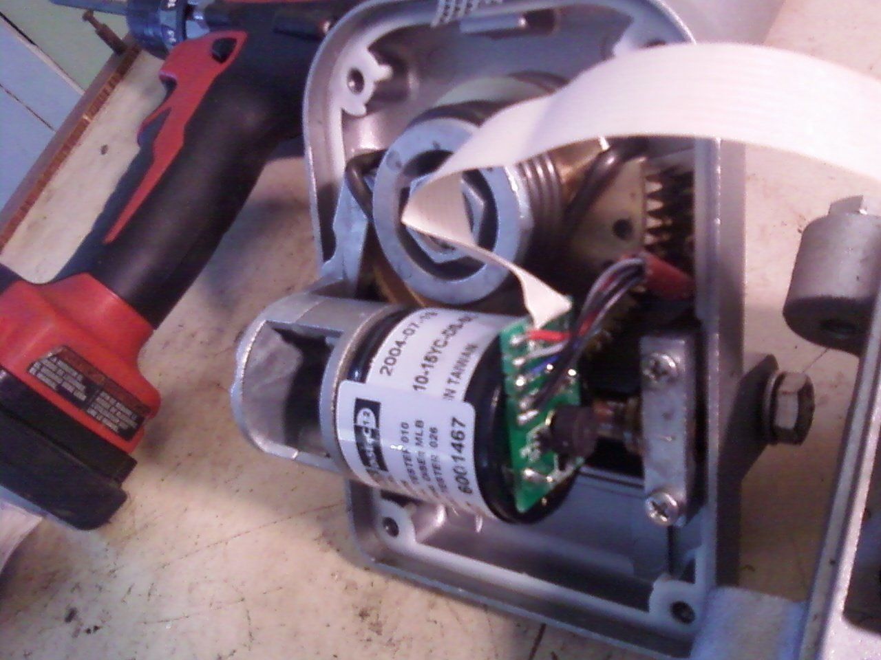

Hi donaldelee. Sorry to hear of your Stab motor failure. I have 2 Stab HH120's ( one in service 24/7 and one spare). Your research will tell you they are great motors. They have good motors/are very quiet/use less current/use all metal gears. What failed on it? Did it just stop working completely one day or fail gradually over time? In my experience the problems were somewhere else and NOT the motor. For example bad cable or switch or connectors or exceeding the motor weight limits. I have heard of rare failures of one or the other of the two circuit boards inside. The warranty on a Stab 120 is 2 YEARS from date of PURCHASE. Is it still under warranty ? If it isn't under warranty then I would suggest taking the bad one apart to see what is broken. It's only four screws and it comes apart. Please note and be CAREFUL when taking it apart not to break the ribbon cable! I have attached some photos the inside of my spare for reference. There isn't much to fail and since it's already broken you have nothing to lose. You should be able to get it working again and have a spare motor.

Thanks for all of the information! You have asked a very good question, and certainly deserves an answer. The motor did not fail! Someone hit it! It bent the arm extending to the LNB [Invacom QPH-031]. I believe it would have lasted for 50 years, had this not happened. My friend took it apart, and tightened the nut. However, it did not last. It will rotate easily. I do believe it can still be rebuilt? ? ?
Thanks!
