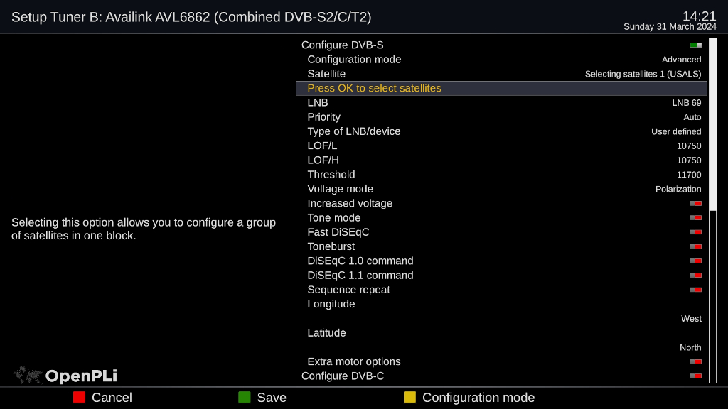

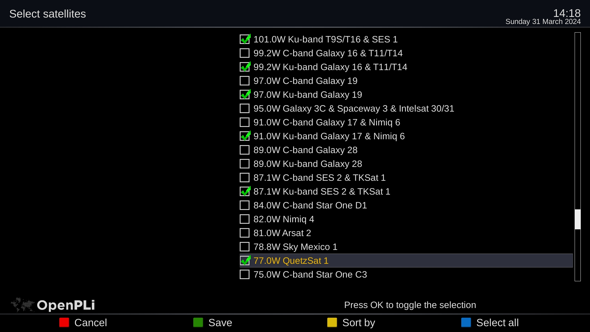

Are your menus similar to the two screenshots I have posted below from my Edision MIO 4K? If so choose the option Selecting satelites 1 (USALS) under Satellite then drop down to Press OK to select satellites and press OK. That should get you to the page in the second screenshot where you can tick all the satellites you want to use with USALS. Don't forget to save when done. Hope this helps! :) P.S. I am using OpenPLI but hopefully your set up screens are similar.

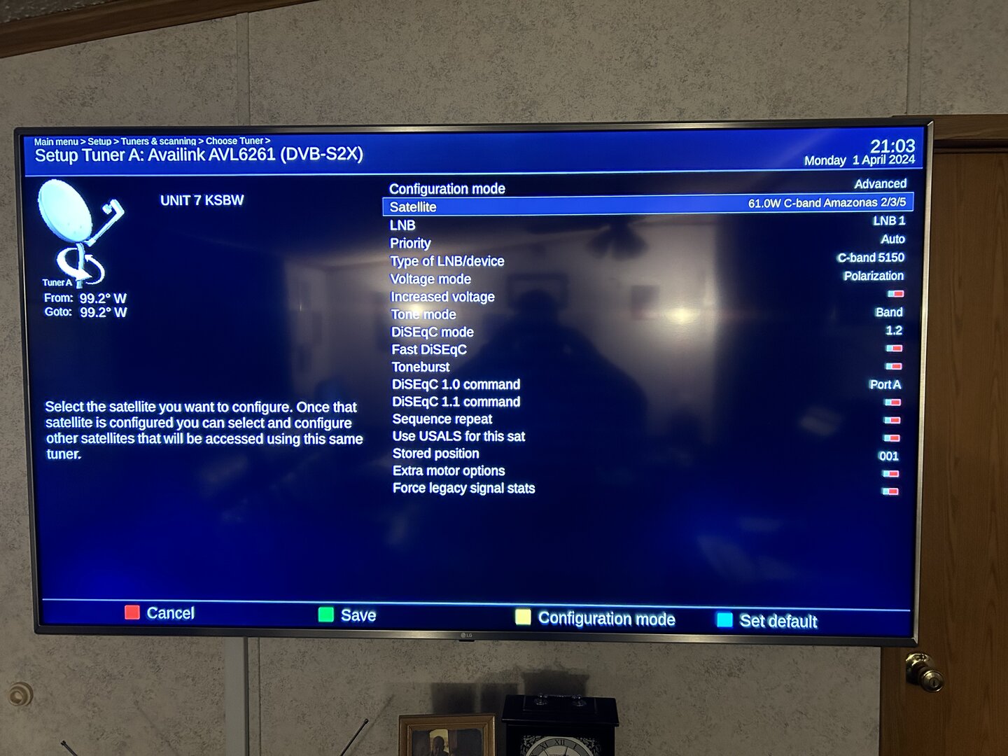

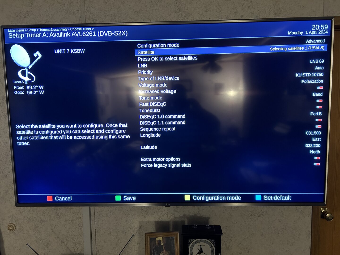

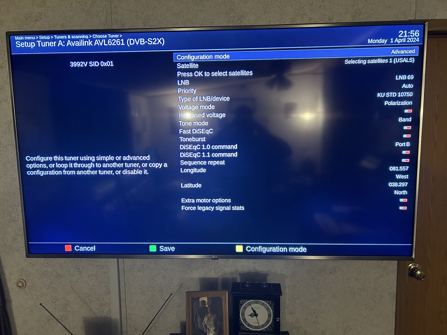

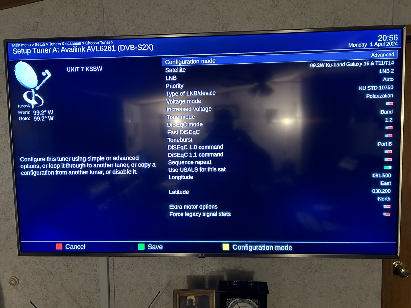

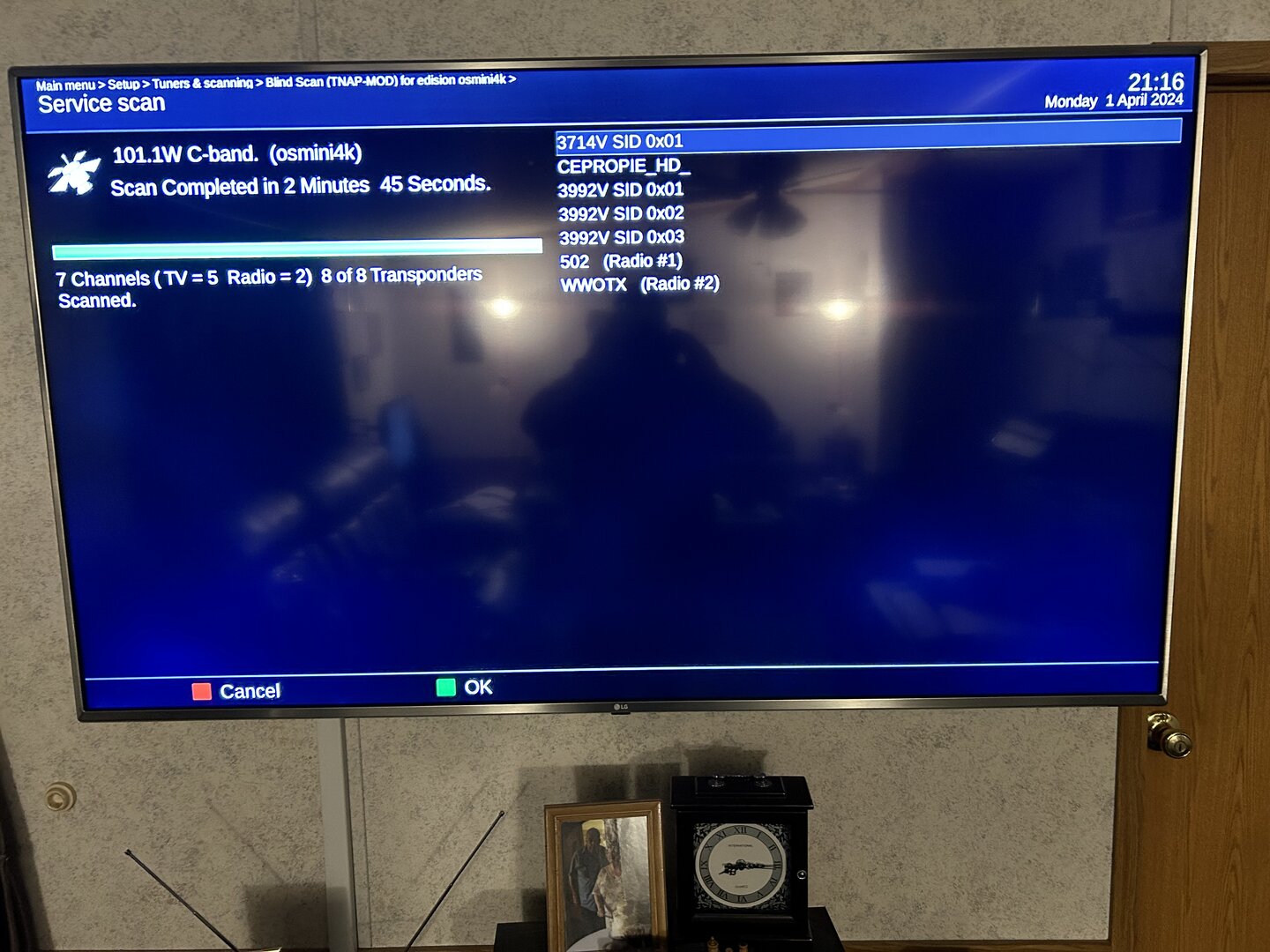

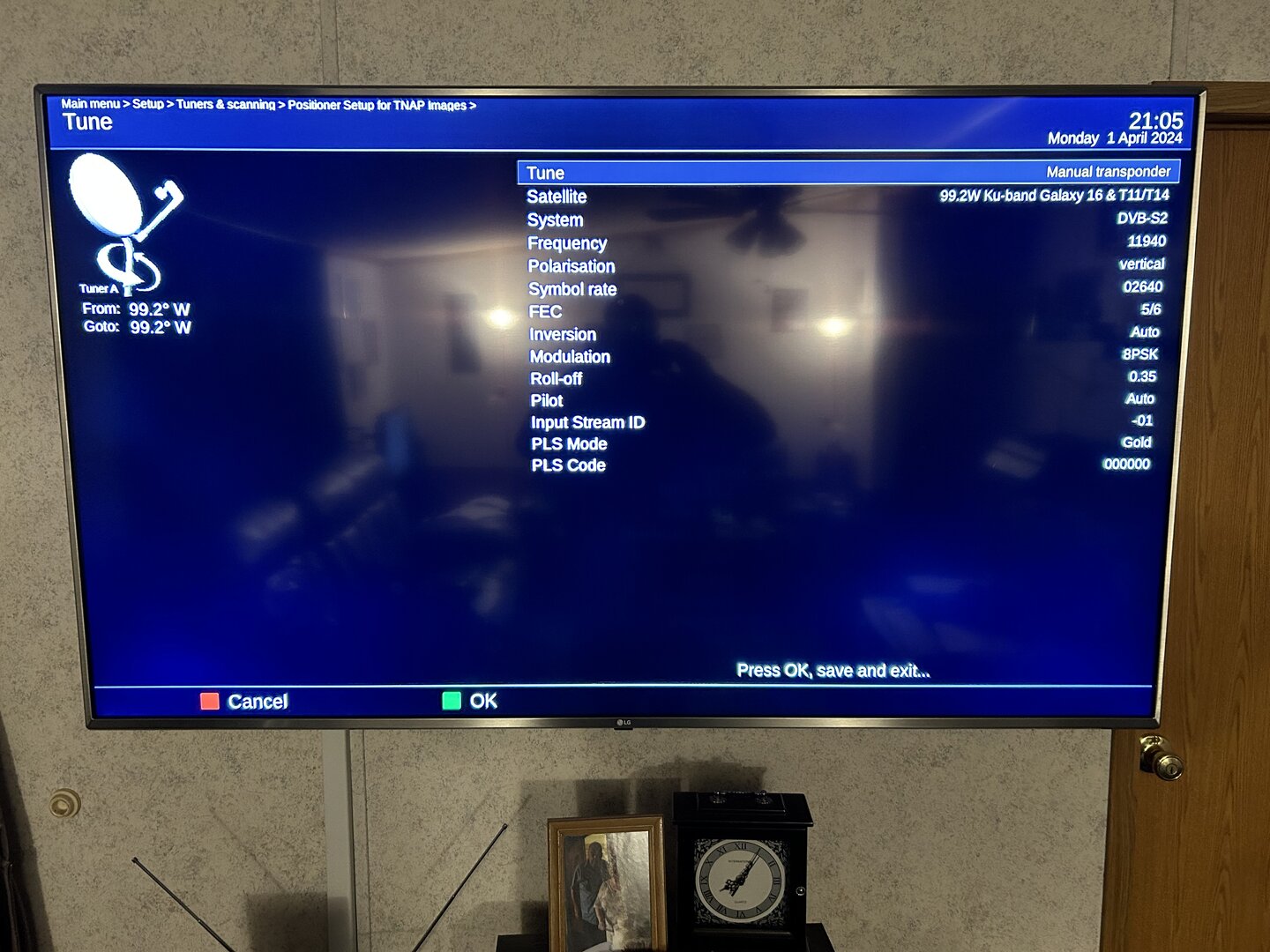

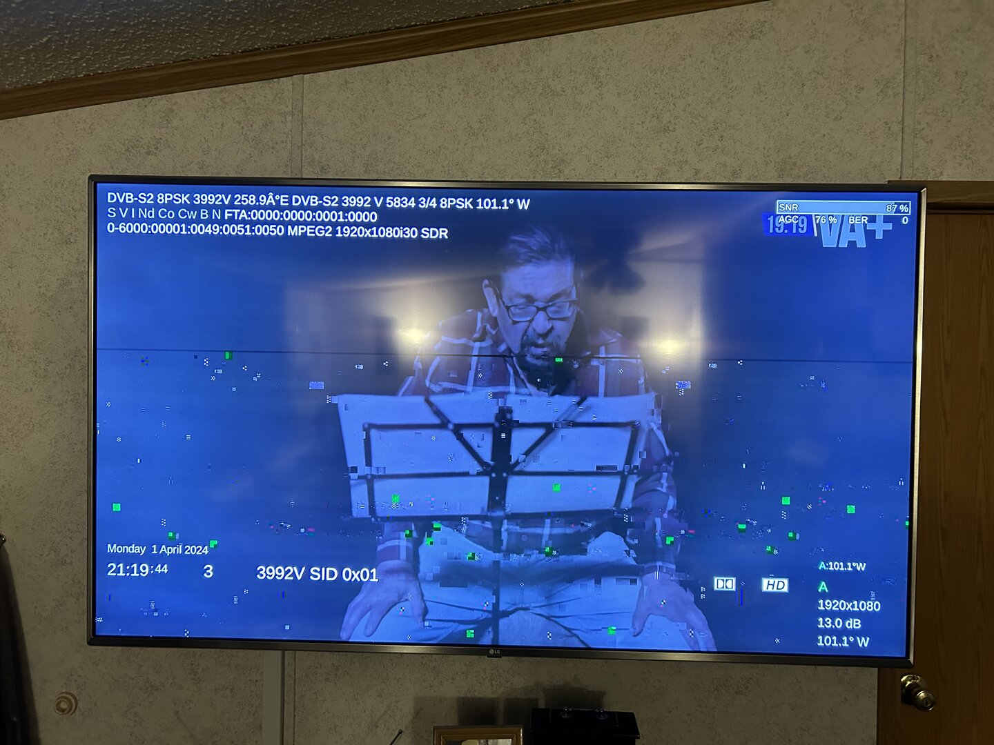

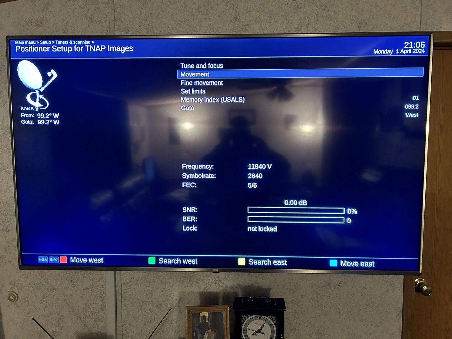

Did you remember to select the Save option after ticking the satellites you want? If yes, then perhaps post up some screenshots of your menu settings so that we can see what is happening.

I saved the settings with the green save button. I'm going to double check all my settings after work today.
